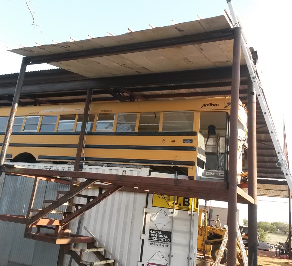

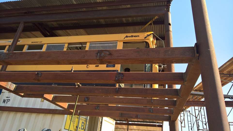

    Well I have the floor joists welded in place for the buss entryway landing will weld in some girts between them to support the eventual floor surface.
    Now probably it may seem a bit extreme to use 4x4 sq tubing for the joists but that was the materials on hand.
    Attachment 36116
    I'm surprised to see that 'dog leg' in the left side support beam. I assume it's because you had 3 longer pieces of square tubing, and why waste a few feet cutting them the same. Good thing you don't have inspectors around, as I believe they never let a beam have a welded joint. Not that I don't believe you have excess structural integrity, both in the strength of materials, and quality welds.
    I have I-beams I've spliced, but only when no one is looking. But I know I have full depth weld penetration, and a limited 2nd floor load.
    Nice progress.

    The reason for the dog leg will become apparent once you see the stair way The dog is not in exactly the spot where I need it so may have to add to it but it was already made and close to what I wanted for the stairway there will also be a wall under the beam so a dog leg will have no effect on structural

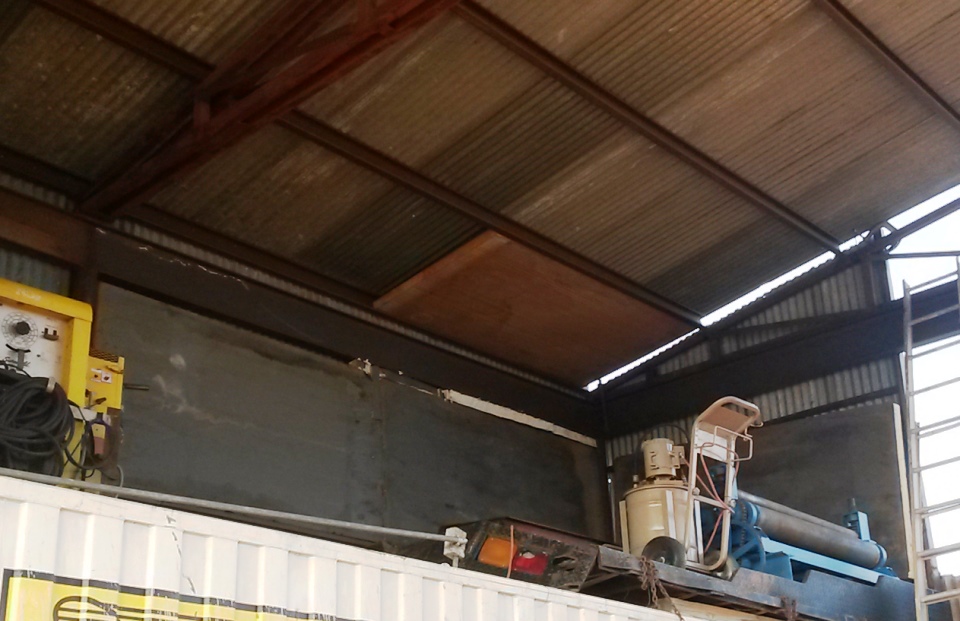

    We used to build lots of beams for pre engineered buildings, the longest we made was 3 Hero beams of 180feet in length it was a boxed beam with a 8 feet tall web 2 inch flange thickness 2 1/2 feet wide with 12" of crown supporting 90 ft long bar joists the building was about 372 feet by 186 feet outside dimensions clear floor with a 6 inch thick foam impregnated lightweight concrete floor on the 2nd floor with a wood surface flor on that,but yeah no dog legs though lots of spliced together steel. What the building was to be used for was an airconditioned indoor footfall practice field with a gymnasium in the 2nd floor yeah people in the middle east have strange ideas
    I have to assume these beams were designed by a structural engineer, and included the strength of a proper weld in the calculation to safety and failure. I just know that a field hacked beam that is welded is not approved unless it is in the drawings for an inspector to validate as built to the PE approved drawing. And there will be many specifications as to ASME welding methods.
    I've dealt with inspectors on my home projects here in Iowa. They are underskilled people hired by the county, and as they 'took the inspector class' they are now experts in all building methods. I see more that the building trades and contractors have paid campaign donations (read as bribes) to the county board of directors to ensure local code ordinances that inhibits DIY from doing any part of construction. I so far have been able to get permits, but that requires putting up with their anal efforts to stop all non hired out work. You are lucky you live in a state that has not taken your right to build from you.

    Yep, I was the senior engineer in the company and had sometimes as many as 30 engineers in most fields on my staff. All card carrying members of KSE (Kuwait Society of Engineers) I even had my own licensed QA&QC for weld testing and welders certifications. Most of our major projects such as that one were overseen b y a consulting firm out of Holland. For a number of years my office our staff and the factory was utilized at night by many undergraduates to study and complete their required projects prior to receiving their diplomas. Even a few post grads would take advantage of our equipment and machines available for projects of their own. In 2018 I received an email from the KSE stating that my name was being dropped from roll for failure to complete a NOC ( no objection consent) since I had retired and was no longer in Kuwait I couldn't see any reason to keep up my dues renewal and hadn't paid since 2013.
