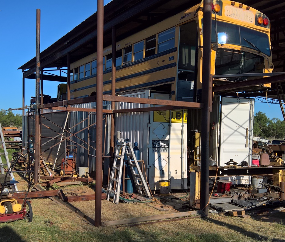

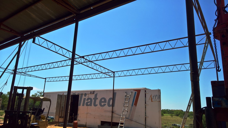

    Fighting 25 to 35 MPH winds from about 7:30 this morning having to straighten the last 2 bar joists and hang them then finish welding the rest of the structure. Plus melting a circuit breaker in the process Don't know but figured it was going bad for a while and the 106° temperature this afternoon probably didn't help.
    But maybe this week end the winds will die down some and I'll get the roof on

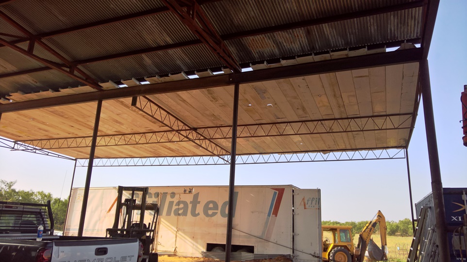

    Well pretty much at the halfway point on the lean to roof now. Would have been finished by now if was using straight new metal. But my standing seem sheets have been used at least twice before and have been transported lots of the sheets have damaged edges which has to be hammered back in shape before the next sheet will interlock over it. plus I only have half enough full length sheets so am using half sheets every other space.
    got nine sections on yesterday then ran low on screws and had a threat of weather so knocked off around 2:30 in the 106° heat to go after screws.
    Got started this morning and by 2:00 again the thunder wind and lightening brought things a halt but now am right at halfway.

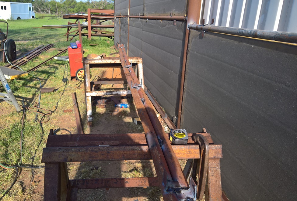

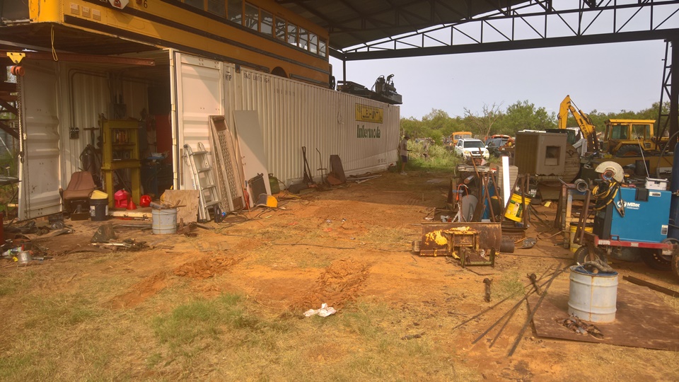

    Hard to believe nearly another month has passed by and it seems that nearly nothing has been done to the shop project.
    Still thinking about a maintenance pit design. could really use one right about now with a low boy trailer in the shop that I am having to hunt down air leaks in the brake system. with a pit I could walk underneath and wave my ultrasonic leak detector over all of the lines valves and fittings and possibly locate the leaks in a short time but as it is crawling around laying flat on my back trying to reach areas nearly inaccessible is a pain not to mention the fact that there is no concrete floor by which a creeper could be utilized compounds an already bad situation. but be that as it may I have done a few things to the shop.
    I've moved a lot of outside equipment and other stuff around and cleared an area that will eventually become a 2nd covered area between 2 dry van trailers which will eventually yield an additional 4000 sq feet but that is a ways down the road yet.
    Getting started insulating the North wall and installing the sheet metal plus welding some structural members for the anti room which will become the rest room and the stairway leading up to the school bus body is slow going as instead of using up my current limited supply of C purlin I opted to utilize some to the 1000s of feet of 2" round purlin tubes I salvaged when I got the rest of the shop materials. I have been welding 2 tubes side by side to make a 2" by 4" weldment then tacking on short lengths of 2x2" angle iron pieces to contain the insulation it is a slow process as I have to straighten some of the tubes as I go along
    Took the first step towards building my shop-wp_20200728_18_57_30_proppi.jpg

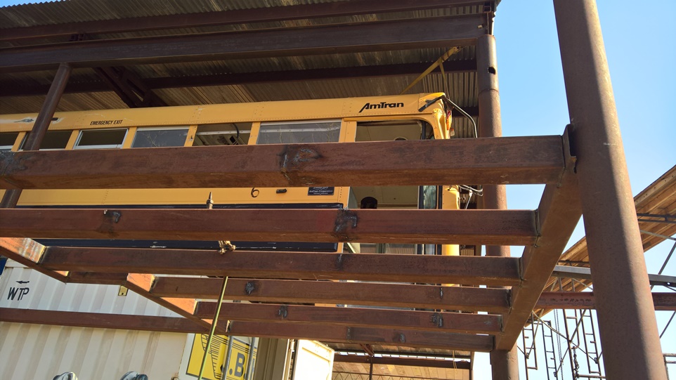

    the Anti room is not any less involved since I am again using up salvaged materials only this time it is 4x4" sq tubing for the frame work which will become the landing to enter the buss and the ceiling over the restroom

    Well I have the floor joists welded in place for the buss entryway landing will weld in some girts between them to support the eventual floor surface.
    Now probably it may seem a bit extreme to use 4x4 sq tubing for the joists but that was the materials on hand.
