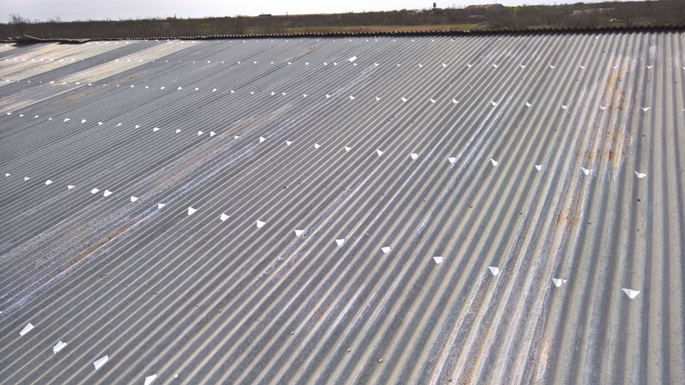

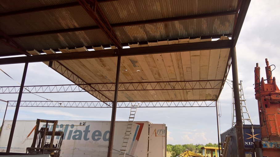

    This morning I couldn't decide if I was going to build a headache rack for a pickup or get up on the roof of the shop. the shop won out for a while at least.
    Anytime one uses reclaimed materials such as sheet metal for the roof there are bound to be a few screw holes which will allow the roof to leak.
    One good way to fill these holes is to use a heavy duty aluminum tape the kind that is used on metal duct work this tape is durable and will last a long time It will last almost forever once I eventually apply paint to the roof
    I used up a roll and a half of the 160 ft long rolls and have one side completed the other side is over 2/3rds complete

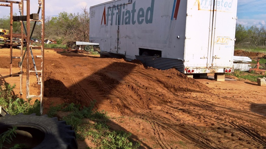

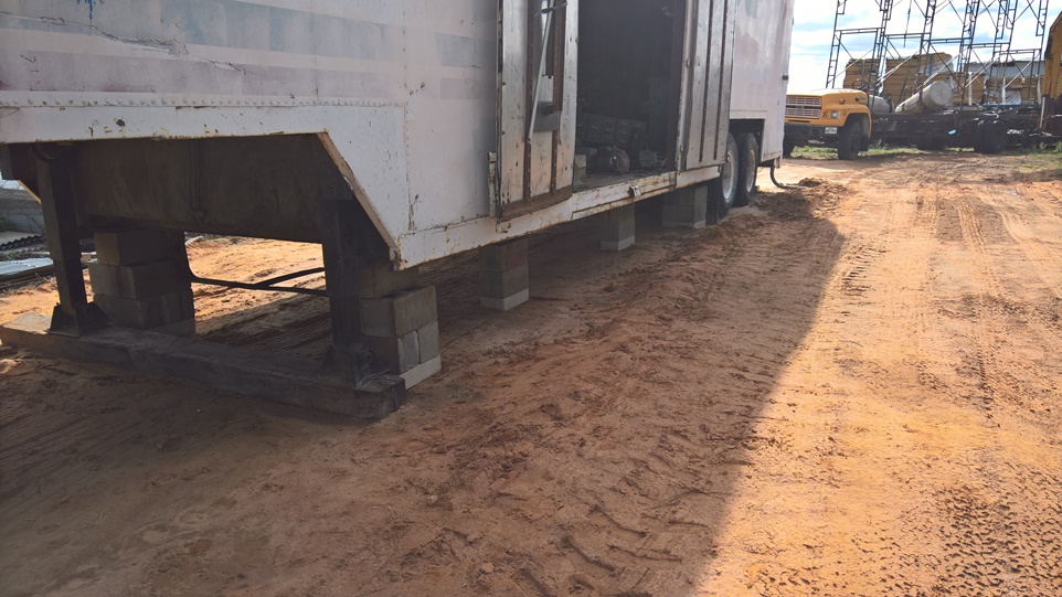

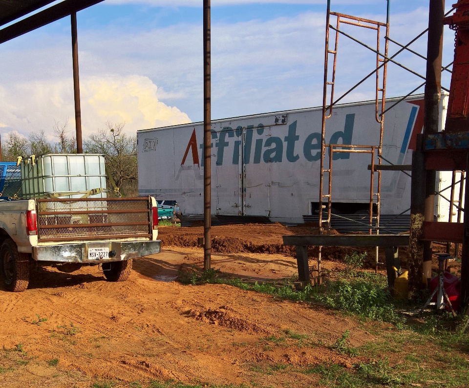

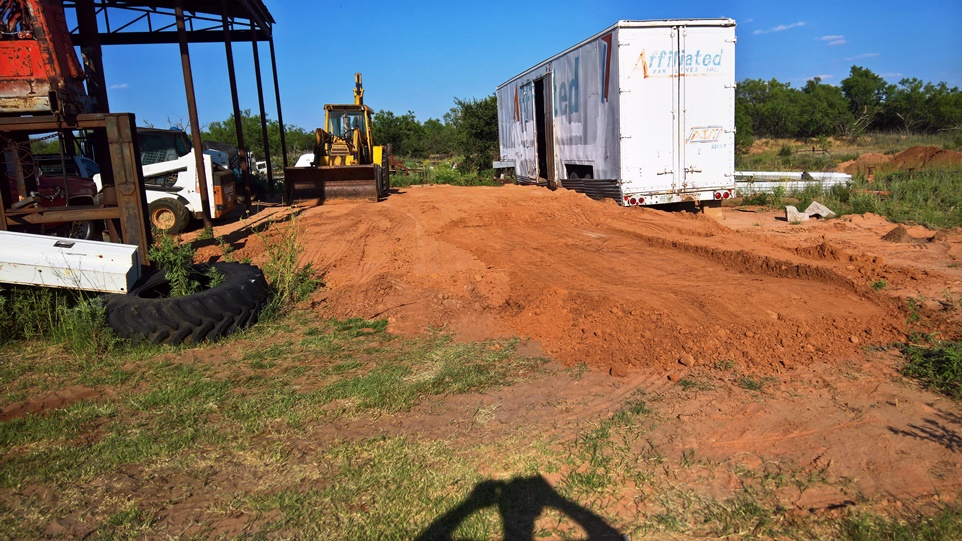

    Finally at long last I made some time for the shop actually I have been moving a little fill clay all along but no real noticeable progress in my mind anyway.
    Oh I blocked and leveled the machine shop trailer hauled maybe 50 to 60 bucket loads of fill things like that. but still no construction other than dirt work
    I decided when I woke up this morning that if a container is going to arrive in a couple of weeks I needed to get back to focusing on the shop instead of rebuilding transmissions building a forge that I have only 2/3rd done rebuilding my wife's mower deck renovating a bathroom and all of the varied other distractions.
    So first I decided that I should finish taping the holes in the roof and get that out of my way so I could remove the last tower of scaffolding.
    that done scaffolding removed I mined up some more fill then hauled about 25 loader buckets full and 10 bobcat buckets full then I moved the buss scaffold to the West end wall of the shop so I can hang some sheet metal
    How it looked in April after blocking and leveling
    after 50 or 60 bucket loads of fill
    More fill
    Todays fill
    This would make a pretty good deterrent to anyone wanting to take something
    Eventually all of the grass area you see in the last 2 pictures will have to be excavated and filled I will have to excavate about a foot deep then add back in 18 to 30 inches of fill then someday there will have to be a 30 cubic yard apron poured there

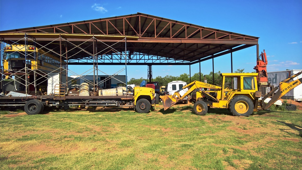

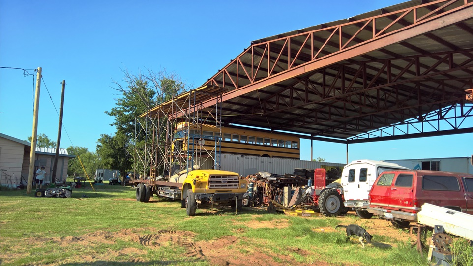

    More fill and some sheet metal on the West end
