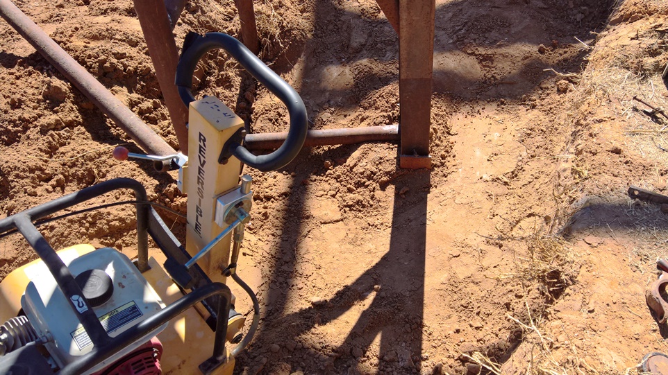

    Fill in and packed then packed some more then more fill and packed again and again until I had the hole filled right up to where the last subterranean brace was to be welded in now all bracing is in I finished filling the hole but haven't packet it down yet as my plate packer began acting up there is probably trash in the carb as ther is no inline filter on the machine
    Took the first step towards building my shop-wp_20200216_13_13_29_pronbv.jpg
    No explanation needed here we all know what this picture means

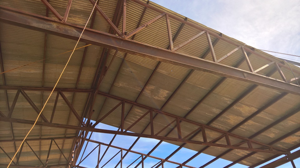

    The morning went well I now have 9 sheets up and have completely used up 1ne pile of sheet metal now I have to dig a lot of shorter sheets off of another stack before I can lift anymore to the roof
    Took the first step towards building my shop-wp_20200217_13_17_05_provbn.jpg

    From now on it will be piece meal for the roof the longest sheets I have left are under 25 feet long This would be just about right as the old building I tore down was 68 feet by 120 feet a large part of the roof had caved in due to Ice and snow there was only about 100 feet of one side that the sheet metal was not bent up due to the collapse of the roof I have used 22 sheets on the north side and 9 on the south so that would just about account for the full length sheets I had.
    I managed to get 2 sheets down to make a full length run and 2 more for a partial before the cold front started to come in kicking the wind up to some 25 MPH gusts maybe the wind will be more favorable tomorrow.
    Took the first step towards building my shop-wp_20200217_15_40_16_provbn.jpg
