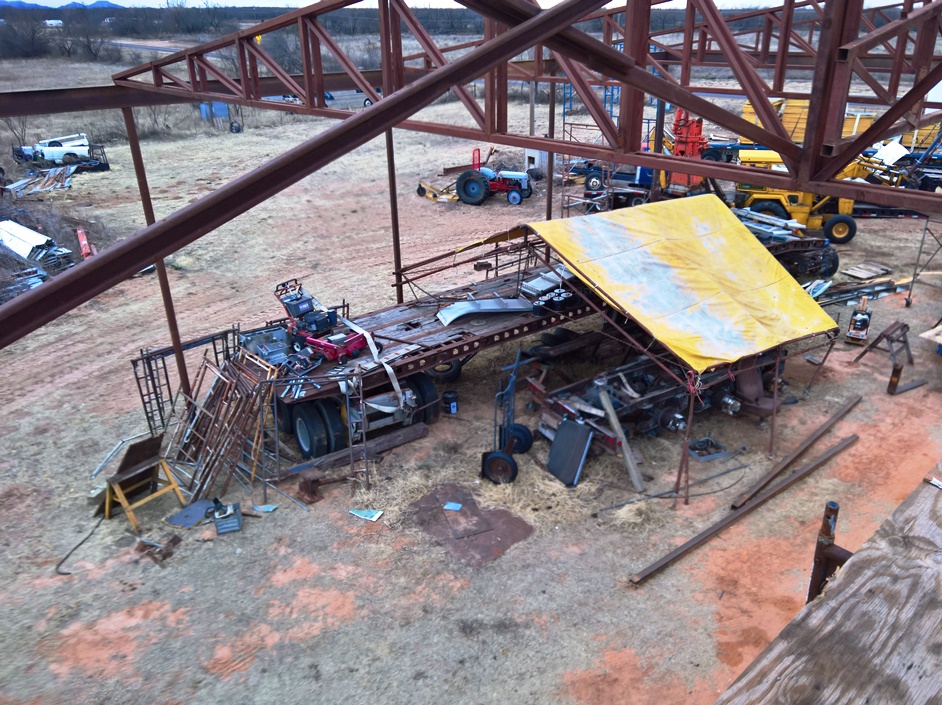

    For the last couple of days it had been windy so nothing much done to the building I did manage to get 2 more purlin welded in place but I have a truck and trailer in for servicing and to do some other repairs. The sort of thing that gets in the way of progress but at the same time helps to pay for future materials to be used on the building plus he came hauling a Dodge pickup he had only recently had a transmission replaced in but the shop where it was done had not bothered to pull the torque converter off and place it on the front of the transmission before mounting the transmission. When trying to stab an automatic in this fashion you may think you are saving yourself some time but the couple minutes to pull the converter and guide it onto the input shaft and insure that everything aligns up correctly almost always results in damaging the pump seal or cracks the housing. the ruck runs and moves just fine but it pours ATF out of the front seal.
    They shop had kept his truck for months and months continuing to shove it aside until finally he had, had enough of their excuses, loaded it up and brought it to me.
    If I had a lift or a pit this would only be an hour's job
    Some reasons why I need to get finished with the shop
    some of these are for restore and some to repair for sale
    This hanger queen needs to go I need to get it sand blasted painted and put back together
    He and I have a lot of money tied up in it and still need to dump a few thou more so we can either put it to work or rent it out

    I'm confused, on this 3rd photo, that old trailer with the sideways casters, is that the "hanger queen", or did you mean something else.
    At least your not looking at white cold stuff everywhere.
  10. #110
    11,716
    2,228
    Yep it has been sitting there going on 8 months now I have about $3,500.00 worth of air springs air lines air valves brakes bearings seals slack adjusters and misc. parts for it waiting on more parts, sand blasting painting and rebuilding the hyd cylinders but I may have to had the cylinder shafts ground and re chromed
    I have trailer sitting on a pair of tandems pulled from a couple dry vans that way instead of having to drag the tri axle group out from under it I simply rolled it to the side
    I now officially have half of the purlin installed so I can begin sheeting the roof on half of the building then I will roll the Kaylin Siebert trailer up next to the container out of my way so I can continue with the other half of the roof.
