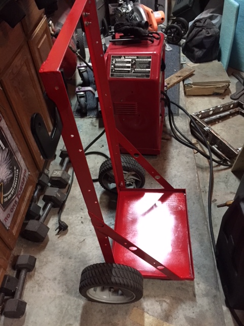

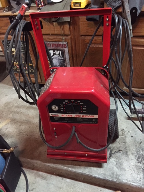

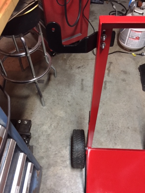

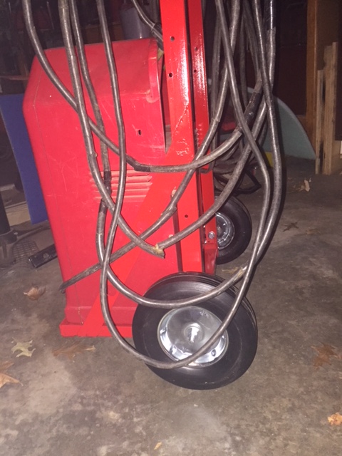

    I wanted to get some practice on welding and wanted something useful at the same time. I just picket up this welder and wanted a dolly to be able to move it around easier. I built this cart out of a bed frame, part of a squat rack and the hooks were from a treadmill. I had plastic wheels on it to start, but they wouldn't hold up to the weight, so I put steel wheels on it. I was more of a grinder than a welder on this project, but at least towards the end my welds were looking a lot better. I would also appreciate some advice/tips for stick welding because I want to start on that. I built this with a mig/flux welder.

    Nice work! I've wanted to build a similar cart for my tombstone, haven't had time yet.... It would be nice to have a better method to hang the cables....

    Thanks for the tip. I also need to up the amps. I wasn't hot enough when I started and it was always sticking. I need to get new leads. These are cracked all down the wire. I do not want to electrocute myself. I am enjoying just playing around with it for now. I will always accept tips to get better, but it is fun learning at my own pace. I will be running 6011 rods.
