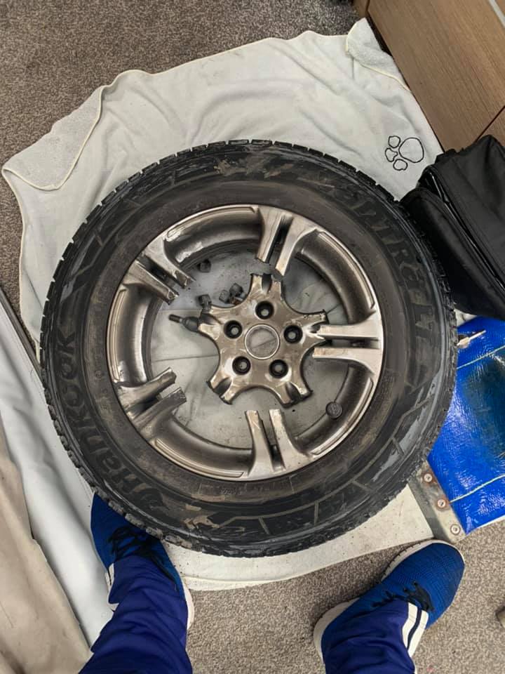

    Good job, much like the old air clamp/bead breaker manual tyre changers I was trained to use 40+ years ago. Not good for alloy wheels though, as the clamping forces can damage the wheel centre, initial cracking may not be visible until total failure, as per attached photo, that's why most centre pull down clamp machines were scrapped for 'rim' hold machines. Tire changer - video-adria-wheel.jpg
