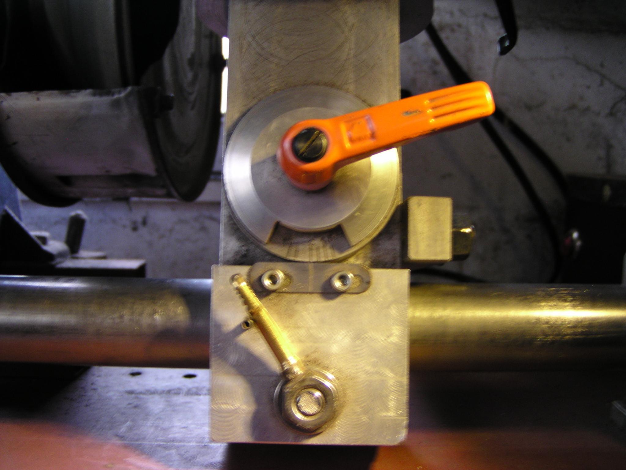

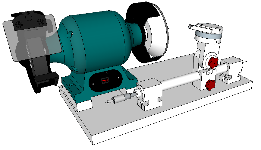

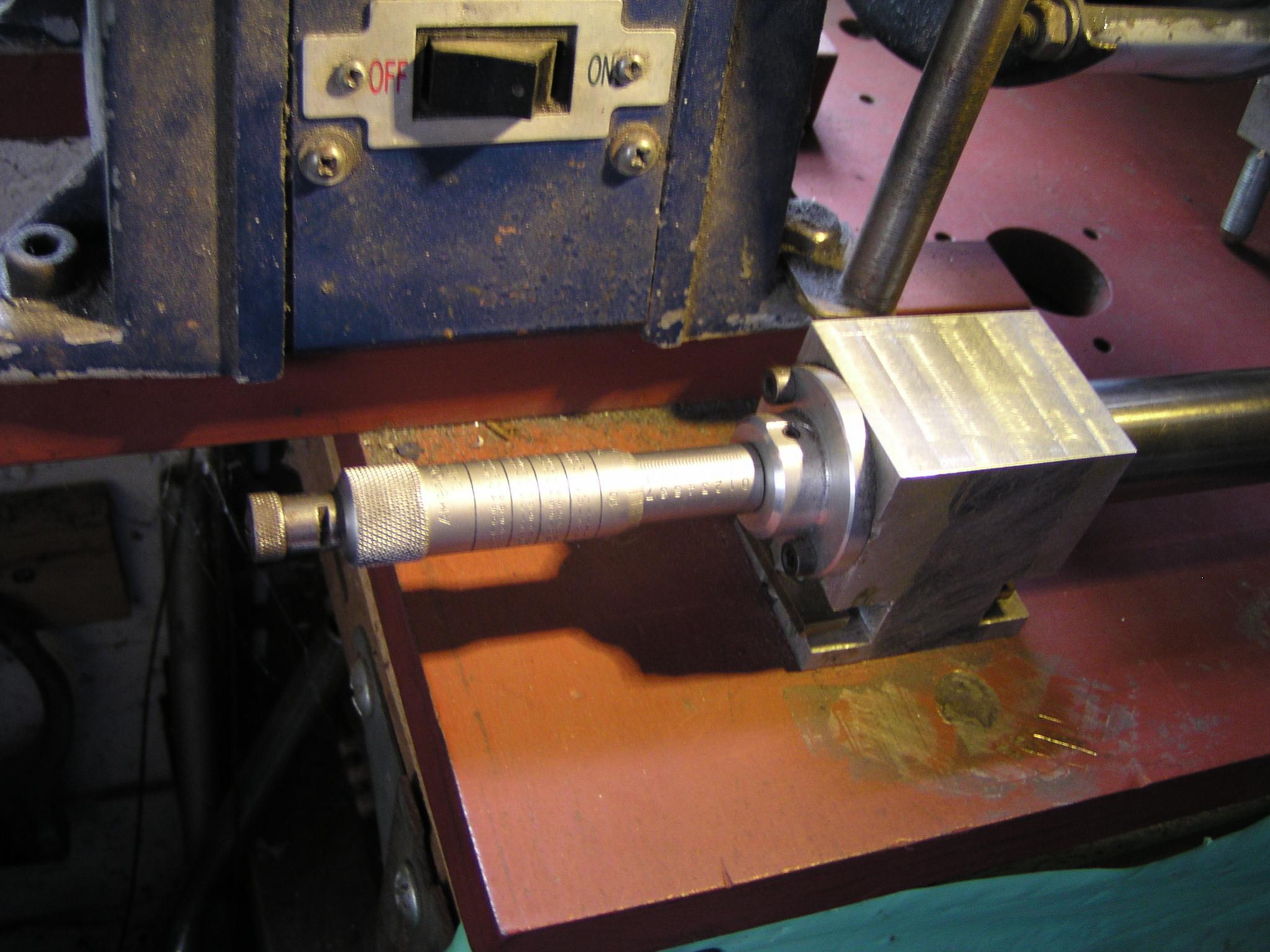

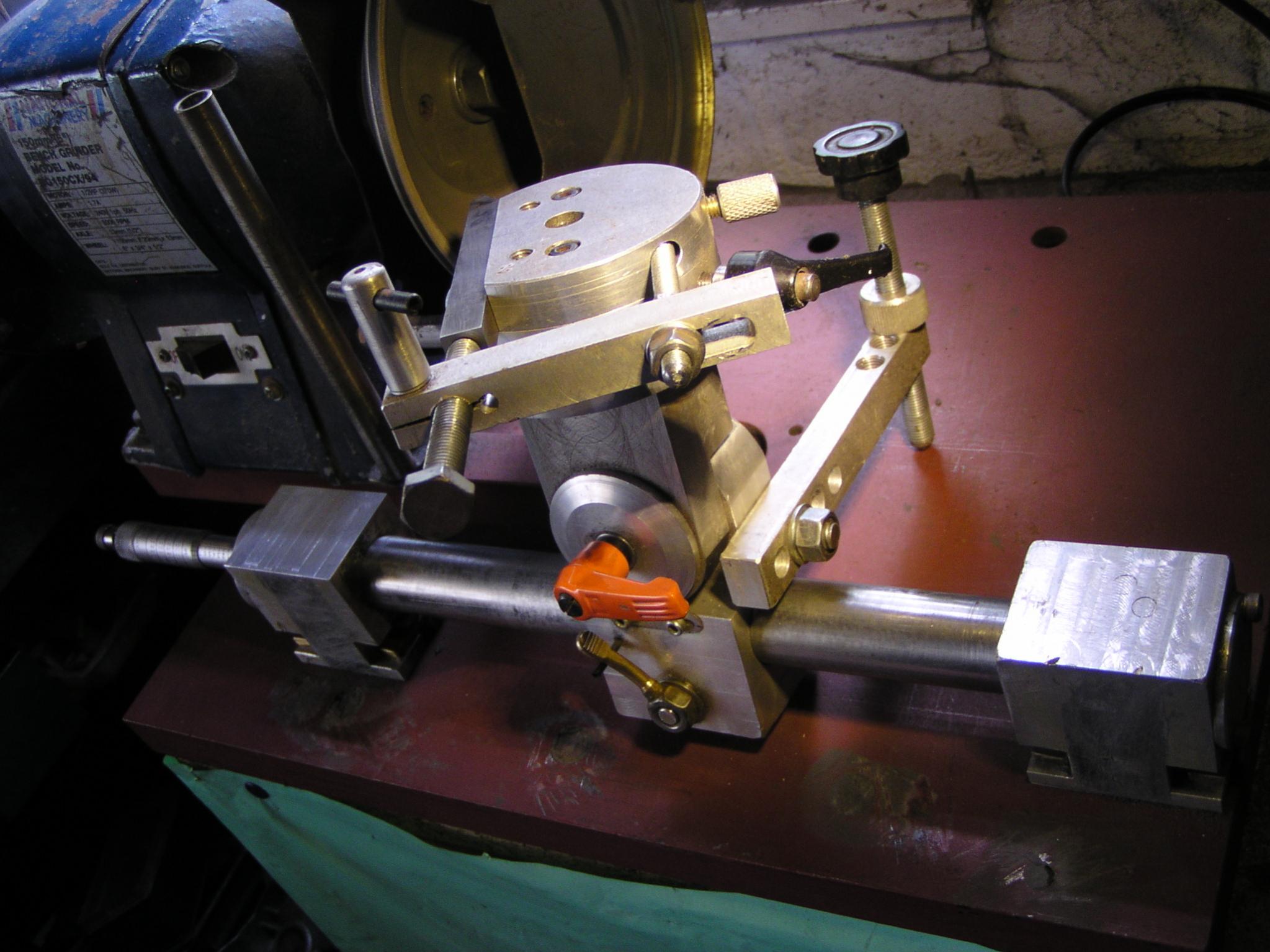

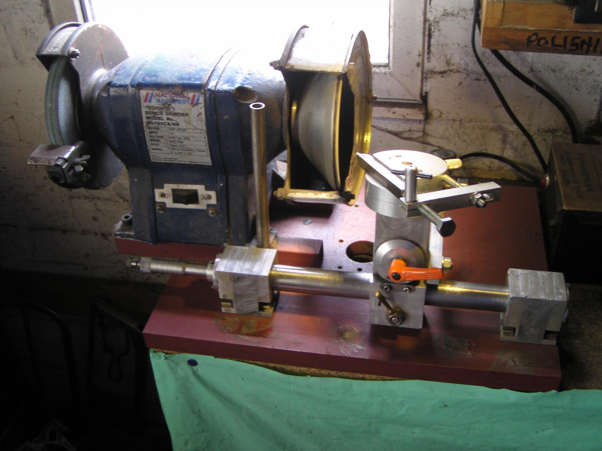

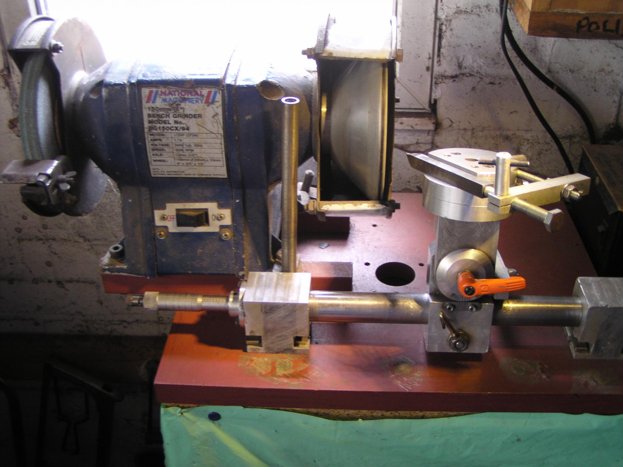

    After using a Tiplap tool sharpener for many years I really missed this excellent machine when I retired, particularly when an accurate screw cutting or acme tool bit was needed.
    Buying one was to expensive for my now occasional use but making something similar out of the scrap box seemed feasible.
    I already had a spare six inch bench grinder and a steel baseplate to mount it all on (I am sure a decent wood base would be ok).

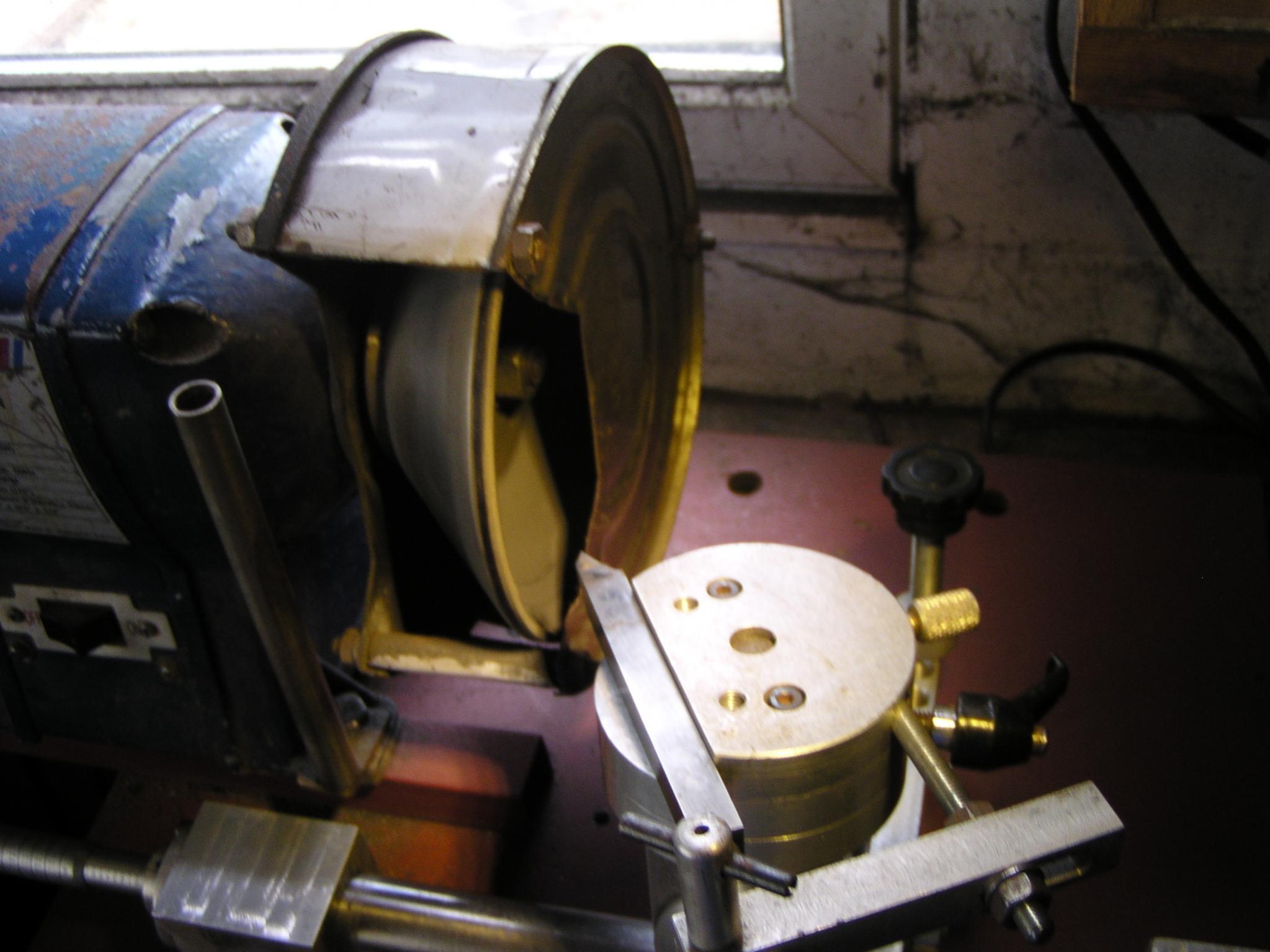

    A cupped diamond wheel is used and I was fortunate in finding a damaged on for a song, a one inch chunk had been knocked of the rim and this was repaired with plastic metal and has been used for many years now.
    The only accuracy needed is the squareness of the bar in relation to the wheel, this is easily achieved by placing a flat bar or disc on the wheel and using a DTI in the tool holder until squareness is obtained at which point the end blocks are bolted down.
    Sizes are flexible to suit your needs , mine uses a 1 inch bar an easy fit in the alloy blocks.
    In use I rarely clamp the tool being ground as thumb pressure alone seems to work combined with the end stop, It also makes it easy to remove the tool for inspection and replace it exactly where it was for further grinding. It works very well in sharpening carbide tools and tips.
    This is of course a finishing process keeping the land to about .050 max after the blank is roughed out using a grit wheel.
    I have also sharpened end mills and twist drills (4 facet method) with a few simple fixtures.
    Attachment 12734Attachment 12735Attachment 12736Attachment 12733Attachment 12737Attachment 12732Attachment 12730Attachment 12731

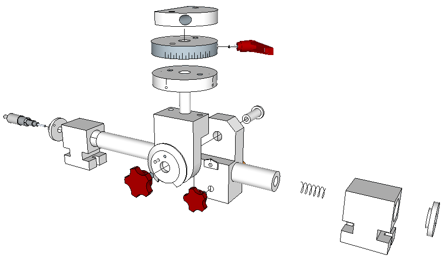

    I just found this post and many thanks for making it. Is there any way of obtaining prints of some type for this? I would really appreciate any help you might have. Thanks Hoss

    I don’t know where to get drawings for this cutter grinder attachment, but there are numerous similar bench grinder attachment plans available. Maybe Google “Tinker Tool and Cutter Grinder”

    The only working drawings I have for this are in Sketchup format, they are to scale and can be dimensioned from within if you are a user of Sketchup. These were drawn retrospectively for the post as I do not generally make drawings and work on the fly with what I can find and good old pencil and paper. I could send a zip file if it would be of use to you (too large to post here). I have since made a new top block incorporating an ER20 mounting with a click indexer for end mill and drill sharpening.

    Seems the Tinker T&C grinder was a popular feature in the "Home Shop Machinist" publication; so much that castings were available by order.

    I was particularly interested to read about salvaging a cupped grinding wheel using plastic metal. What limits would be placed on a repair like this? I note that it was a diamond lapping plate, not an ordinary grit wheel.
