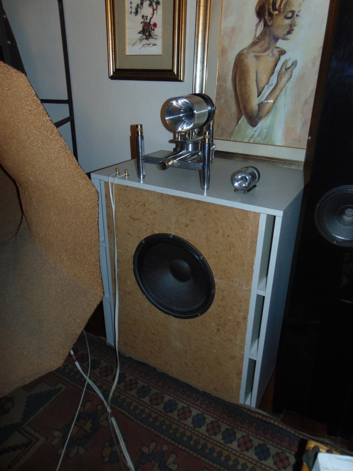

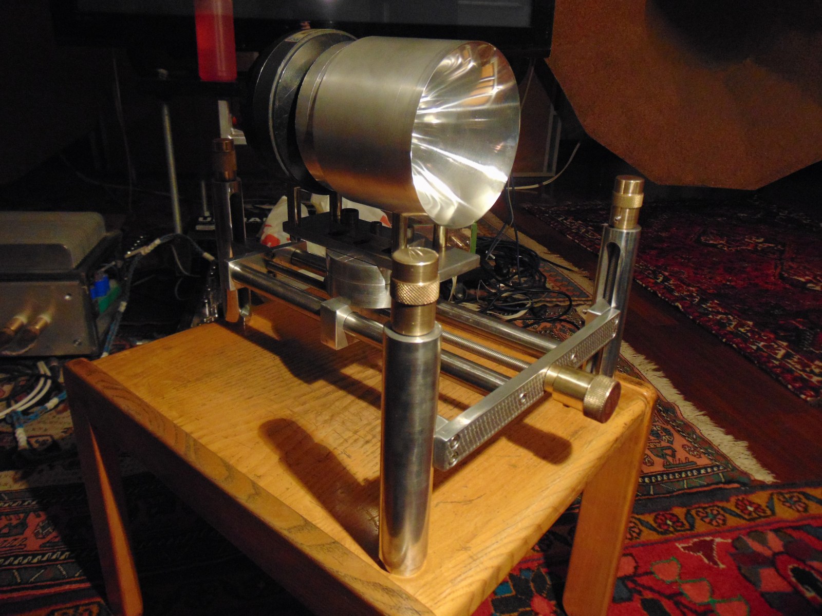

    Hi all!
    I just finished my time alignment tool.
    I built this heavy stand in order to keep in position 1" and 2" compression driver unit with dedicated horn. Basically it can be used with every midrange unit.
    The purpose of this tool is to have an accurate control over time alignment and spatial position of the driver. It could be used on every large size bass speaker.
    My purpose was to have the following settings:
    - long stroke time alignment (delay)
    - full adjustable feet, height, camber
    - rotating tower
    - translating slide left right.
    Coupling: cork discs between driver unit and brass. Steel balls from a bearing, with dedicated brass support.
    Materials: Brass, soft aluminum, 7075, stainless threaded bars M10. All screws stainless. I decided engine turning for the front plate.
    I will engrave in the future vernier style graduated scale. A next improvement could be a remote controlled unit, with motors instead of knobs.
    I'm traditionalist, I prefer manual action mechanisms.
    I upload a couple of pictures of the unit, I don't know why but I can't use the automatic loader, I have to put one picture each time.
    That's the link of my FB album, with full construction if someone is interested.
    https://www.facebook.com/stefano.ran...1234807&type=3

    That's one fine tramming cradle. Is a bubble somewhere to regulate level, is tuning focused on the speaker alone? While the pic is a little oblique the engine turning is a nice touch. If this was in a shop window, no one would see homemade.

    I have tubes with colored liquids, I'm undecided about fixing on the rest or use just as bubble level for the first implementation. I have also to print a label for the rotating turret, I'm still not able to engrave good lines, it's better to not destroy the surface
    The best tuning options are:
    - total height: useful to raise the distance between woofer and mid unit, I found interesting modifying this parameter to increase the voice and scene height.
    -rotation and inclination useful above all with horns, aiming the listening position.
    other minor adjustments are good in order to find the best position of the driver
    -time alignment setting needs more way to be done, like a woofer or tweeter. The purpose is to adjust the distance between units. it helps accuracy and response. A pretty useful way is also to use a sound processor with active crossover, Dcx2496 for example has time alignment auto setting with microphone, pretty accurate also considering that's a PA unit.
    I tried to give it a good finishing and above all, a good weight and stability.

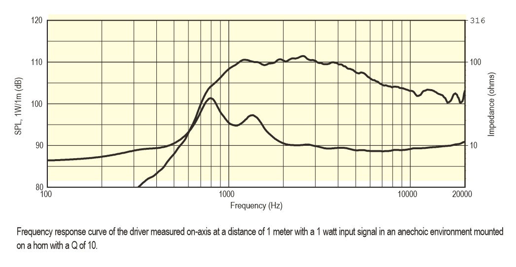

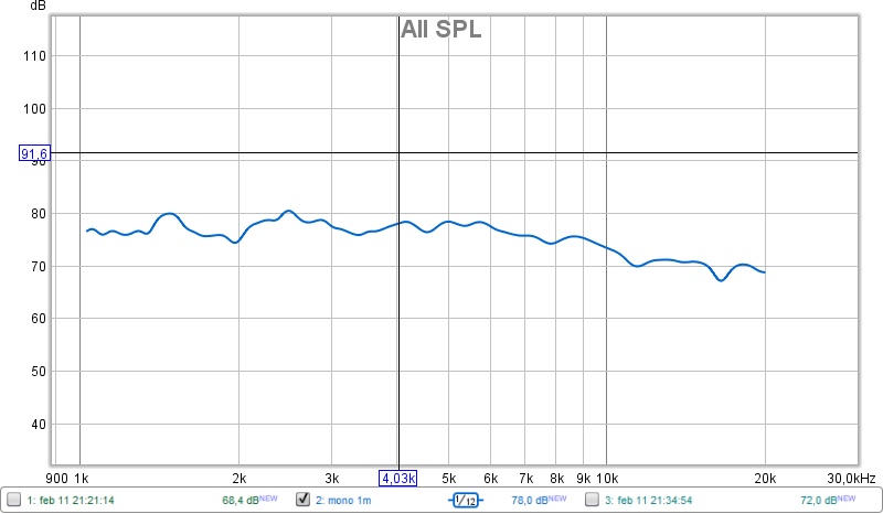

    I made also the horn with lathe. I tried a fast measurement without setting the scale, the result is pretty impressive compared to original data from RCF brand (first picture). The second picture is the response at 1m, from 1 to 20khz. Considering the size of the diaphragm 1,75" with 1" exit I think it's a great result to have the possibility to use the driver up to 10khz with only a little equalization. With original PA horn it would be terrible for hi fi use.
    The sound is awesome, acurate, fast, and not tiring at all. I tried a fast 2 way active with my 15" onken bass enclosures. I'm not a fan of 2 ways, too many compromises, in my opinion a large 15" should operate from 20 to max 500hz, I prefer cut from 150 to 250hz. A fullrange or a true midrange unit gives better performance in listening ina a critical area of fq. But that's only my taste
