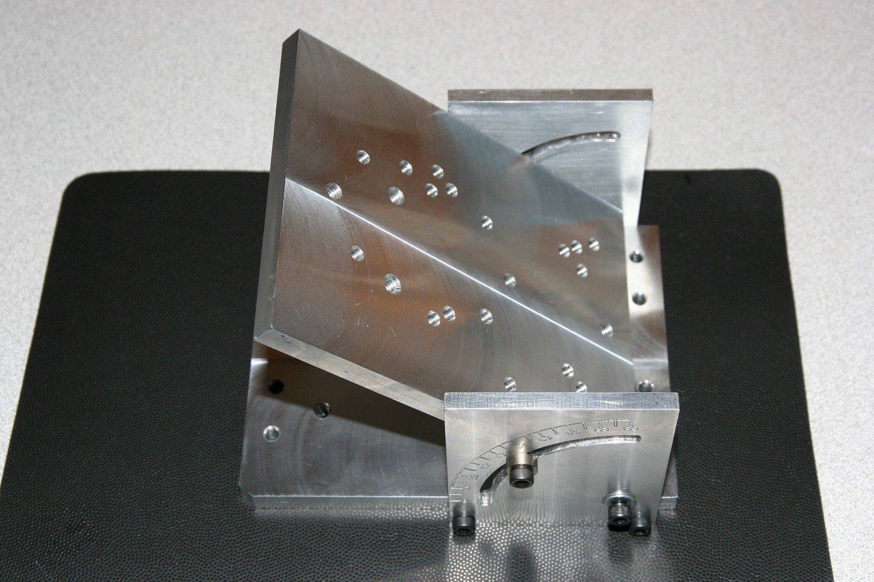

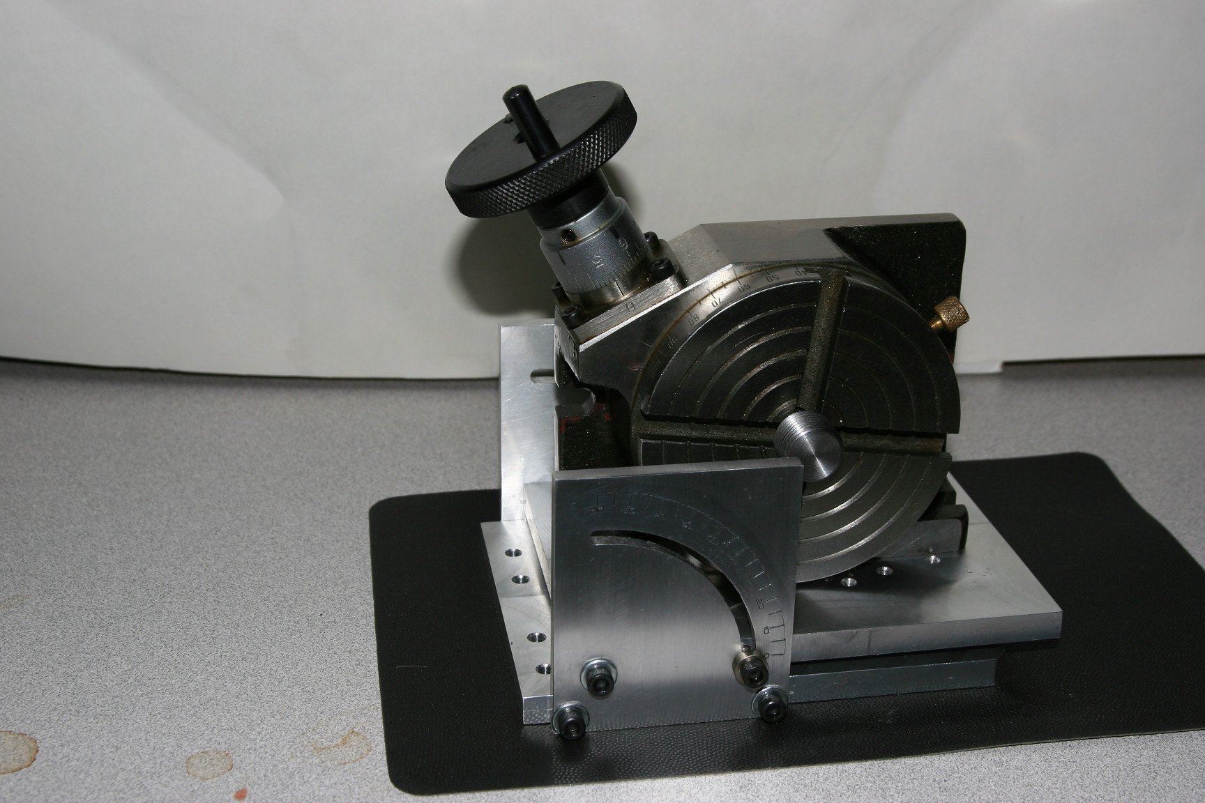

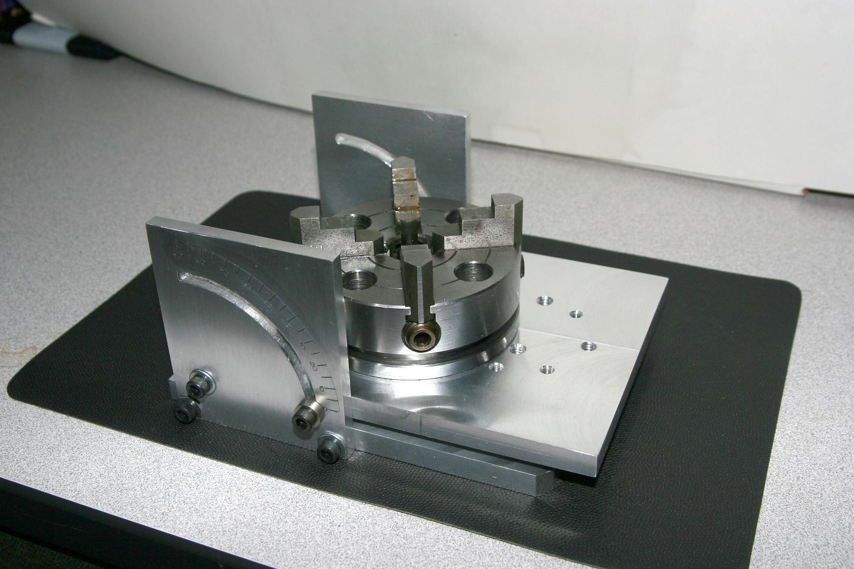

    Tilting Angle Table for the small machine.

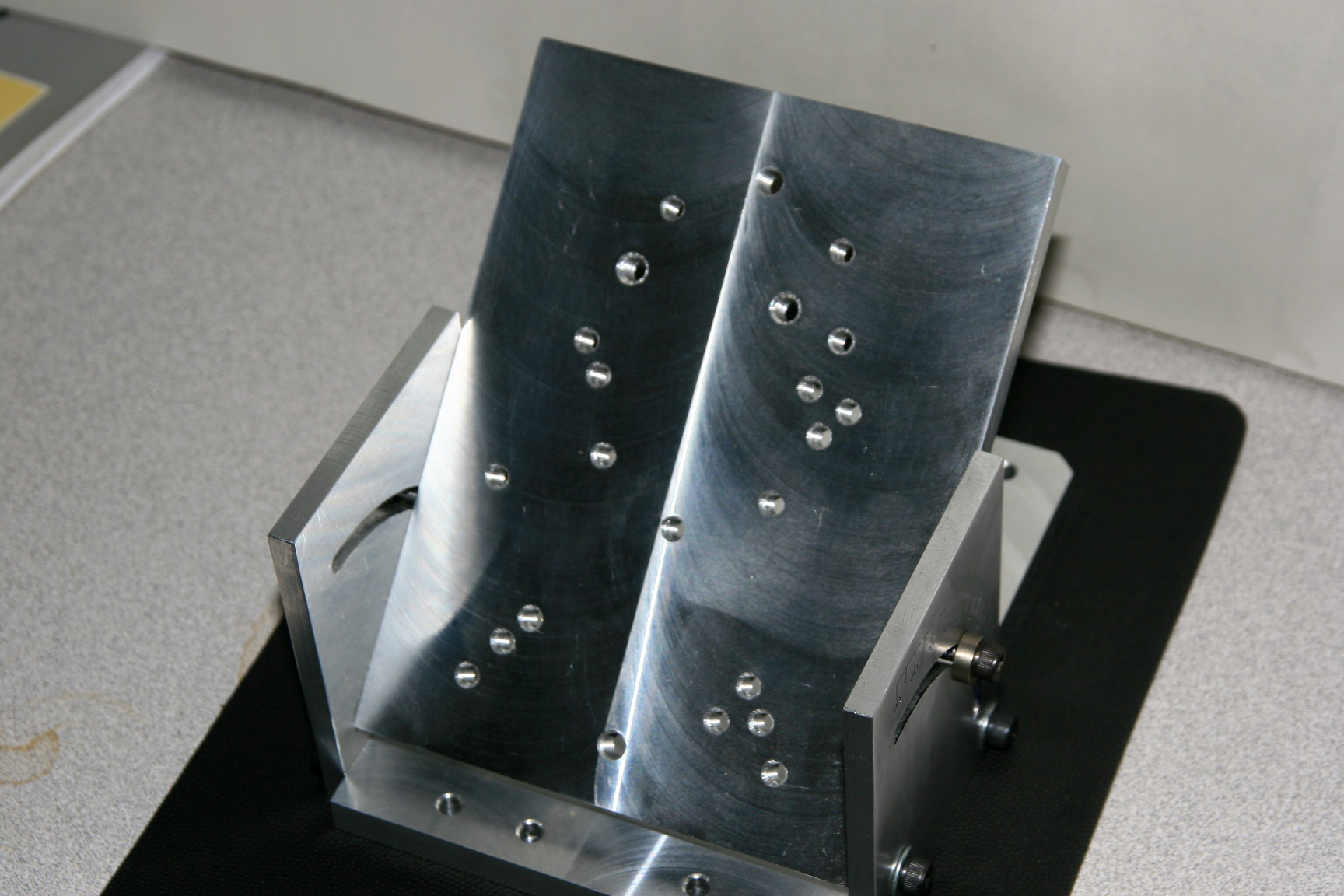

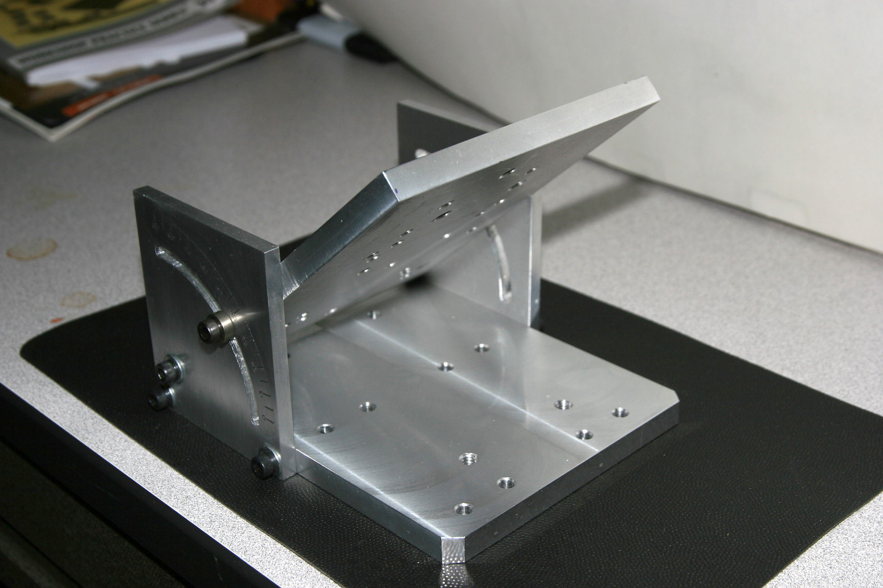

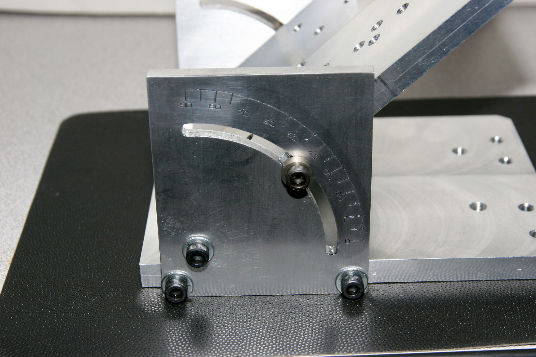

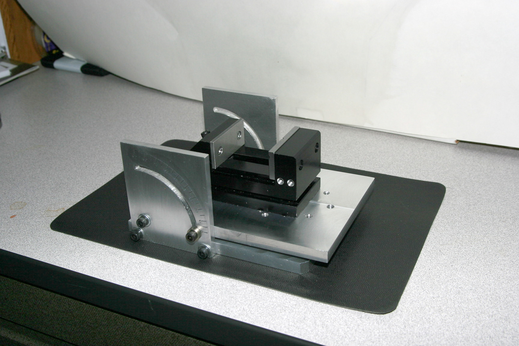

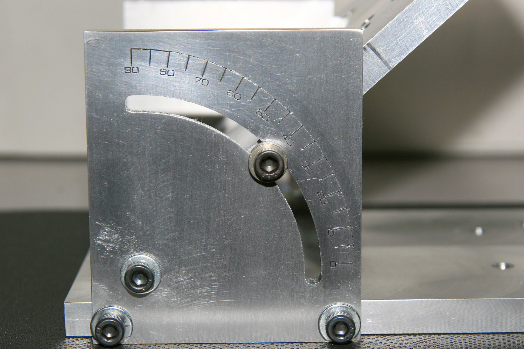

    I built a large one a while back and it is a bit large for my mini mill and definitely too large for the Sherline.
    http://www.homemadetools.net/forum/a...6748#post66894
    So I built a small one using 3/8" aluminum for the base and table and 1/4" aluminum for the side plates.
    I have drilled holes in the table to match the tooling that I may need to mount. Most holes are 10-32 tapped.

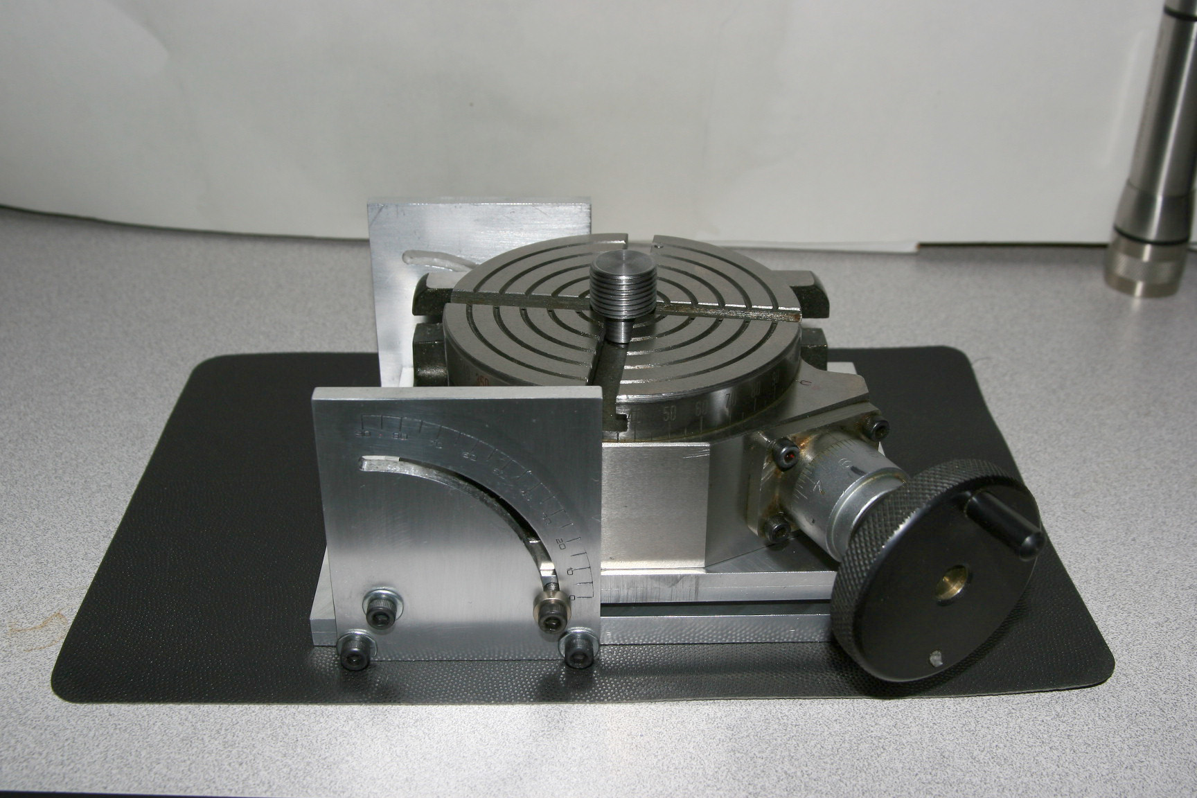

    There are a couple of 1/4-20. Two for the 4" rotary table (Import) and two more to secure the table in the milling
    vise so I could mill the table square.

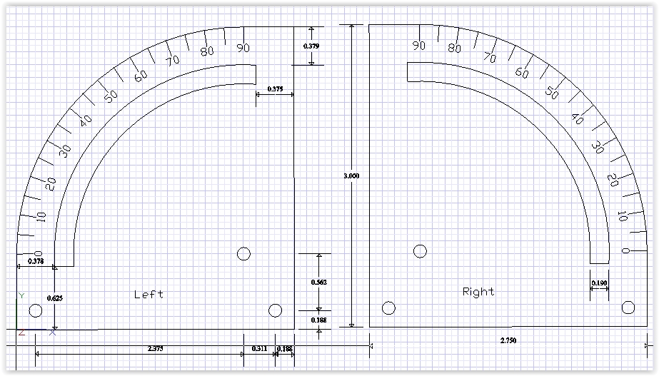

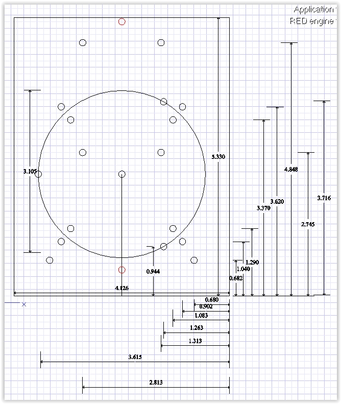

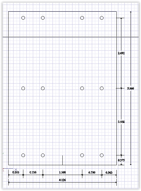

    Prints are included with all dimensions except the holes in the base that are used to fasten the side plates to it.
    There are two 10-32 holes at the bottom of the side plates for fixing to the edge that are drilled and tapped on the center of the base.
    Two more 10-32 holes in the edge of the table for the pivot and angle slot.

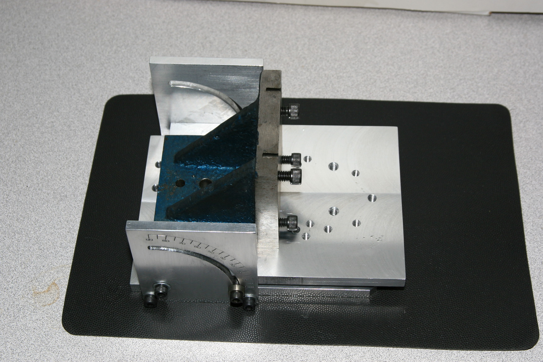

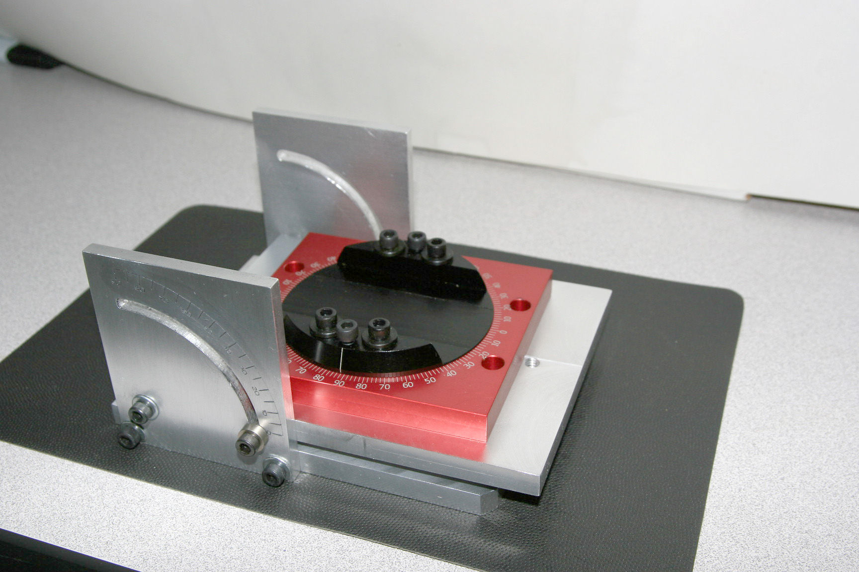

    Pictures show the alignment of the tilting table to the base or bottom plate.
    If you are building one make sure that the holes in the table will work for your tooling. I have left a lot of space on mine
    so it can be custom drilled and tapped in the future.
    Cheers, JR

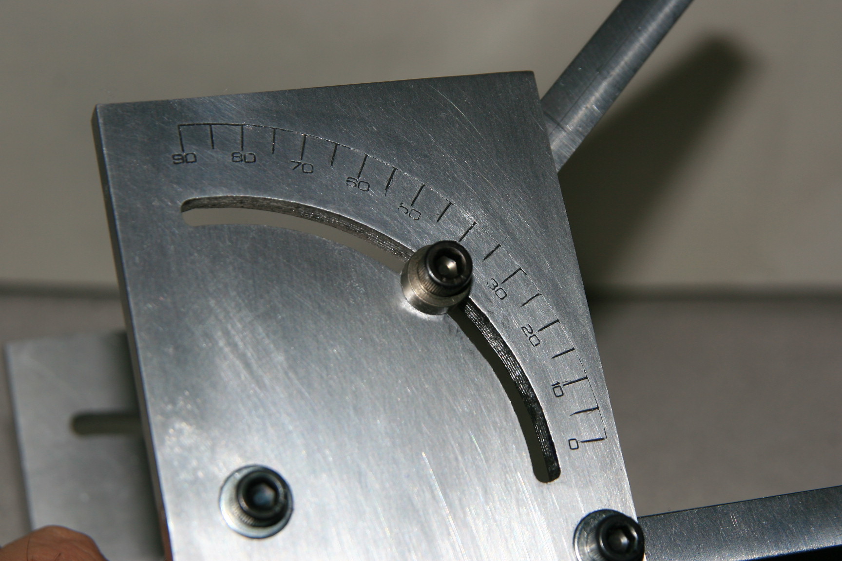

    Nice work, looks great on my cell phone. (Not having internet at home sucks but it does save money). One question, did you use thread insets in the aluminum?

    Hi guys, well no inserts were used in the aluminum. Straight tapping and then I used a bit of anti-seize compound.
    I must confess.....the numbers were not stamped! I cheated and used my CNC machine for that!
    Thanks for all the comments guys.
    Cheers, JR

    Very versatile design. Special thanks for adding the drawings!
