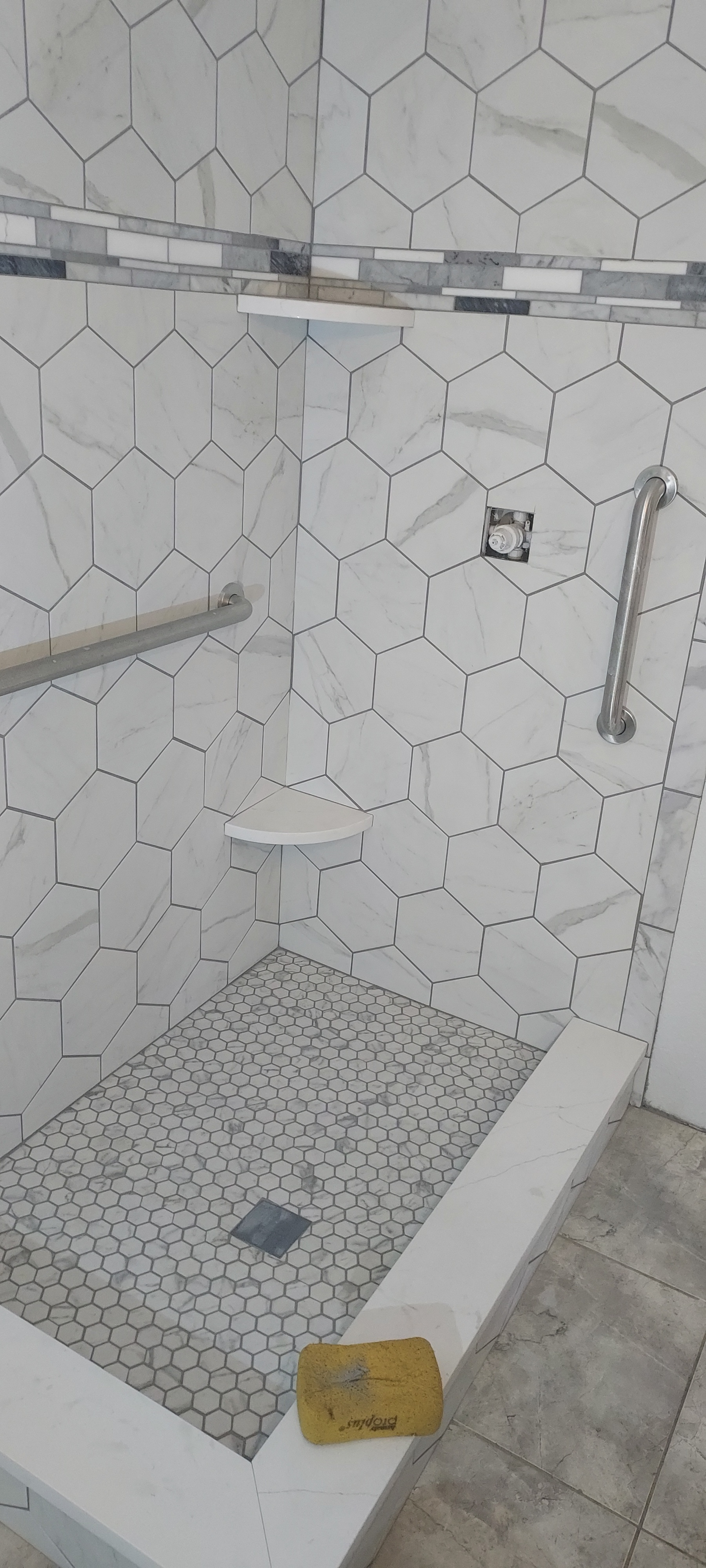

    I did a job once where the field tiles 24"x24" and the border and base tiles were 8"x48". The 8x48 tiles were bowed 1/8" end to end, I had to screw a piece of wood to the wall then press down the other end and screw a second block of wood to hold down the end! The 8x48 would flex the 1/8".
    I think the attached will be my last tile job (50+ years is enough)Tile leveling clips - GIF-chads-bath.jpg
