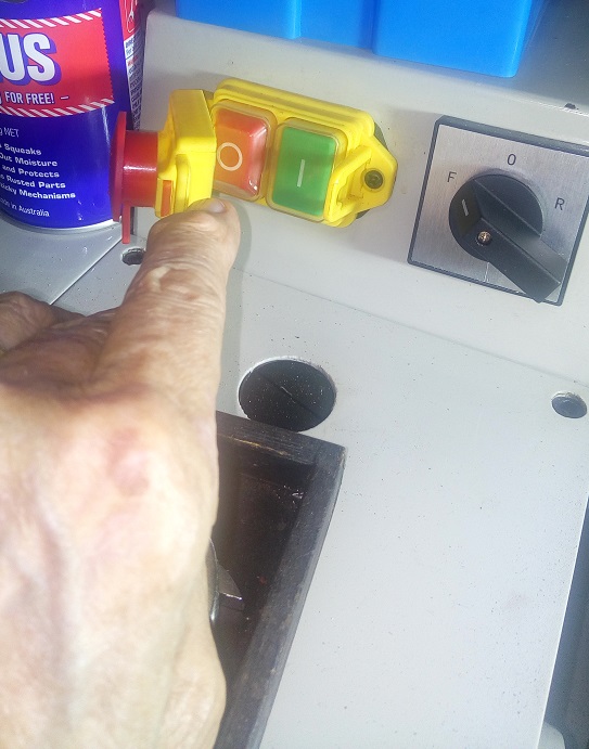

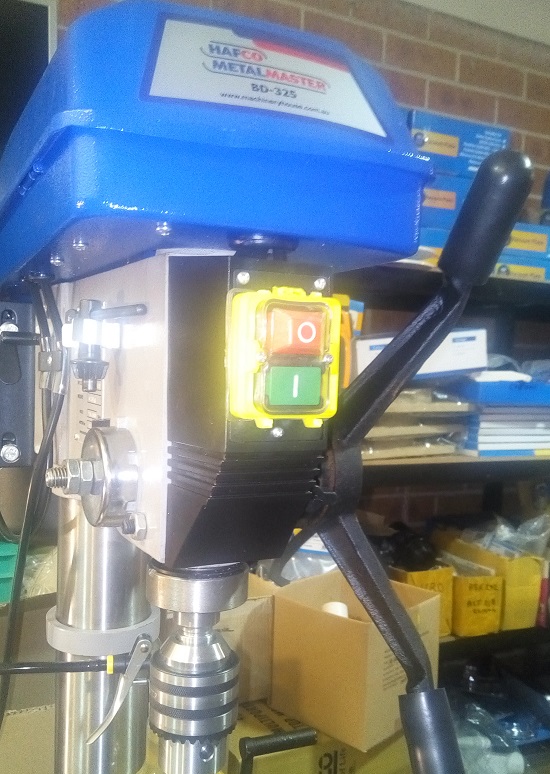

    I use foot switches on my drill presses. It is much more convenient and safer as well. If the drill catches and the work starts spinning it is much easier to lift a foot and run, rather than hang around reaching for the ON/OFF switch with a damaged hand.

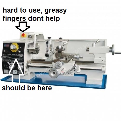

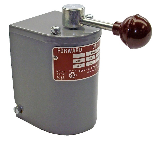

    With all the health and safety these days i would think manufacturers would have a plug in accessory foot switch for most machines where feasible. Even a knee operated off button as reaching up to the button on the drill is bad, just as the button on my lathe. Most imports have the duo on/off buttons with a off button in a lid, most inconvenient, my lathe is particularly irksome, thanks, I'll be doing a foot switch. In the 60s, lathes came with a reversing switch at thigh level, no reaching up over the lathe.

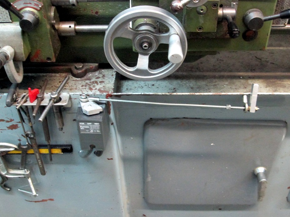

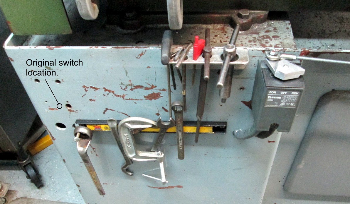

    A lot of elf and safety features on tools actually increase danger because it makes stuff difficult to operate, the switch covers that you show are a case in point. I don't like the illustrated location of the red button on your lathe and although your proposed position is better it still requires you to reach across the spinning plane of the chuck or face plate.
    The switch on my lathe was over to the left and I hated the idea and practice of reaching across that danger zone, so I repositioned the switch as far to the right as was easy for the wiring and then added a mechanical extension to the switch which is well out of the way. That also gives me the option of RH or LH operation. The lathe switch that I like the best are those lever types that are fixed to the RHS of the saddle and travel with it. They usually have a third shaft going through the saddle.
    TIG Pedal Modification-switch-01.jpg TIG Pedal Modification-switch-02.jpg Click on pix for full size.
    The repositioned switch is shown to the left, the right shows the mechanical extension for right hand operation well out of the spinning area. The extension comprises of a bit of 6 mm threaded rod, a couple of cheap rod ends and a small aluminium block to hold or knock.
