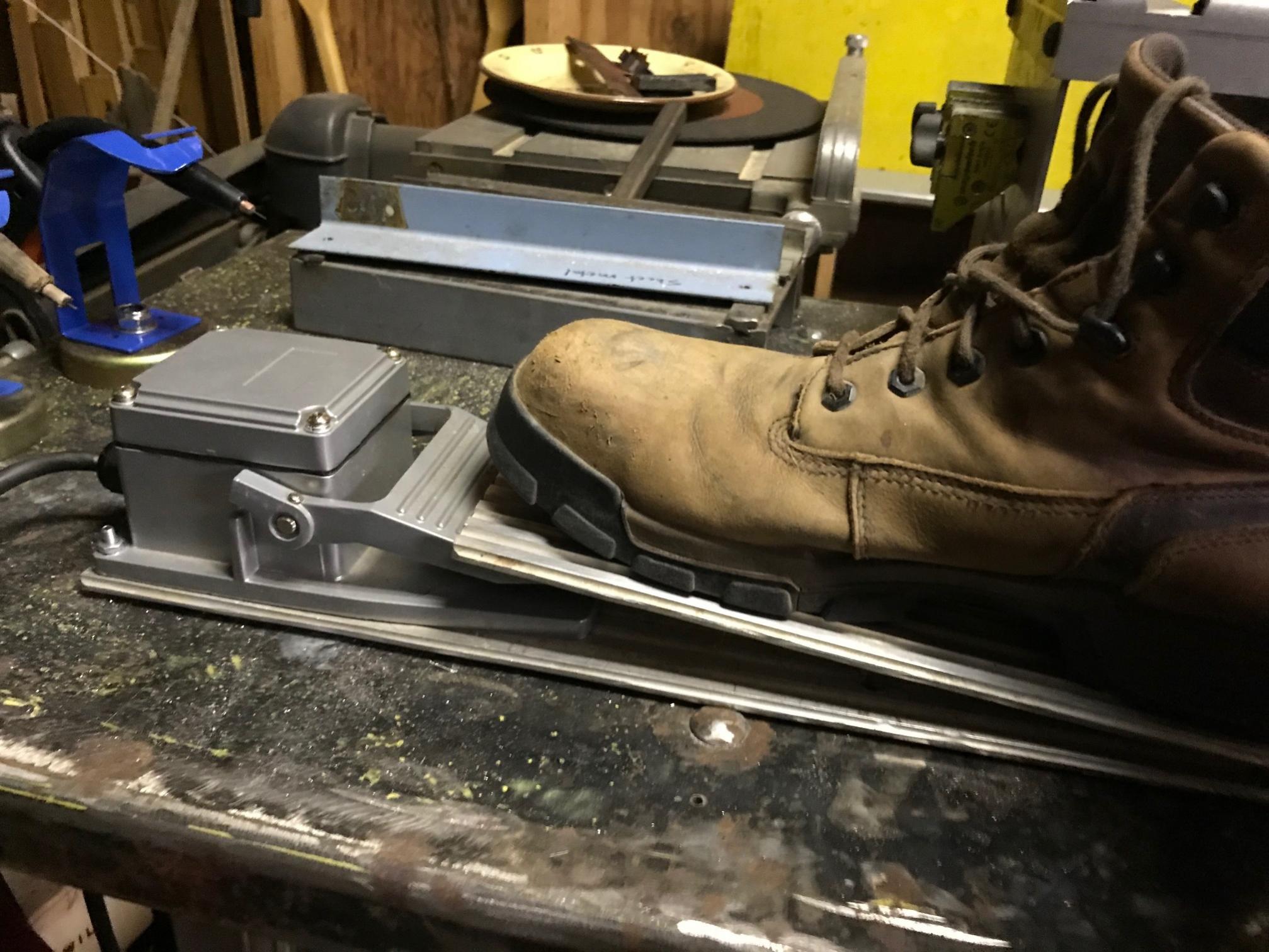

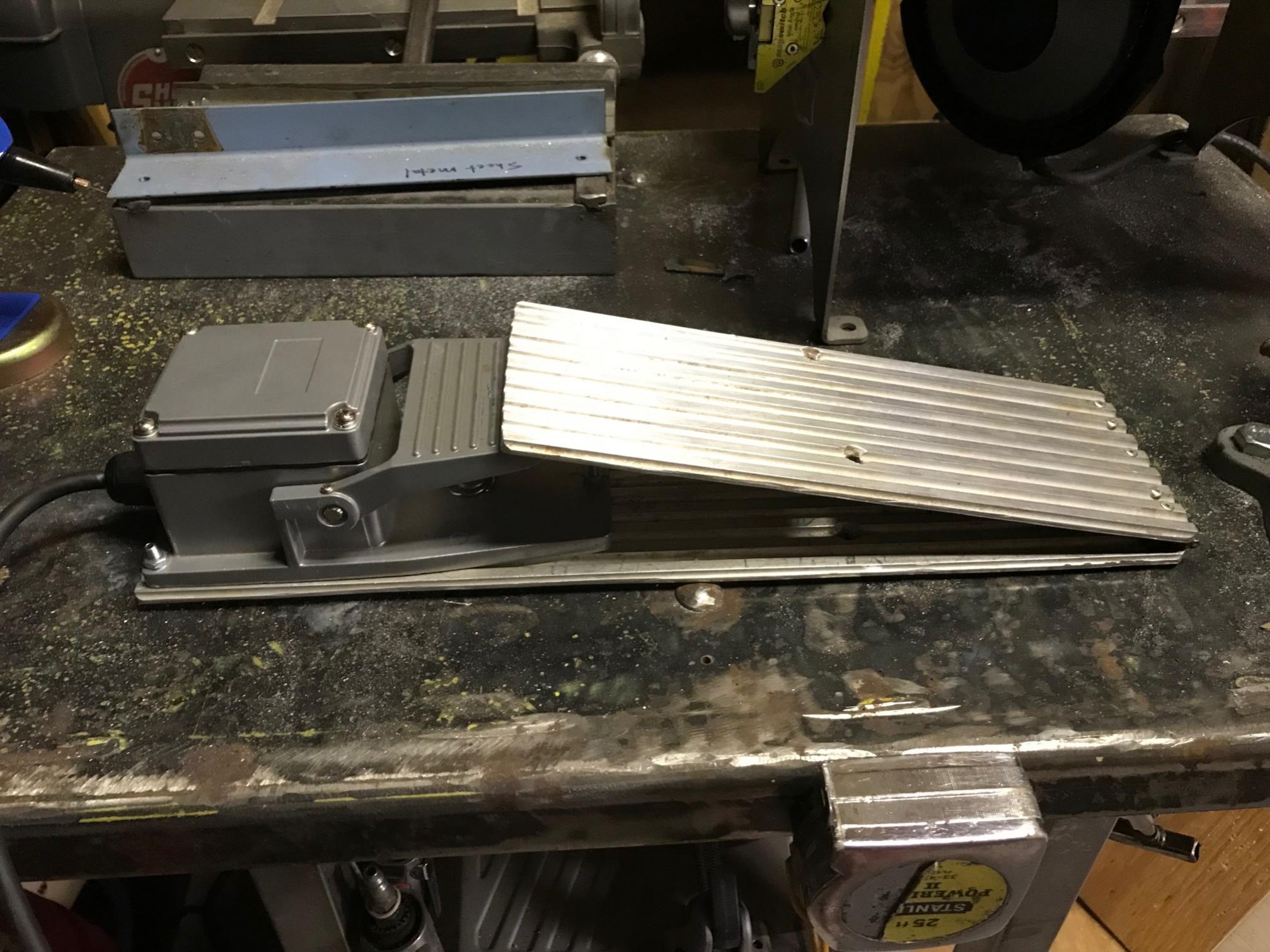

    I did not like the way my TIG foot pedal was configured, so I used an idea I got from a drum pedal. I mounted the original pedal to a piece of aluminum plate (this was actually an old aluminum threshold that I cut down to a 4" width), then hinged another piece so it would depress the TIG pedal. The long bottom piece is about 18" and the top piece is about 12". Works much better now. Pedal doesn't slip and I actually have more control over the variation in power. Build would also work on similar variable power pedals with similar configuration.
    I used aluminum because that's what I had on hand. You can use anything including plywood for this. Just make sure the top plate that you set your foot on is rigid enough not to flex when you depress it. Also, my original pedal had some ridges on it. I suggest that you do your build, set the original pedal on it with the top plate about half-way on the pedal. Then depress it fully. This will cause the pedal unit to move slightly as the top footplate finds its position between two ridges. Mark your pedal location and screw it to the bottom plate.
    Good luck!

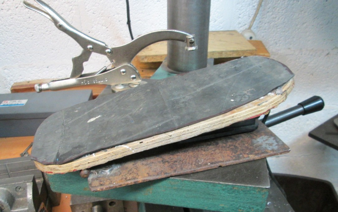

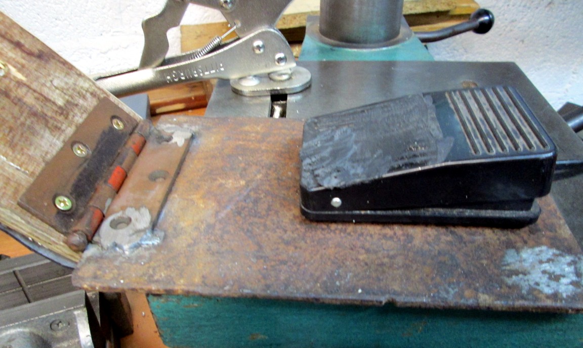

    I use foot switches on my drill presses. It is much more convenient and safer as well. If the drill catches and the work starts spinning it is much easier to lift a foot and run, rather than hang around reaching for the ON/OFF switch with a damaged hand.
    The switch on one of the drills was not nice to use because of its angle to my foot and often I would inadvertently release the switch. A foot control where it all moves with your foot is much better to control. I already had the switch mounted on a bit of scrap steel plate to add some weight to hold it steady so all I had to do was to weld a door hinge to the plate and screw the other side to some old plywood. To add a finishing touch I glued a rubber sheet to the wood. The rubber was cut from an inner tube. I love it now.
    TIG Pedal Modification-foot-switch-01.jpg TIG Pedal Modification-foot-switch-02.jpg
    On the left is the detail of the hinge fixing, on the right is the operational side.
