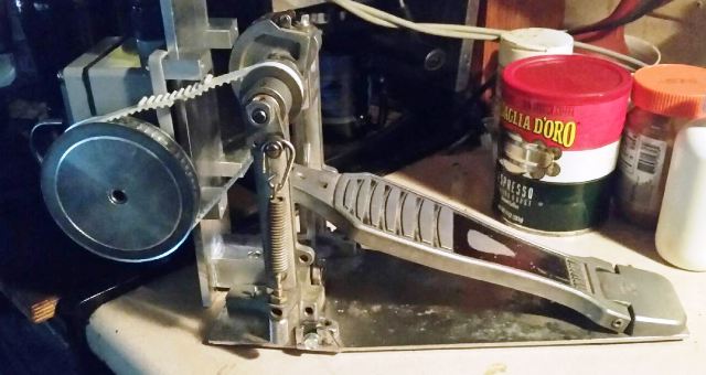

    You're definitely right about there being two classes of TIG welders - affordable and workable if a good choice is made and really expensive commercial grade. I've found my Lotos TIG welder to be usable for everything I need to do and I could afford to buy it so that's what I use. Many of the asian welders come with a foot pedal that's inconvenient to use, including my Lotos, so I modified it to overcome the deficiencies. I transplanted the controls onto a used bass drum kick pedal for a rugged and heavy pedal which stays in place (I know what you mean about chasing the pedal with your foot while trying to run a bead) and I further modified the drive to change the control box travel of 30º to a pedal which travels more than 60º using an XL timing belt drive and that gives me finer control of my welding current. The plus is that the pedal works in the usual direction instead of having to position it backwards as you must do with the supplied pedal. It's been working well for me and is rugged enough to survive the typical abuse of a welding shop.
    Note to editor: This is already in my builder's page so no need to include it again.

    I think it's a better use of my time finding something which I can buy and modify to suit my application than to spend the countless hours building it all from scratch. Many of my designs incorporate things already made by someone else as a starting point. I get more done that way and at a reasonable cost.

    I bet it come with the same one as my ahp alpha tig. I love that foot pedal. For some reason my ankle does not do the forward pivot movement for a regular foot pedal very well so I much prefer the push straight down movement of the Asian foot pedals. Just wish I could find a way to keep it in place. I thought about making a bracket to attach it to my chair I sit in to tig weld

    Many of those CE TIG units use the exact same control box.
    Before I reworked my pedal I attached the control box to an 18" square of 5/8" plywood and that kept it in the general vicinity of my foot.
