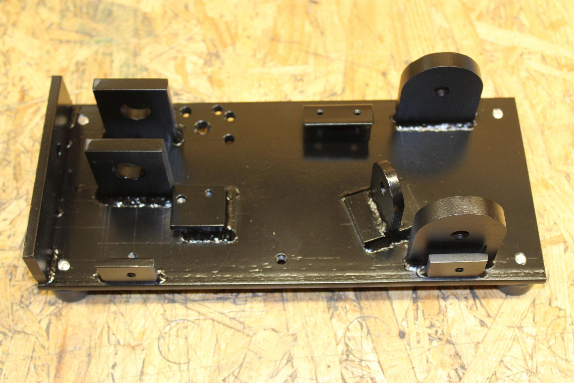

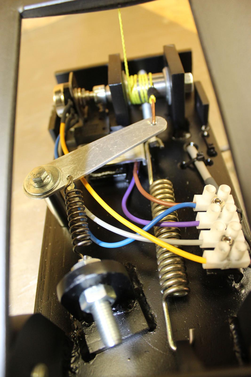

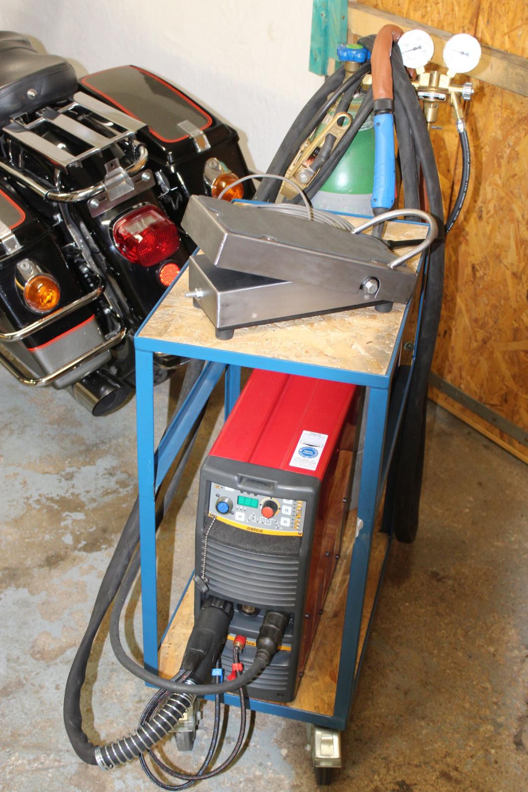

    Hi all!

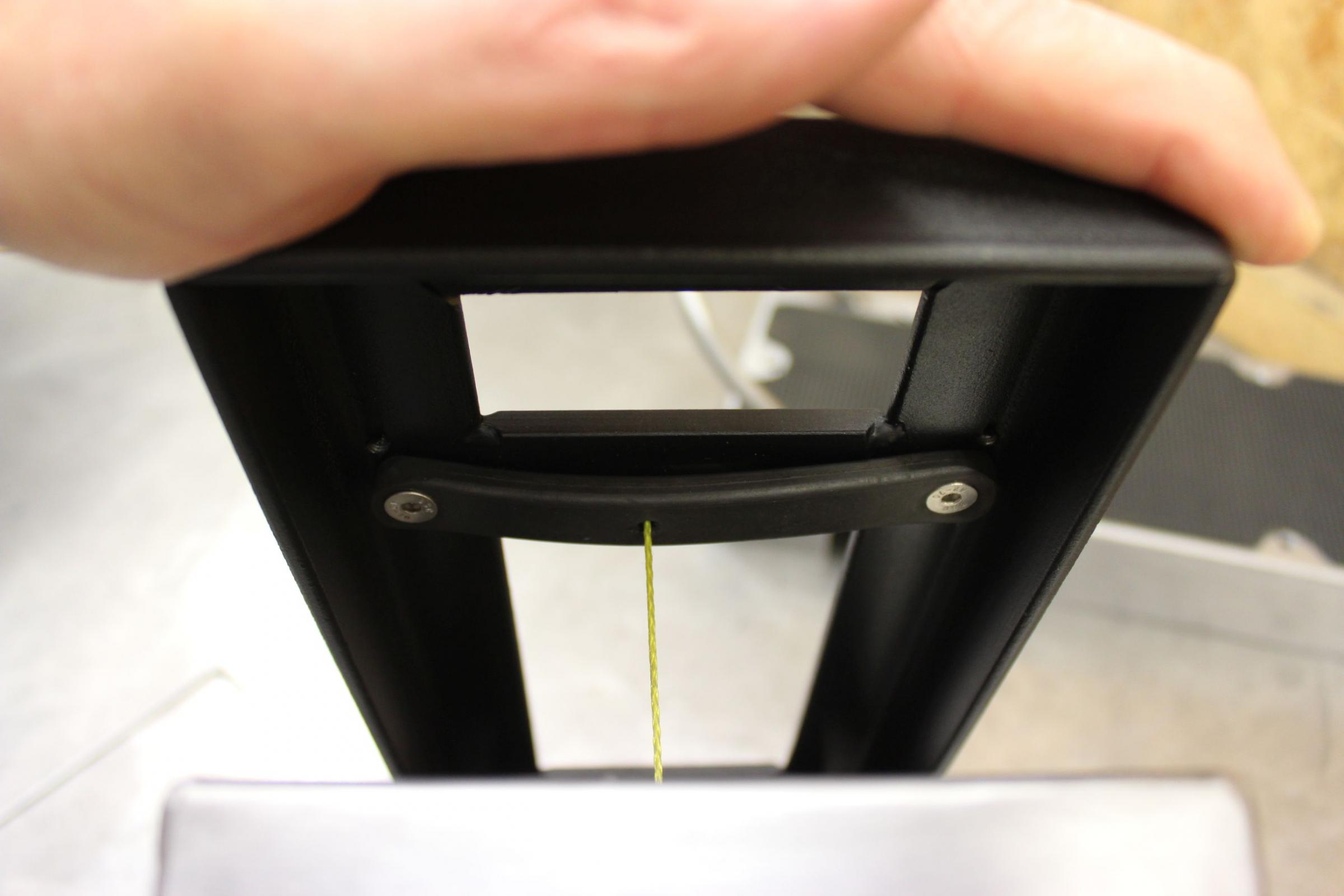

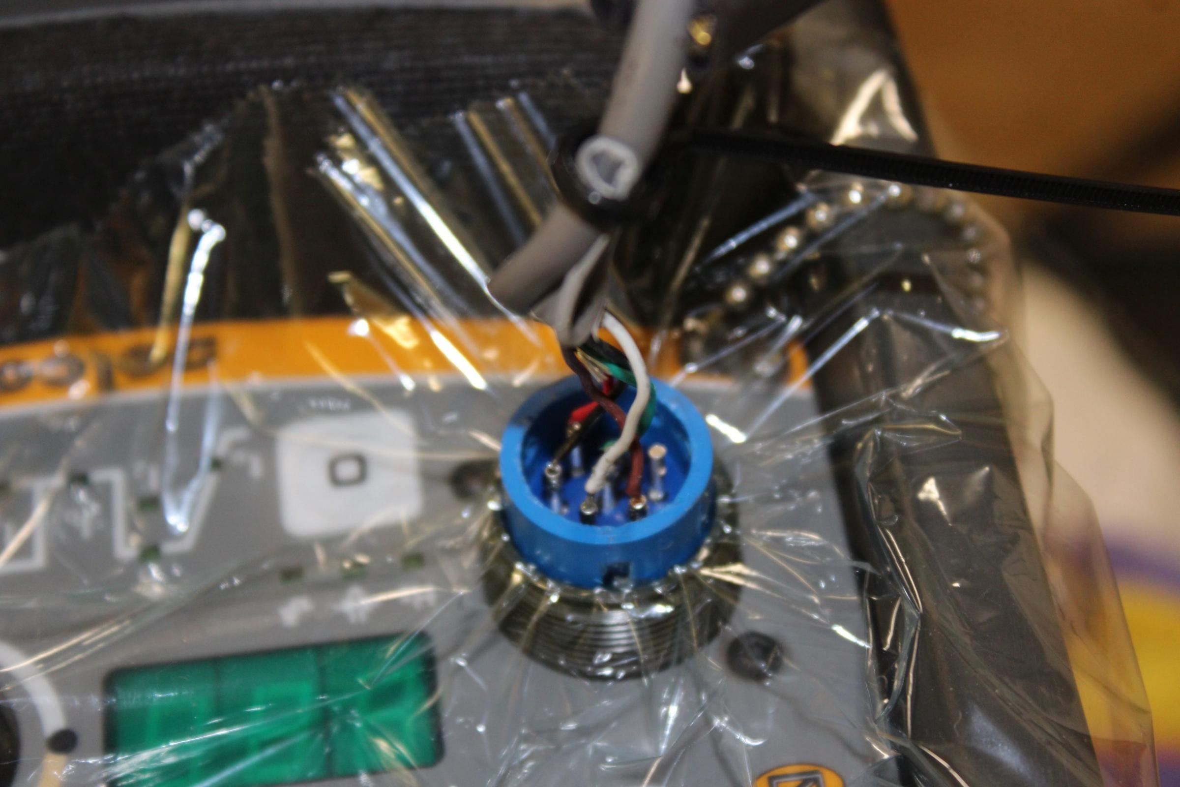

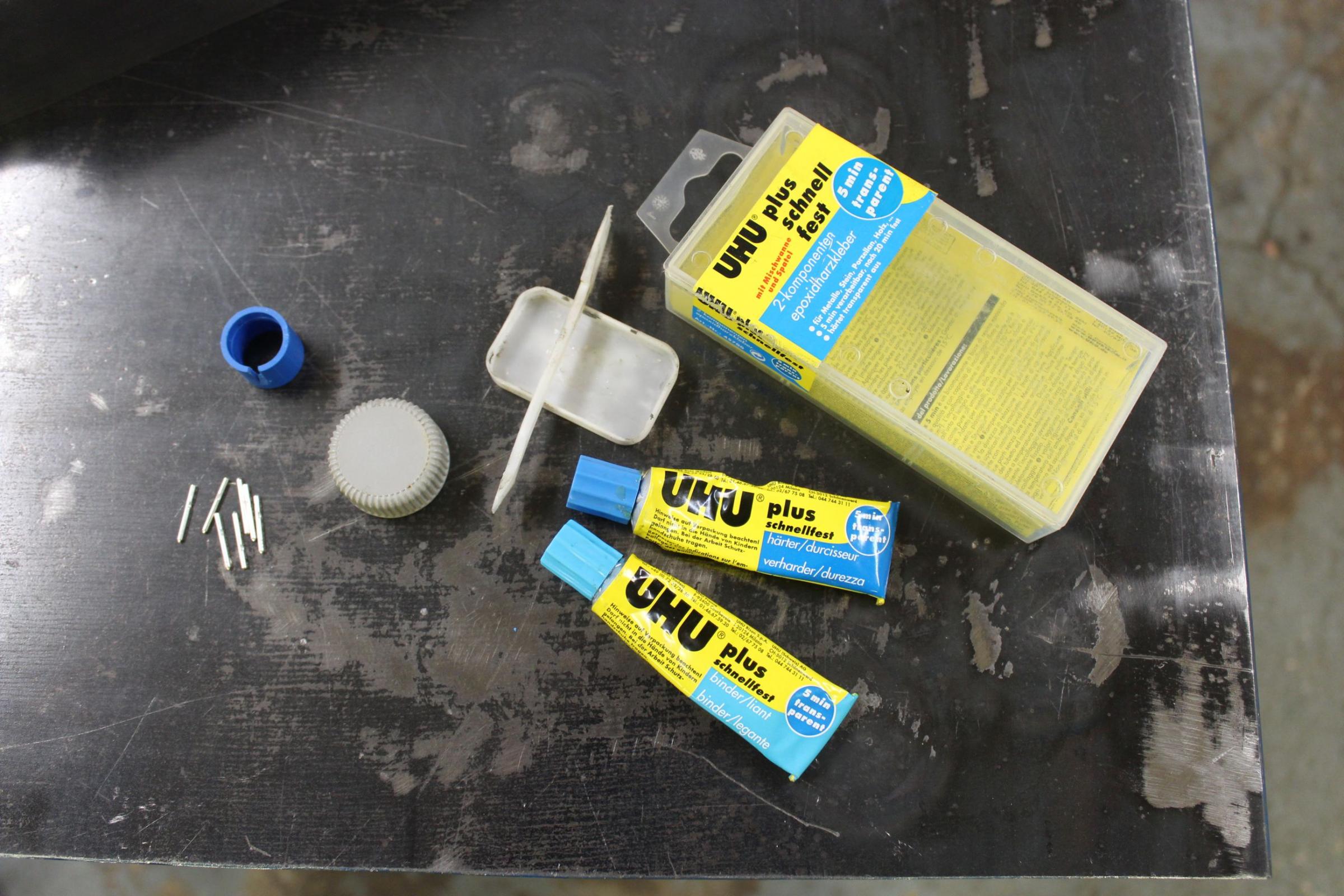

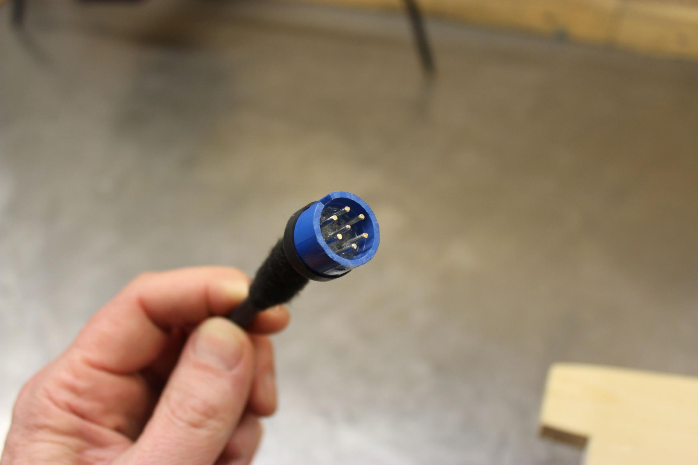

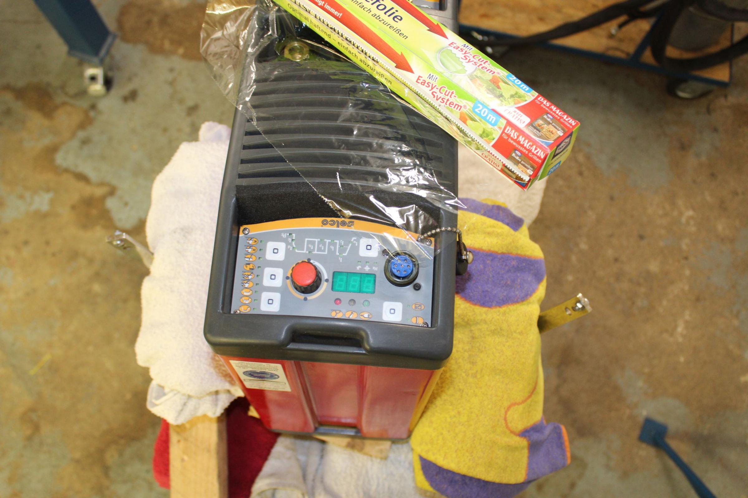

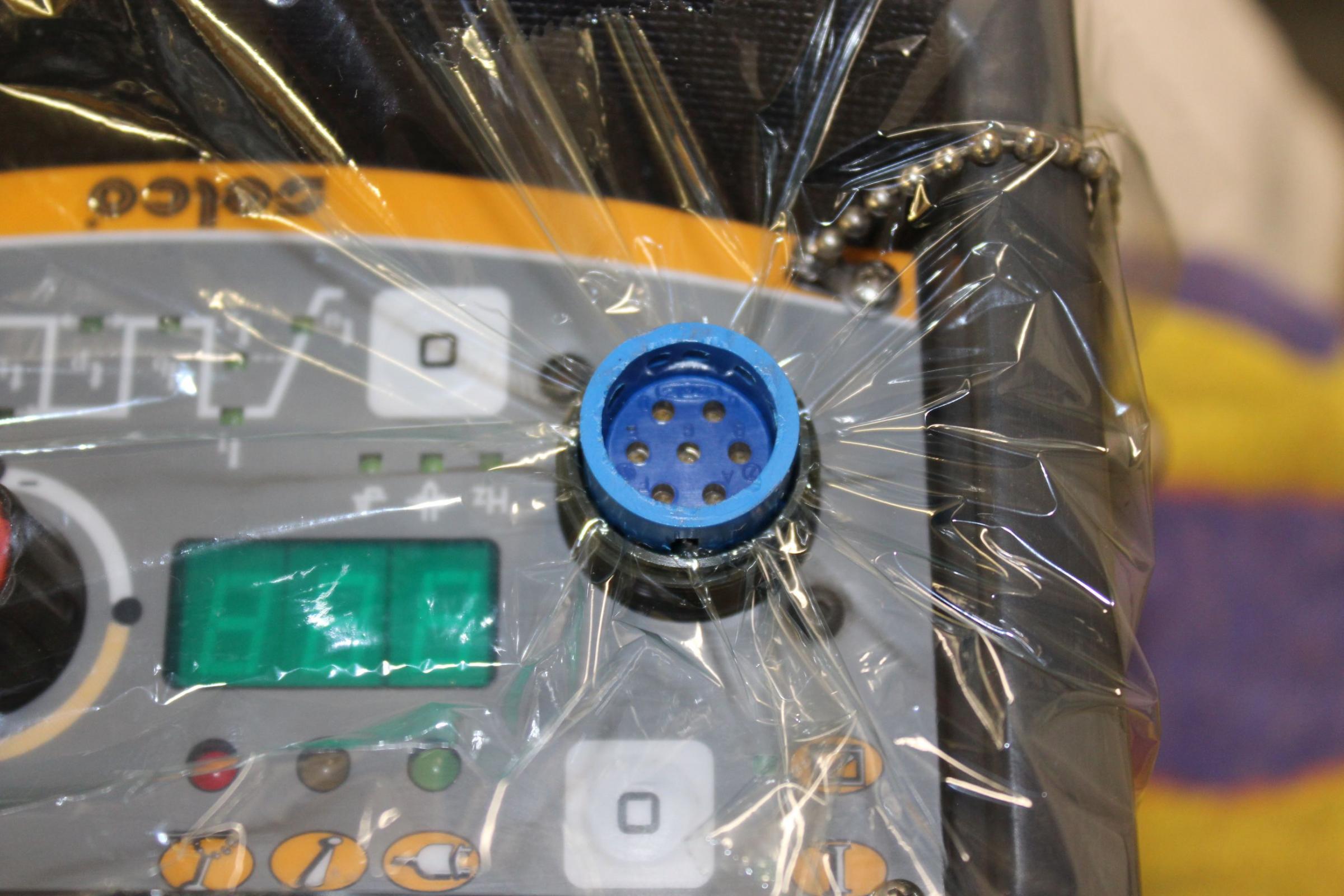

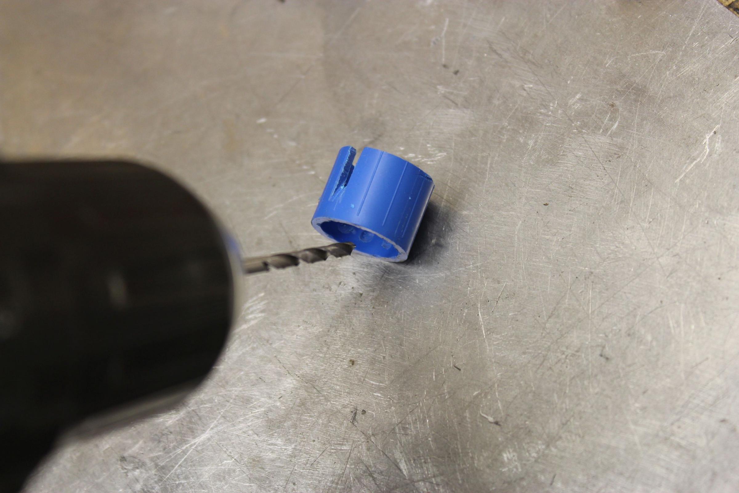

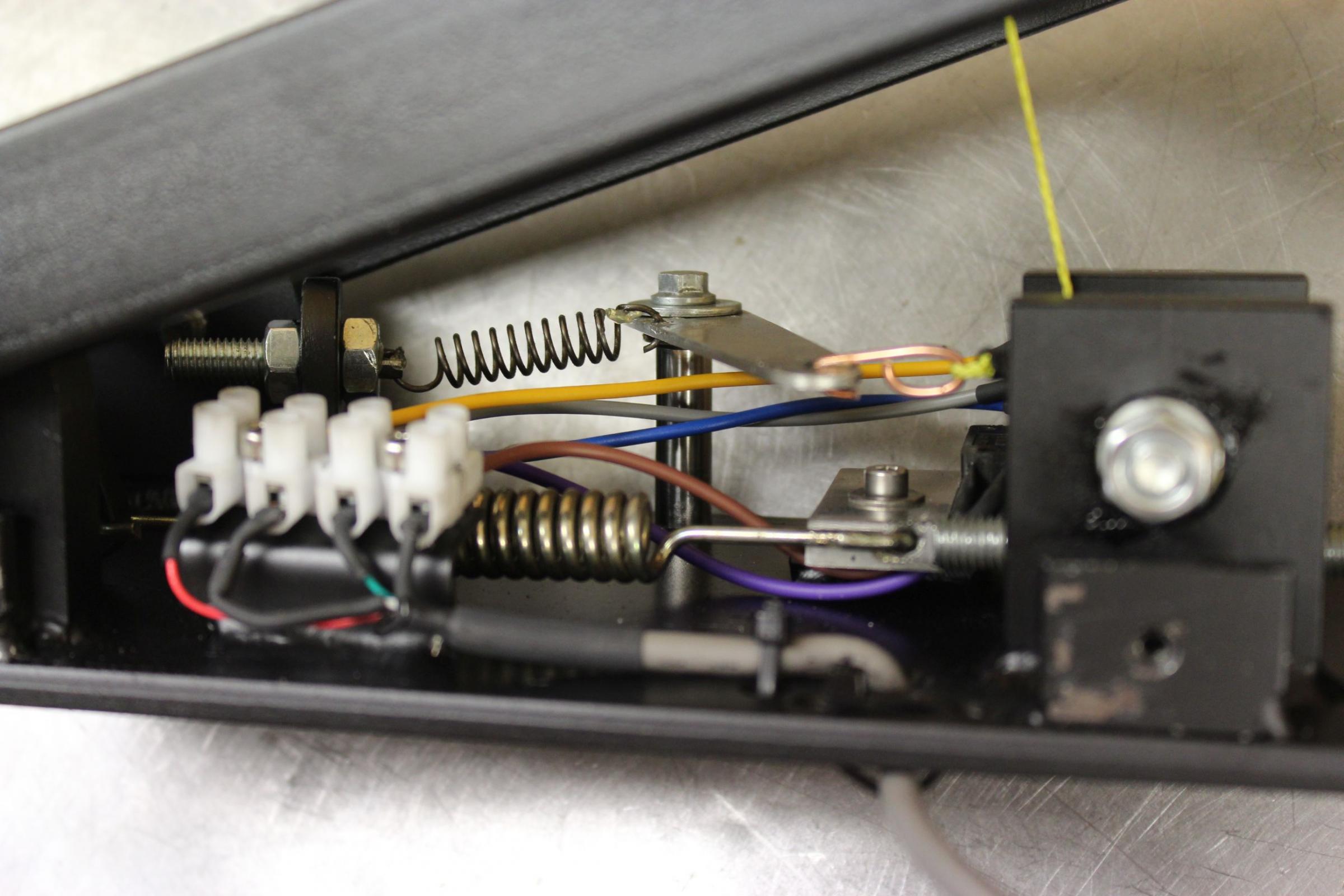

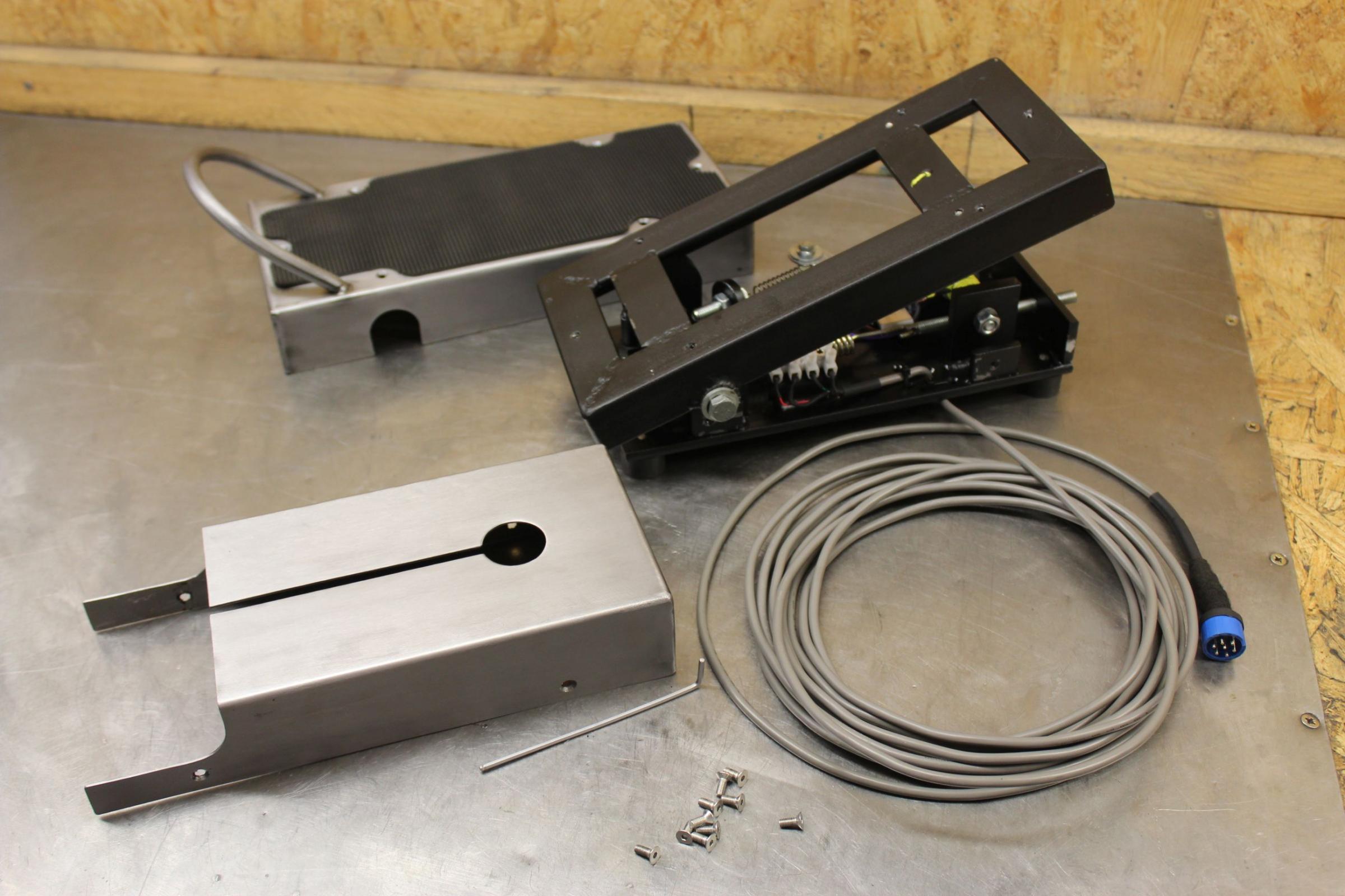

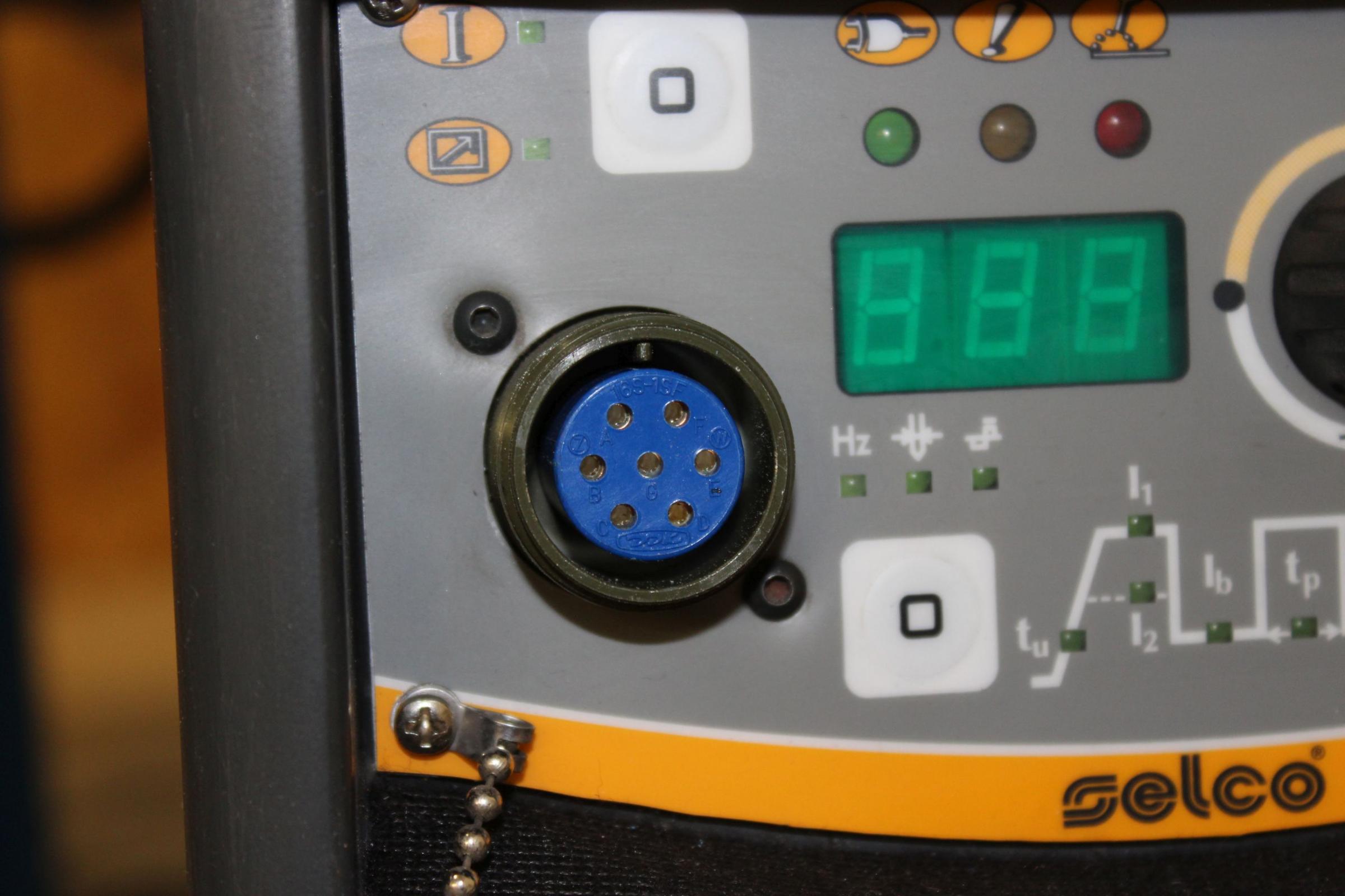

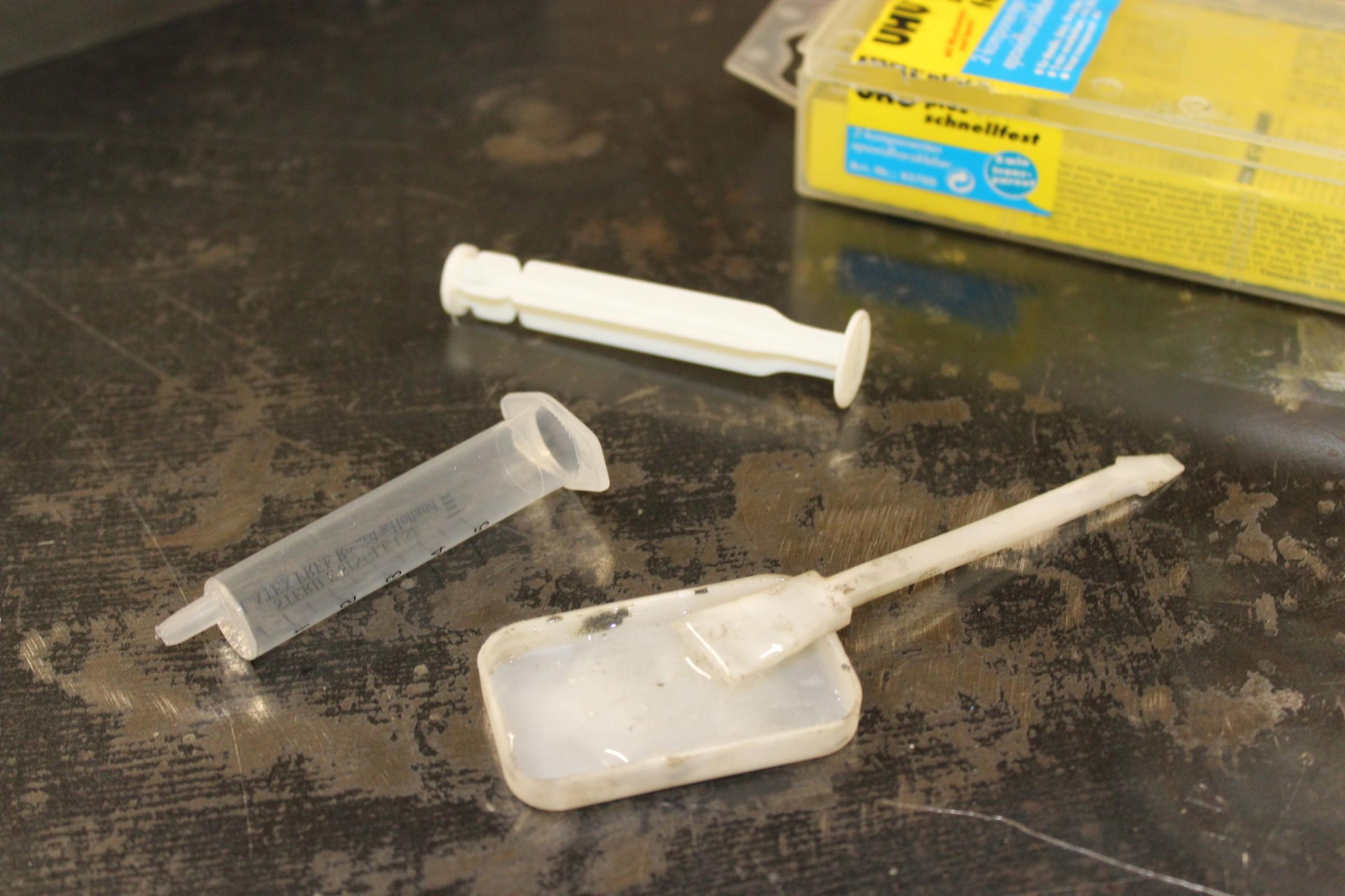

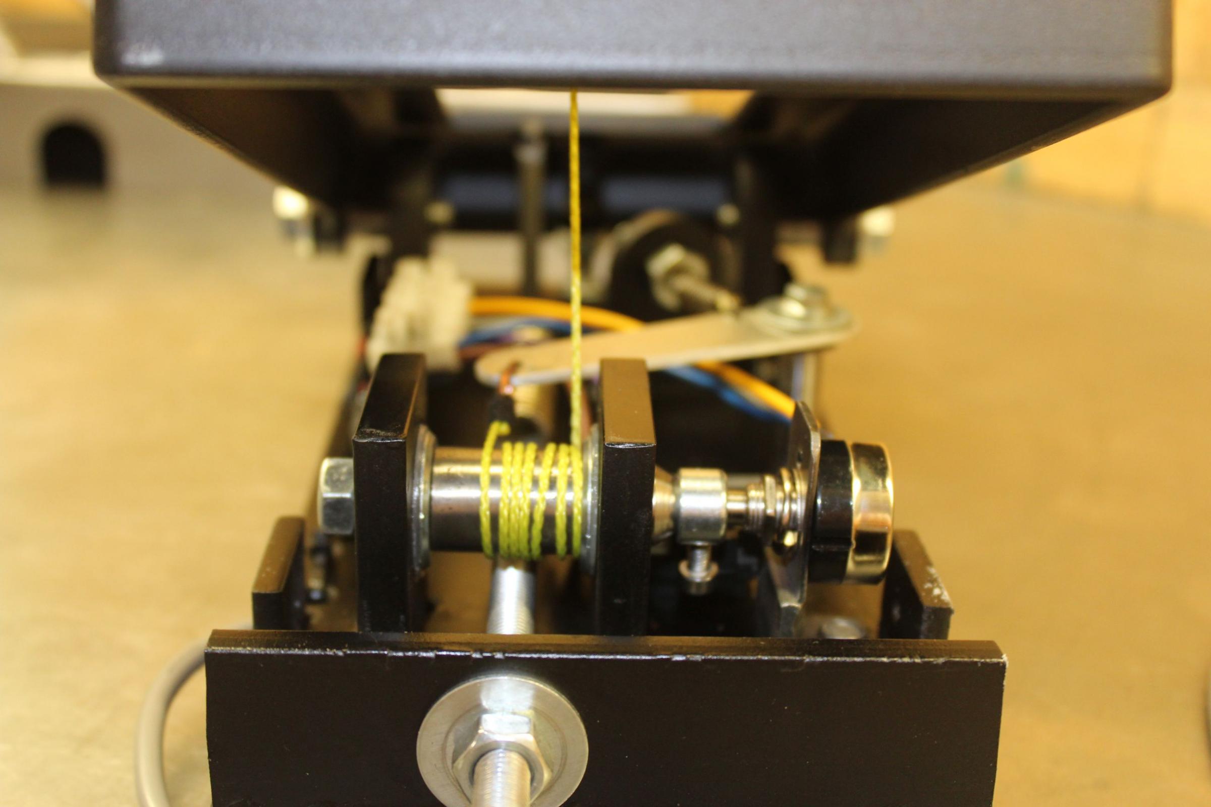

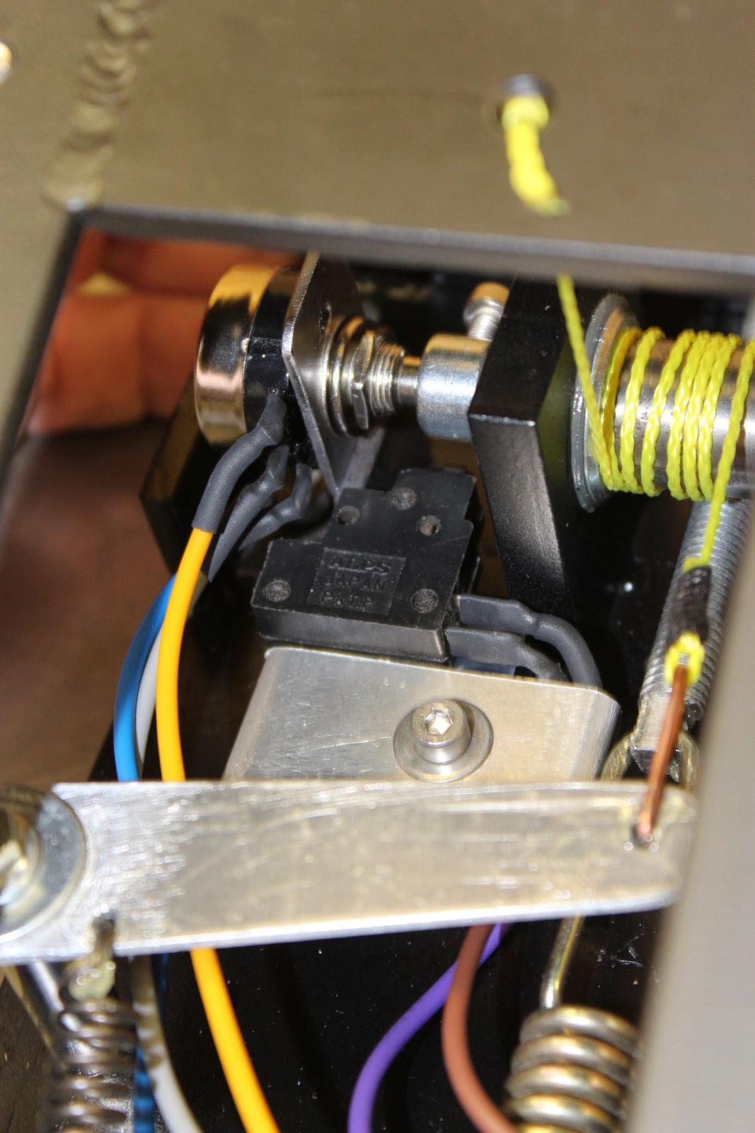

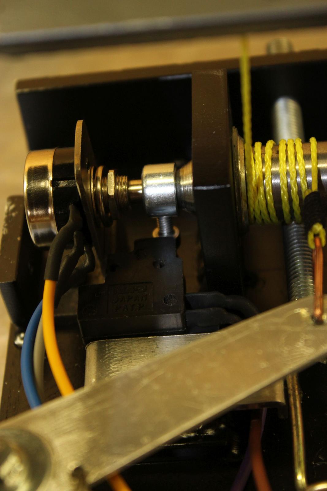

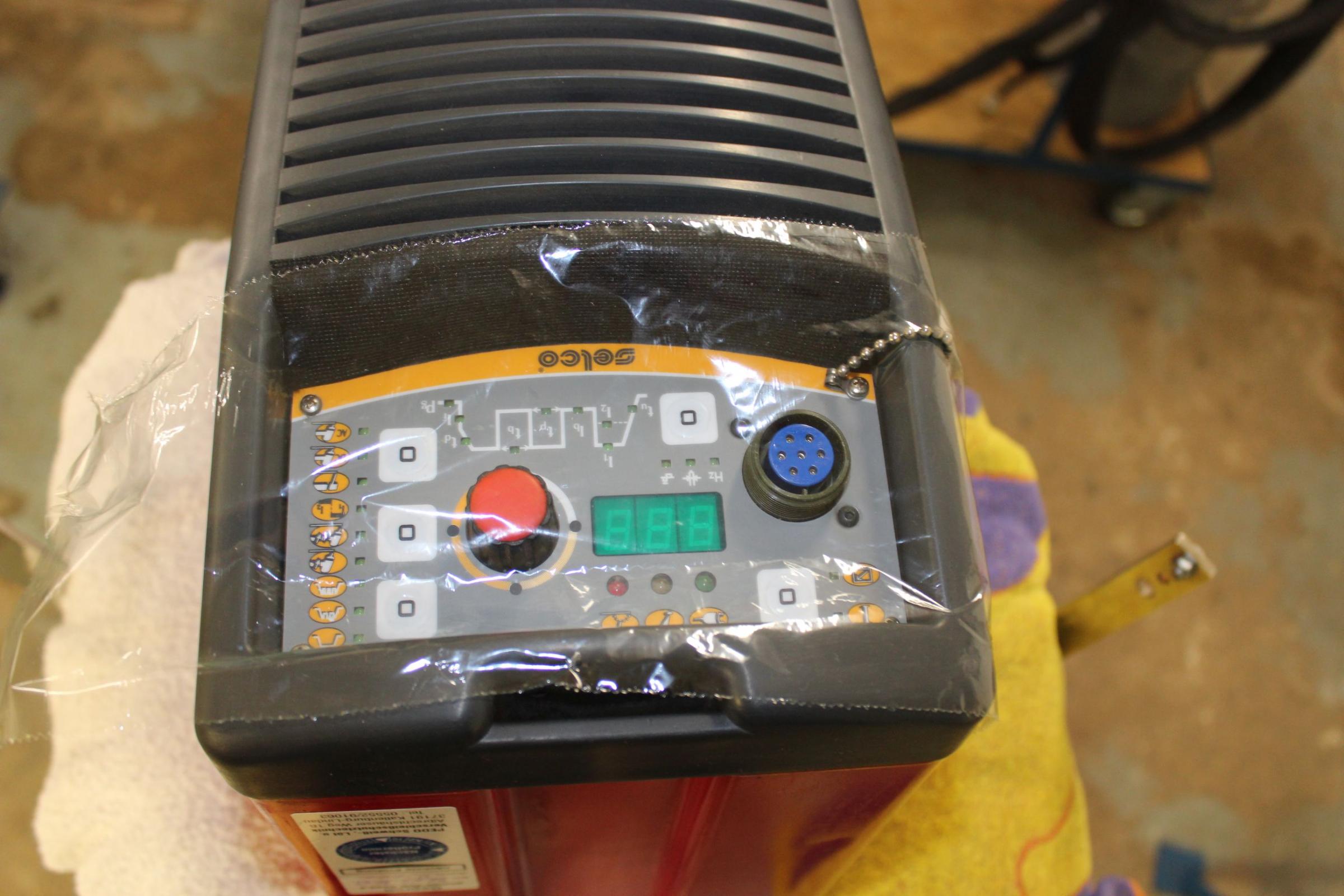

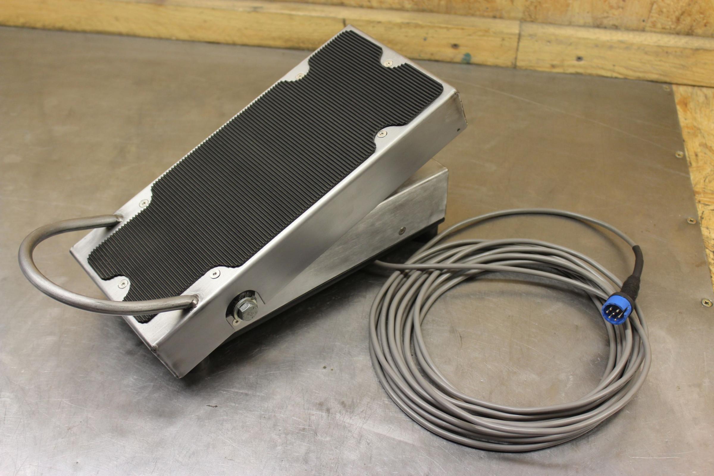

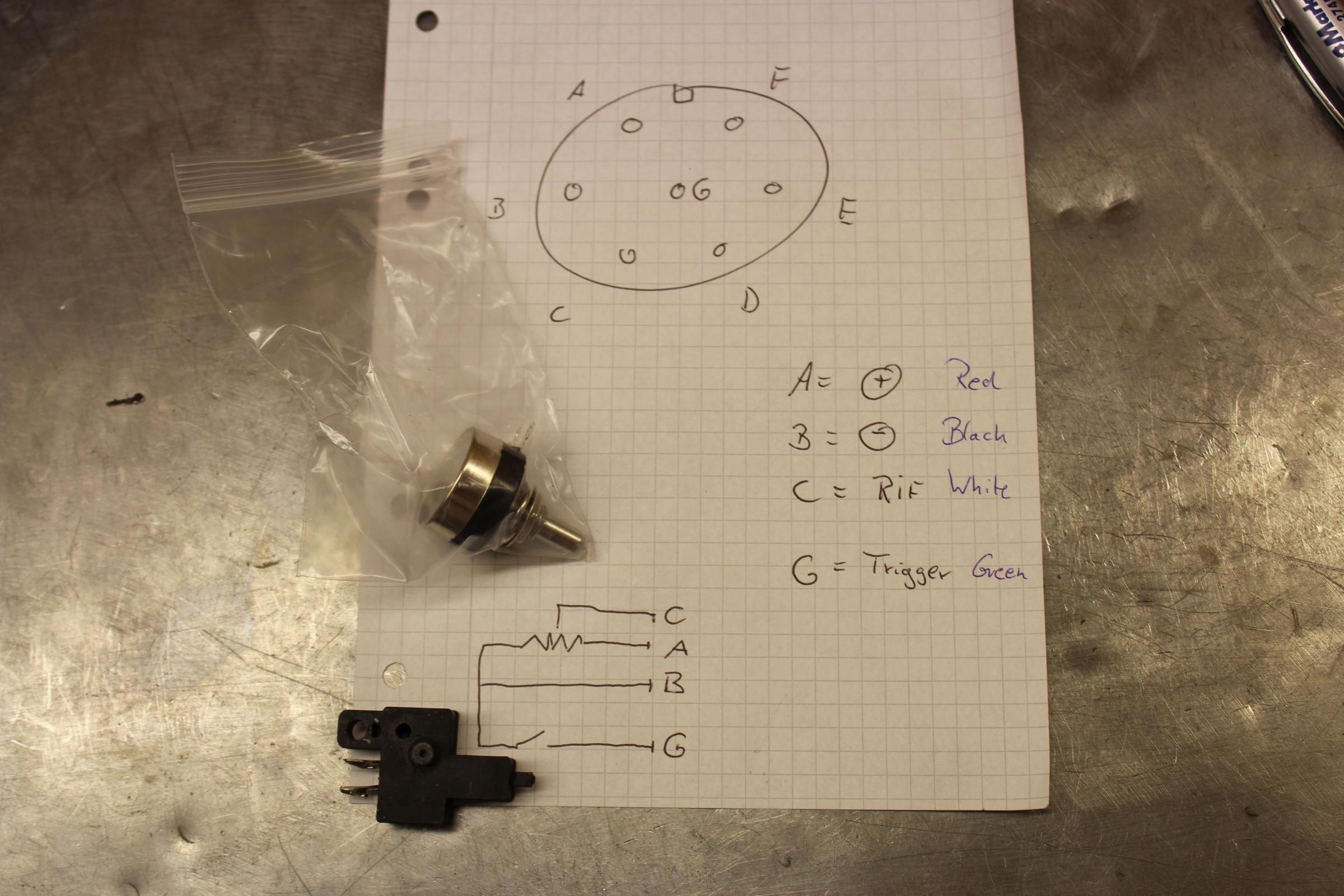

    I bought a nice used TIG welding machine the other day. It is an Italian make you might have never heard of. It is a ca. 2002 "SELCO Genesis 200 AC-DC" with water cooling and lots of nice features and it is in perfect condition - BUT! - It came without a foot pedal for the amperage control. Especially for welding aluminum, the use of a foot pedal makes life alot easier (to have proper heat control). So I searched the web to find a pedal that would work with my new welder. But finding the combination of a 10k Ohms potentiometer control with a 7-pin connection plug of military standard and a reasonable design/rigidity was in vain...
    During my search I got the impression that there is some kind of "two class society" when it comes to welding equipment. You either find cheap stuff from the far east or the high end manufacturers stuff which I sometimes found ridiculously expensive.
    Finally I decided to build a pedal by myself.

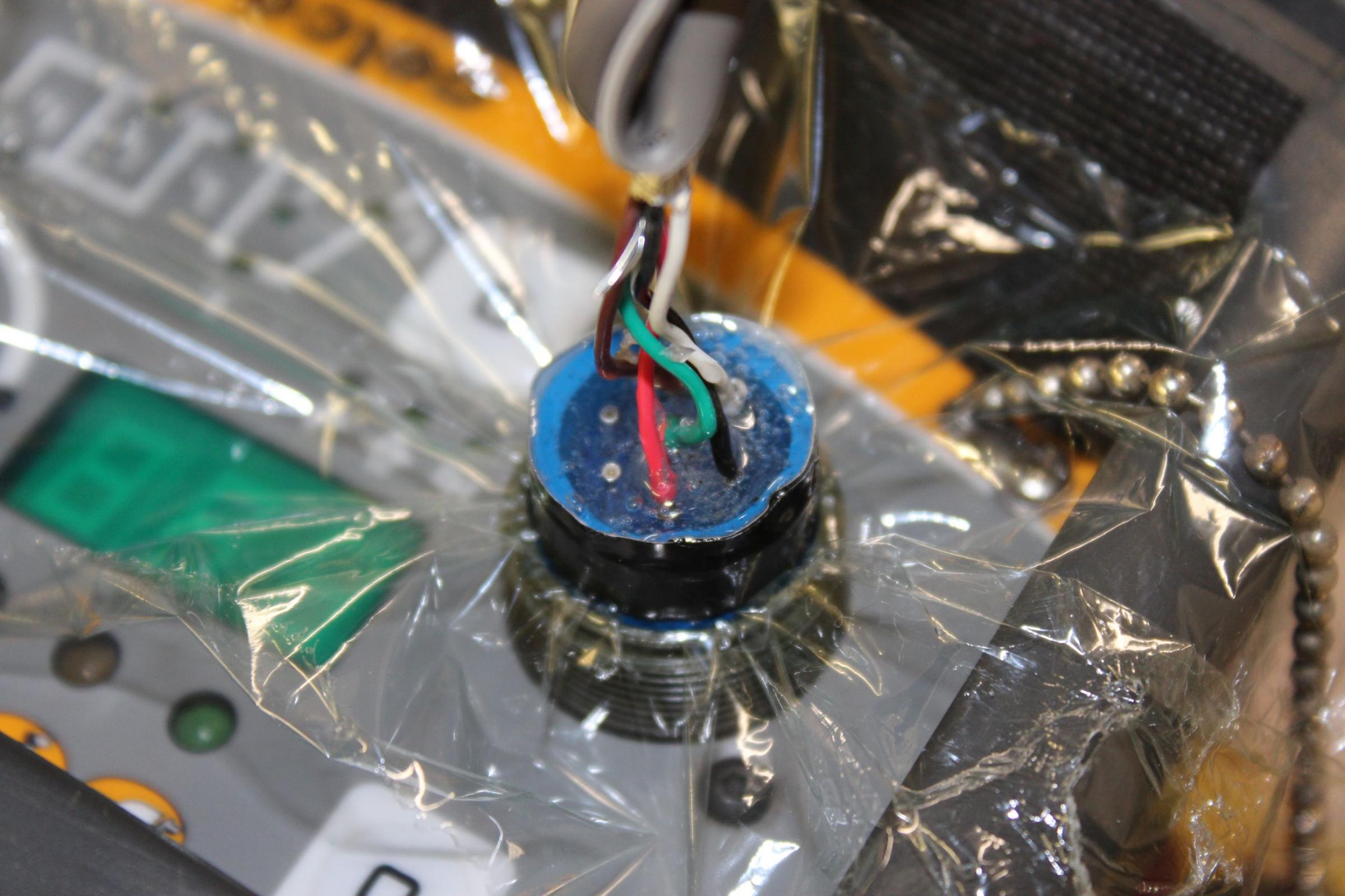

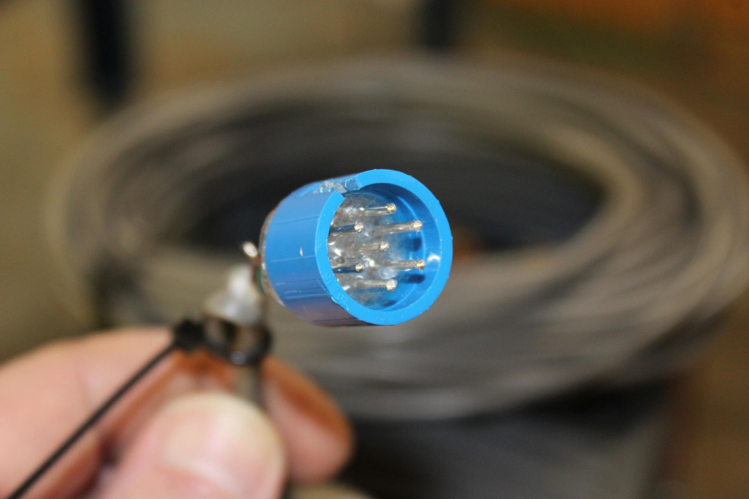

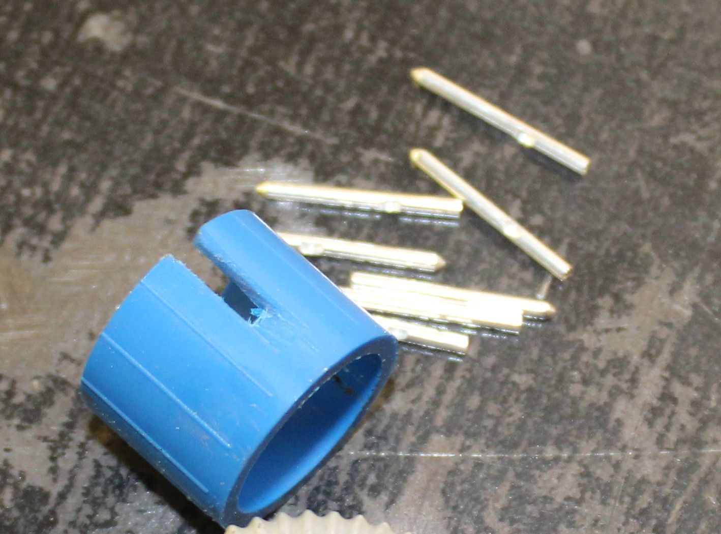

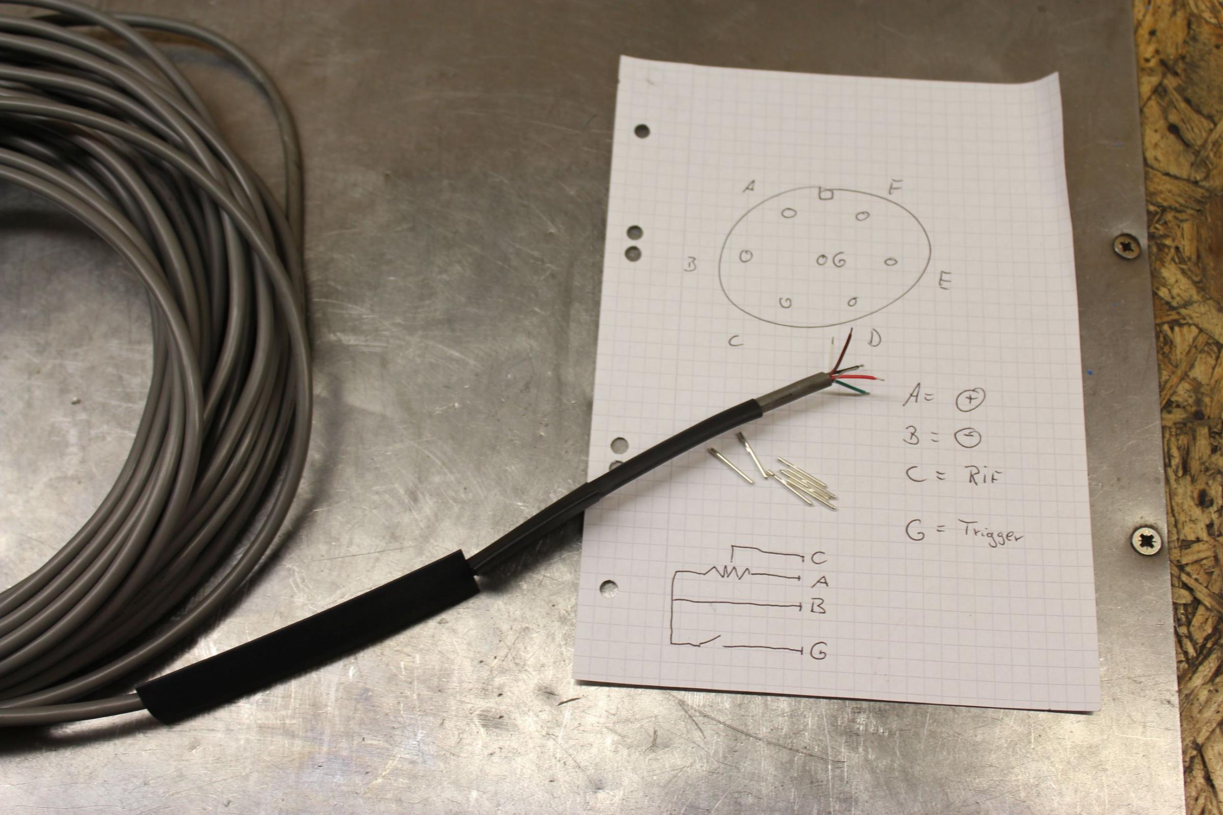

    The only components I did not have was the potentiometer, the signal cable and the plug. I got the first two from an electronics market for less than € 20.-. All other parts (except for the sheet metal) came out of my scrap box. As an example: The switch - needed to initiate the arc start - is a micro swith from the controls of an old Honda motorcycle. My research for the plug gave prices around €50 so I decided to build that one as well. Attached are pictures of some sketches I made, of the pedal and the DIY-plug.
    It was fun to build and it works perfect. The weight is about 4 kilos so it does not hop around when pushing the pedal.
    Greeting
    Charst

    I used to have to make quite a few of those hot melt glue and epoxy plugs. I used to test aerospace and military gear so we needed to plug into the gear but nobody ever gave us mating cables. So... box of spare pins and glue. We just put a piece of paper over the female, stabbed the pins through, put a tube over and filled.
    Then there were Winchester Connectors. If you could assemble a Winchester connector right on the first try, you could do anything in Ikea blindfolded and drunk. I finally got to bringing the Winchester sales rep in, pointing at some piece of aerospace gear on my bench and saying we needed 5 or whatever of the mating connectors. ASSEMBLED. No, I didn't care what the pin numbers were, which screw finishes, or anything else. FIT THE HOLES and not be missing parts.

    Nicely thought out heavy duty TIG pedal. Should last you a very long time. The onl thing that might ever fail could be the potentiometer.
    Hi!
    How's your Shrinker-Stretcher doing? Is it already in operation?
    My tip is that the filament will be the first thing conk out. We shall see...
    At the moment it works just fine.
