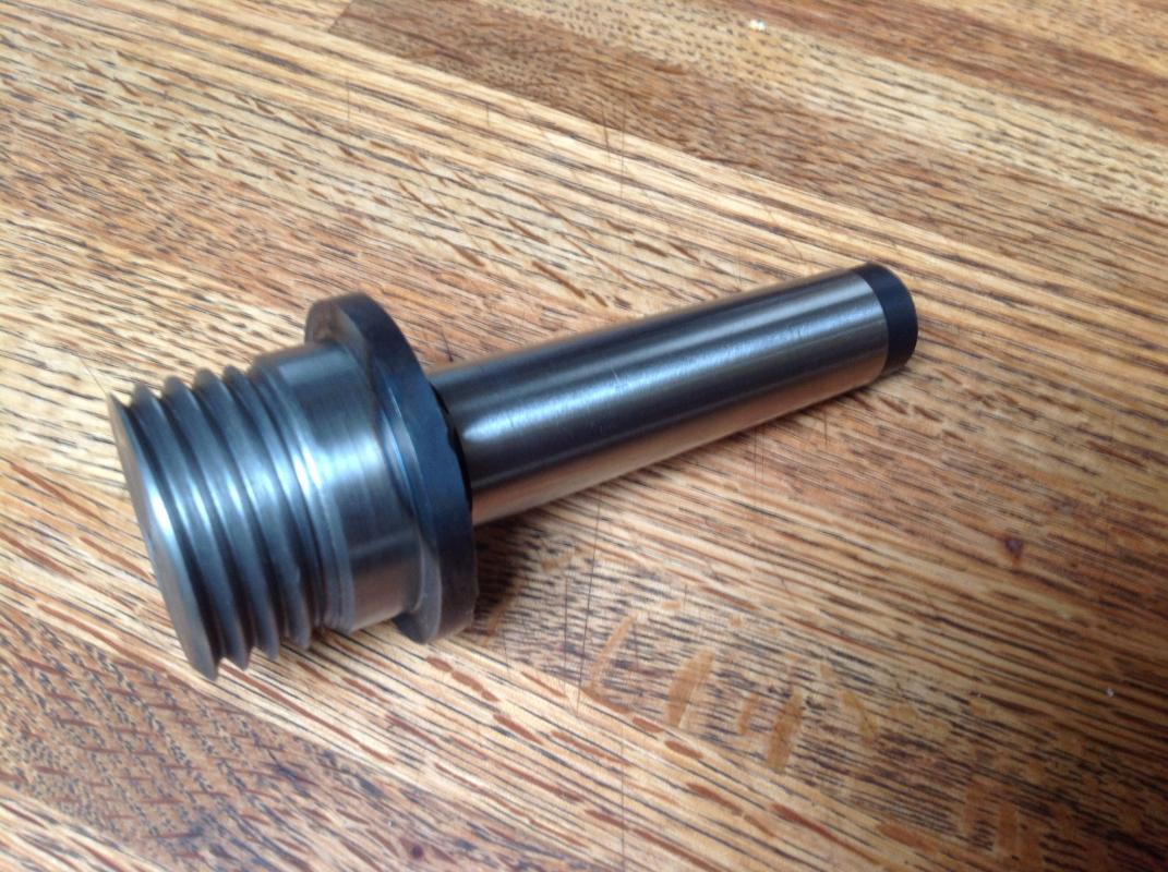

    I did like you said Paul and went to Wikipedia. Thanks, I don't use the site as much as I should and it never would have dawned on me to look there. Lots to grok. I am very interested to see how this whole thing goes as there is a lot of parameters I'm not sure of. And not having anything that's mt5 keeps me from having any use. I did go through something somewhat similar(I hope) in that I wanted to be able to mount my 3" 3jaw Chuck on my 10" rotary table. I did a mod of an arbor on you tube that a guy used to quick align his rotary table. I found this:
    Arbor, Blank 3MT Drawbar 2393 - LittleMachineShop.com
    So I had my brother the real machinist make this for me:
    He had to weld on the steel ring base because the soft machinable end wasn't big enough. I think it came out great and it works great. Added benefit is I can mount any of my three chucks, 3", 6" or 8" 4jaw on the rotary table. I've been meaning to go back and order a couple more to make the centering pilot like the original you tube. Unfortunately this doesn't help you with your quest Paul. But it's kinda related

    Great photo. My compliments to your brother's skills in fabricating the Morse taper threaded arbor. Thanks for the LMS tip. You should show more photos of your rotary table chuck adapters.
