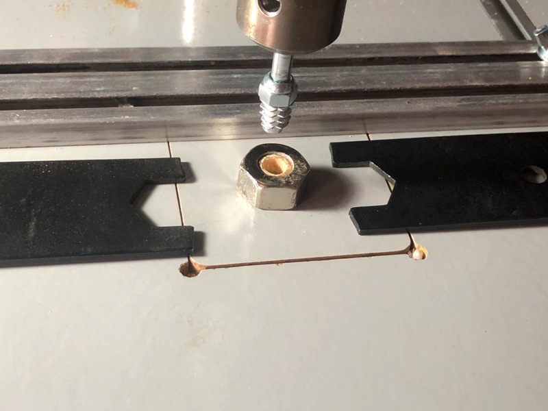

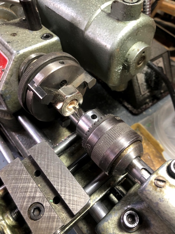

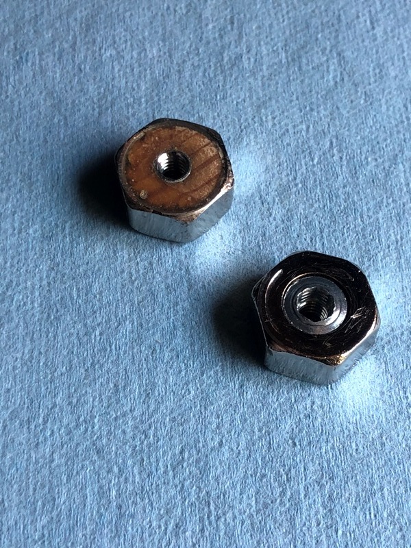

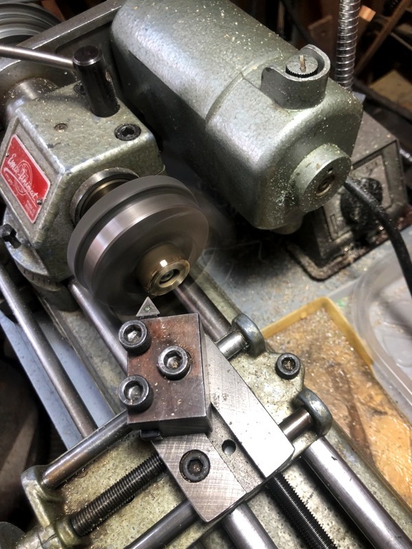

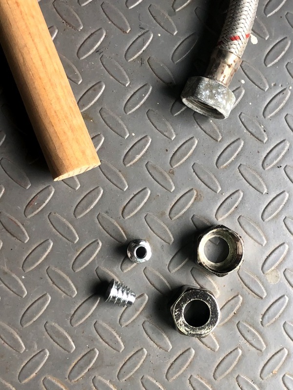

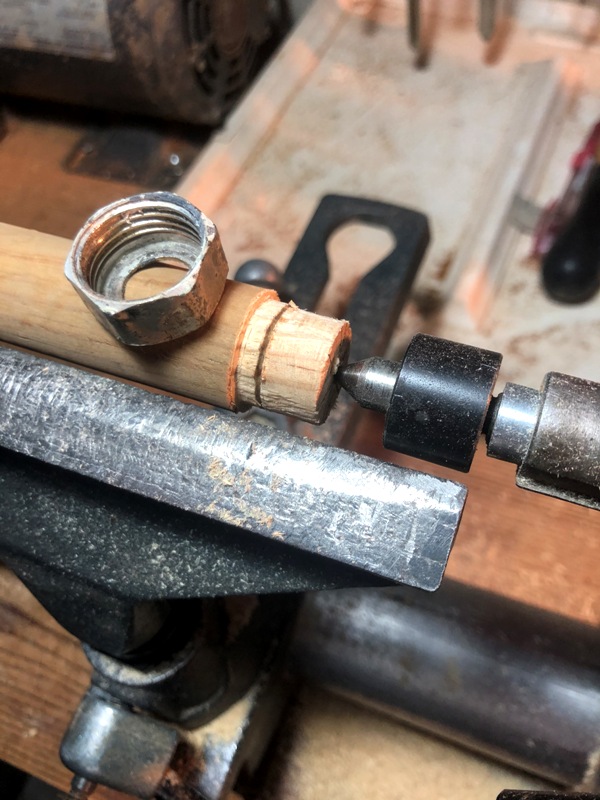

    1. Female knobs. A nut from a flexible toilet hose, a wooden plug, and a type D insert (1/4" x 20):

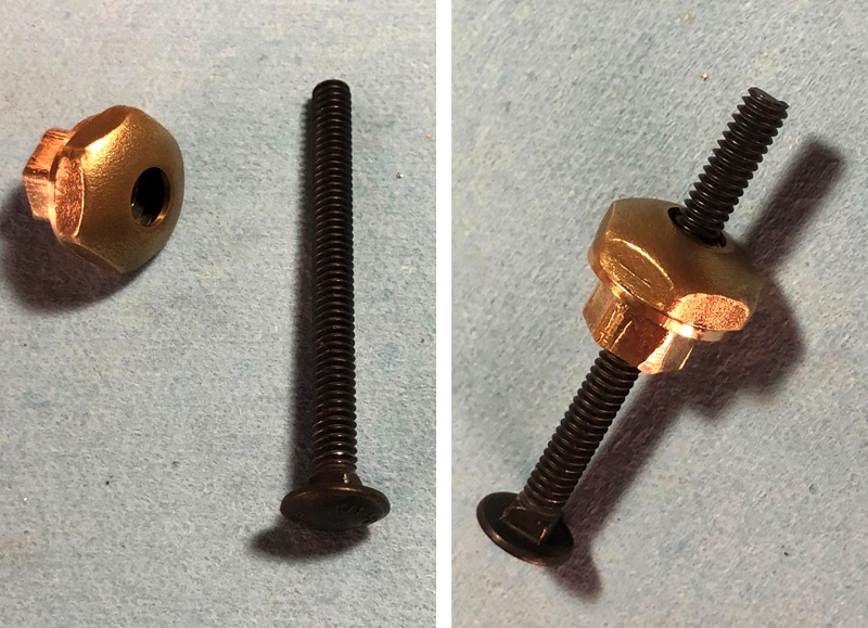

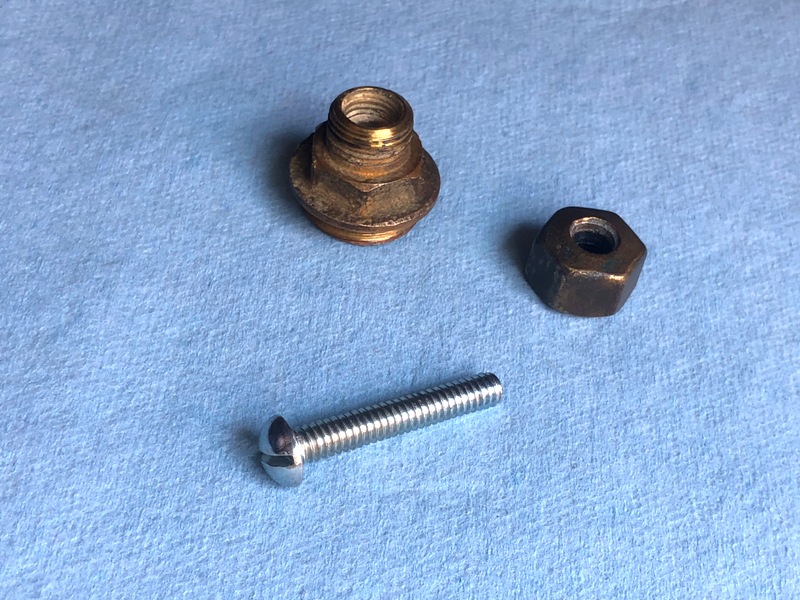

    2. Male Knob. Two matching bronze plumber pieces, a ¼" x 20 round head screw:

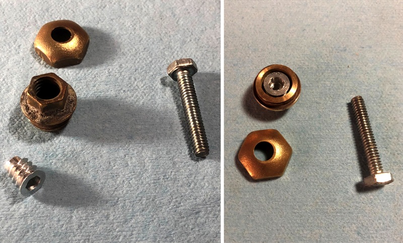

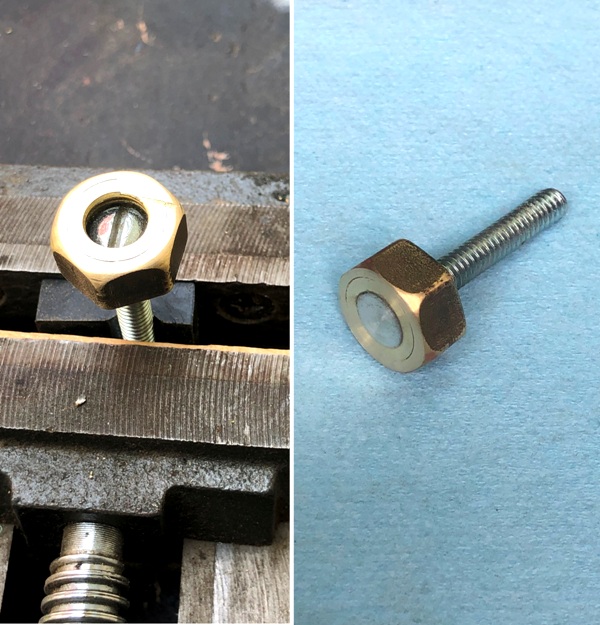

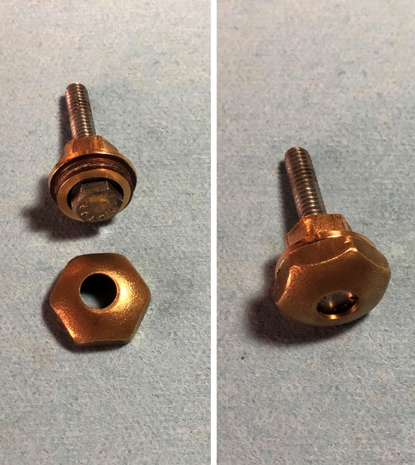

    3. Male/female knob. Two matching bronze plumber pieces, a type D insert (1/4" x 20), and (optional for the male knob) a ¼" x 20 hex bolt:
    Male knob
    Female knob
