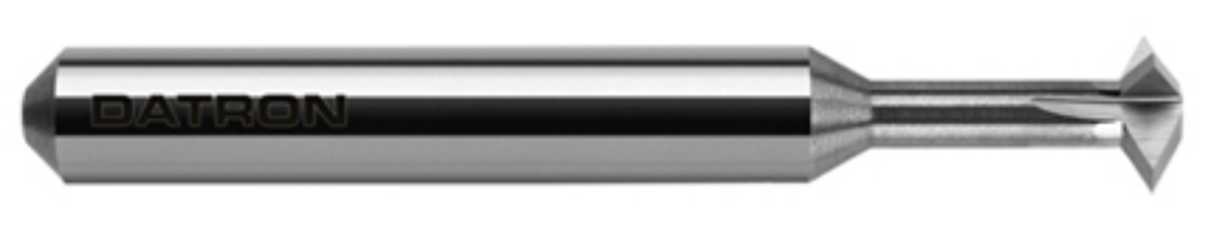

    Thread milling on a CNC machine is a great way to cut threads that are accurate. You can cut either internal or external threads provided you have the correct thread milling tool. This is an example of such a tool. There are other types available. Two things are important, first the diameter of the cutting head must be smaller than the inside diameter of the hole you want to thread if cutting inside threads. The second factor is the reduced diameter of the tool must be long enough to reach the bottom of the thread you want to cut, whether inside or outside. This is a typical mill threading cutter.

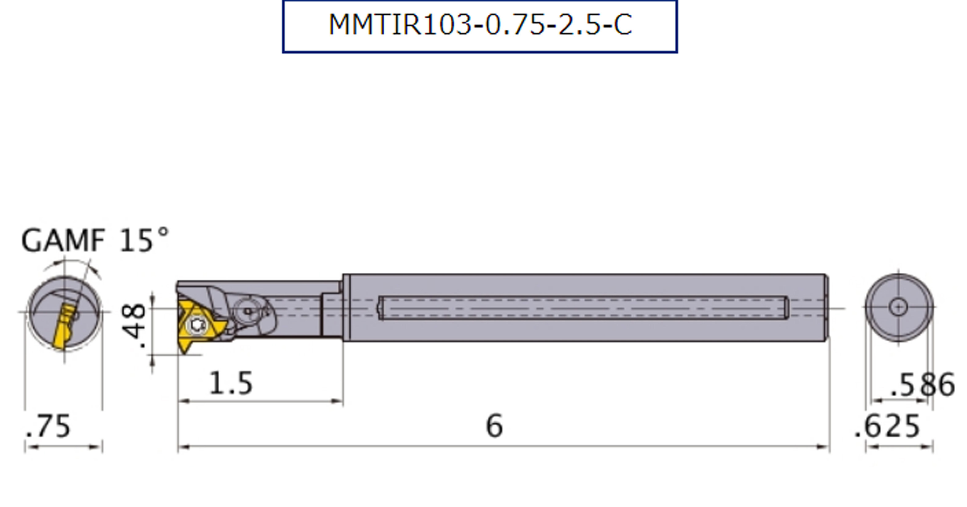

    I made a thread milling tool to accept carbide inserts. I chose a 16IRG60 insert since it was fairly small and could cut a reasonable range of thread pitches (8-14 TPI). The radius of this tool is about 0.48 inch, so it will not work for internal threads below about 1" NPT, but can be used on a variety of external pipe threads.
