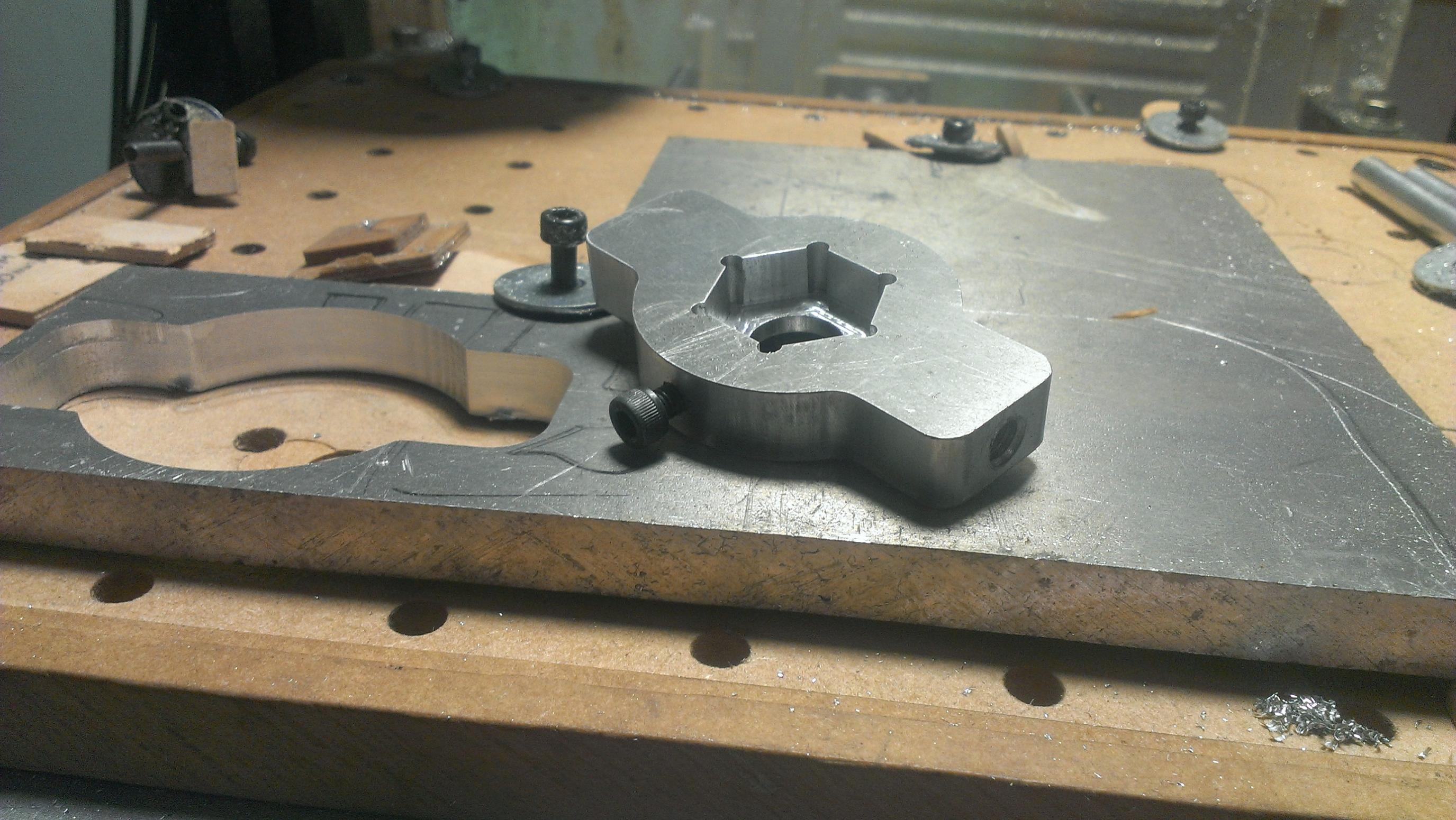

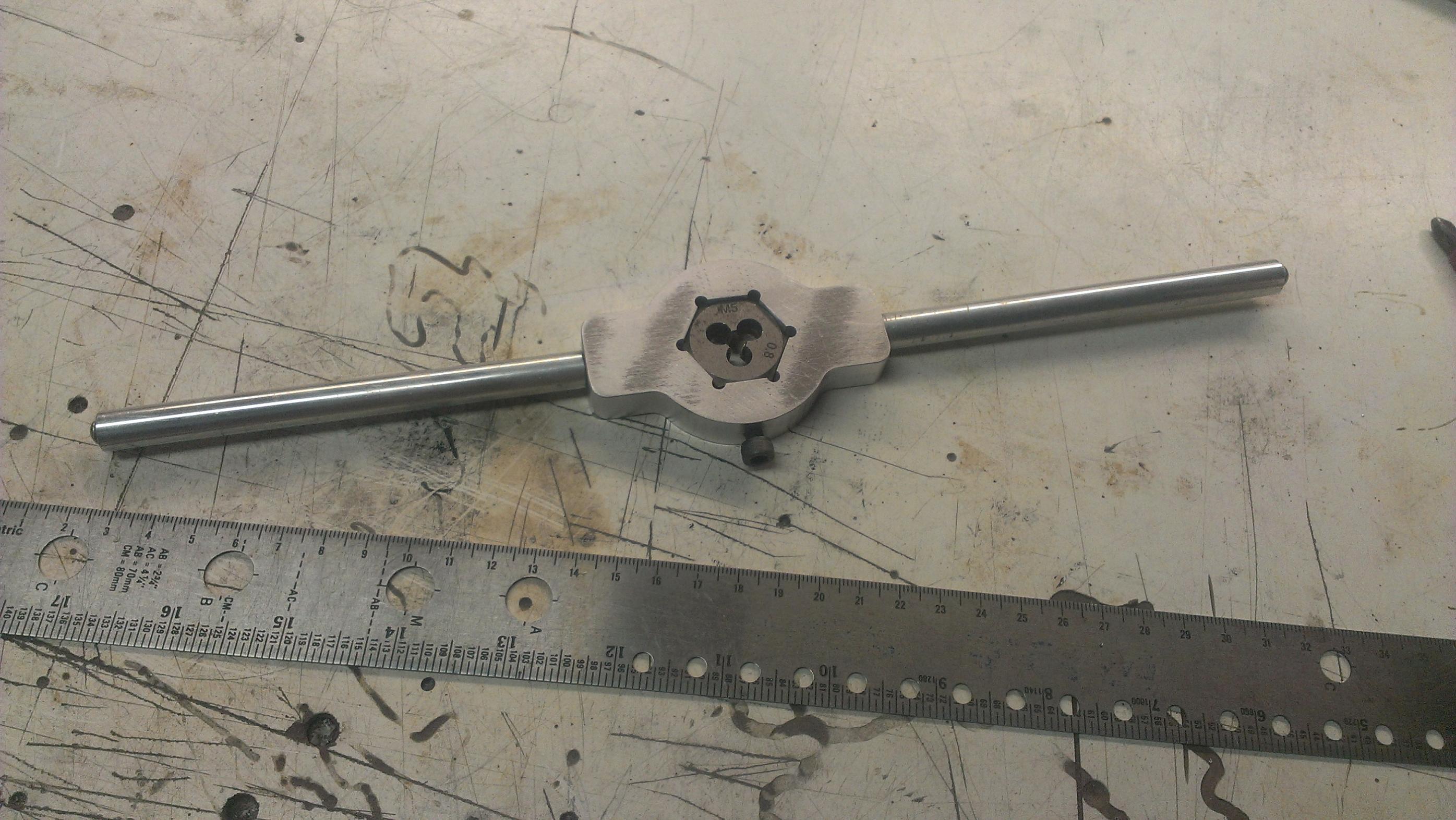

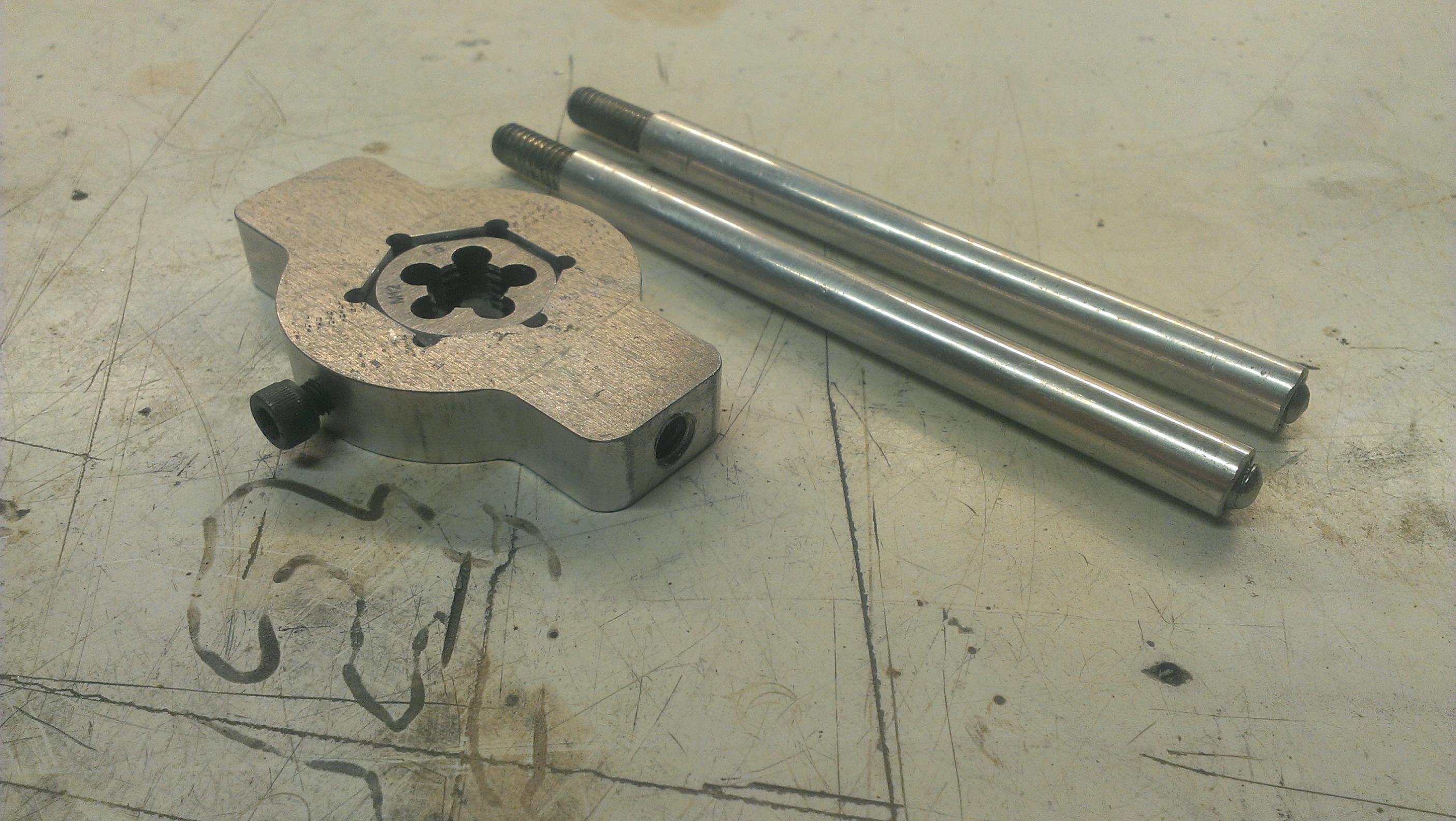

    Here's my take on the humble die holder.
    The holder i got with a cheap tap and die set wasn't too great and once i tried to thread a 10mm bar it split in half.
    So being a cheapskate i decided to just make my own from scrap 6061 aluminium i had lying around.
    Drew up the design in cad/cam and machined it on the cnc. ally was 15mm thick and i cut it out using a 1/8" endmill.
    Can share the dxf if anyone likes, was drawn in vcarve pro.

    Hi, nice, build !

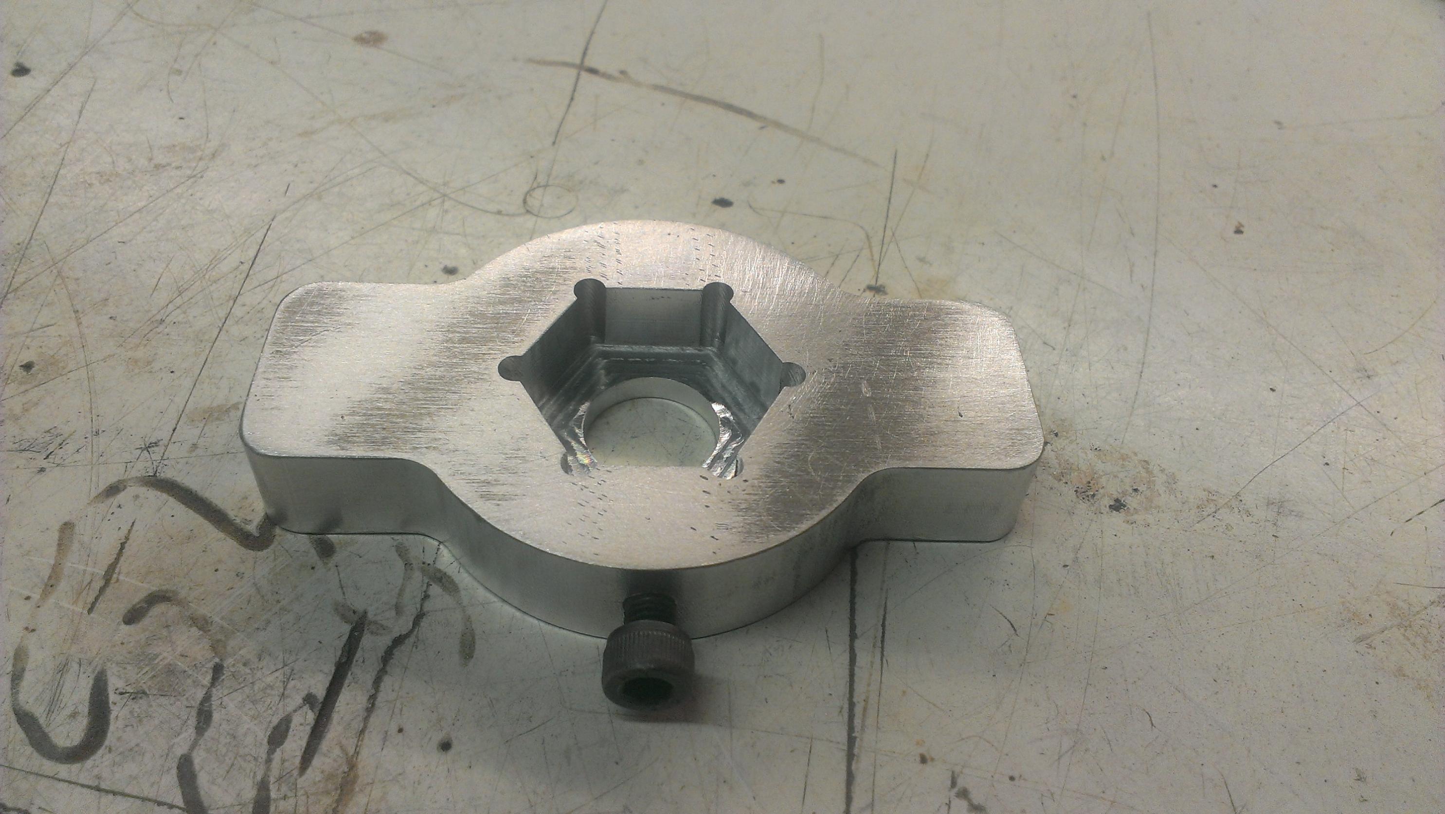

    Just one question, why did you go for an octagonal interior shape ?
    With your CNC, you could have cut it round ?
    Cheers !
    Christophe

    Thanks Christophe.
    The dies i have are all hex shaped so that's why i went with that design.
    edit: i see what you mean, the photos dont show that they are hex shaped dies all that well, at first glance they look round :P

    OK, understood.
    And what about your CNC mill, is it homemade ? On the other thread where you show a photo, the cutting head seems to be pow a wood router ?
    Cheers !

    Yes the cnc is homemade and from mostly recycled materials.
    It is an Ozito 850w router controlled by a SuperPID.
    I built it around 2 years ago and its had quite a workout in those 2 years.
    I will post the cnc up once i find all my build photos

    Thanks DIYer, it was a cheap and nasty set, the holder was poorly cast alloy and didn't take much to fail.
    Here is the dxf for those interested. Its a simple 2d drawing and i used 1/2" 6061 to make it.
    The hex pocket i made 9mm deep and it was all cut with a 1/8" 2 flute endmill.

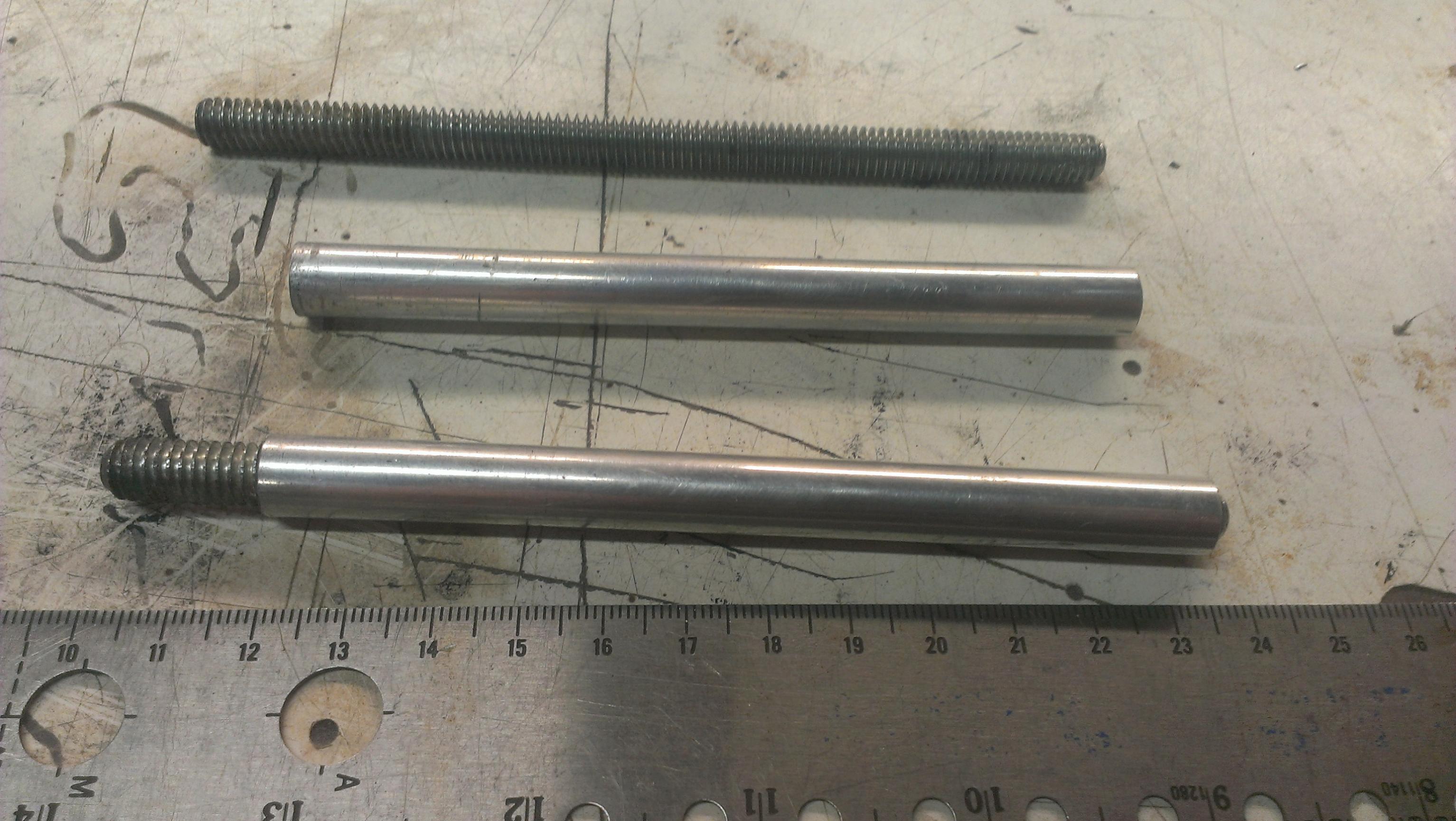

    You could use a thicker material and the handles are just some allthread i had laying around with peices of aluminium tube slid over it.
    Die holder.zip
