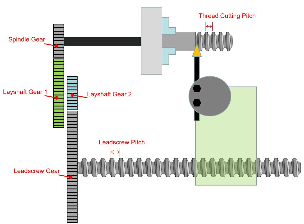

    Just thought I would make a simple online Thread Cutting Change Gear Calculator
    Uses number of teeth on each of the four gears and the leadscrew pitch - works with TPI and mm
    Let me know if it is useful or you need other options or even calculators

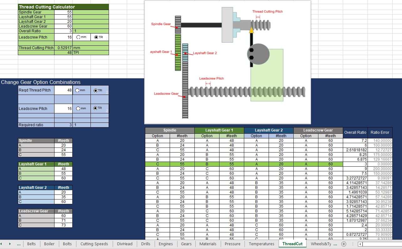

    Hello Johan,
    Thanks for the feedback. Based on this I've added a change gear calculation sheet to my workshop calculations download (free download for all)
    This now has a calculator as per the online page.
    Plus a calculator where you enter the thread pitch you want to cut, the leadscrew pitch and then 3 gear options for each position on the gear train. This then calculates all combinations, highlighting the exact matches green and any with <2% ratio error in amber.
    I need to perhaps write some more notes, but hope this helps.
    Best regards, Nigel

    A snapshot of the worksheet here:
