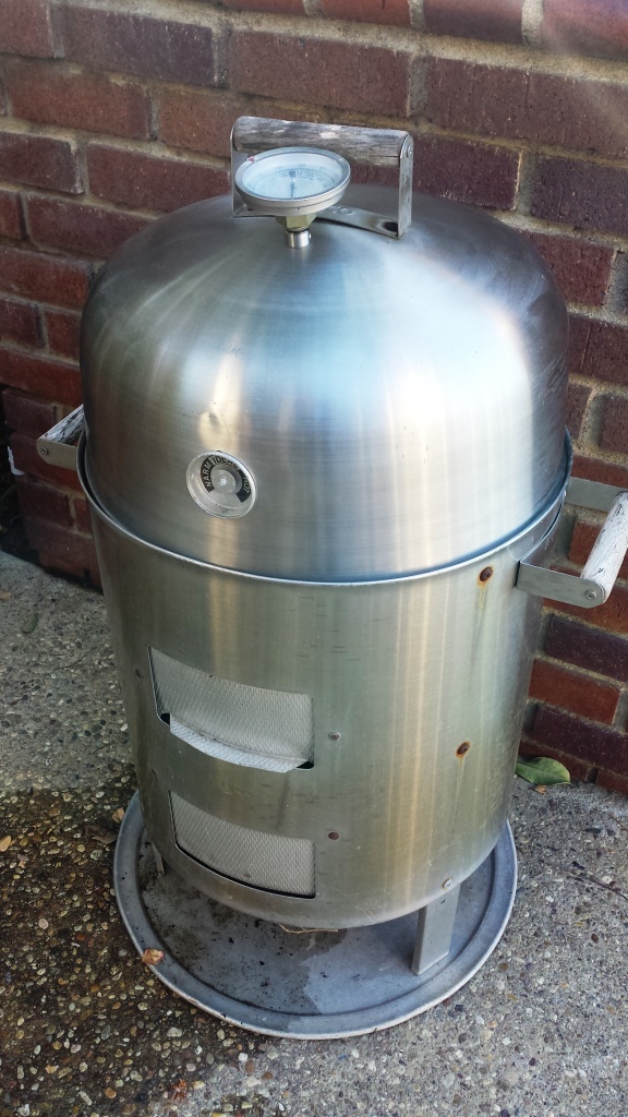

    I have an electrically heated smoker I have used for almost twenty years. I like the electric version because it is easier to maintain a constant temperature (unless there is a strong wind with a wind chill factor) provided there is an accurate thermometer to monitor the smoking temperature.

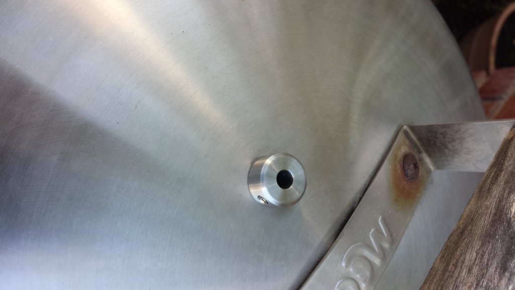

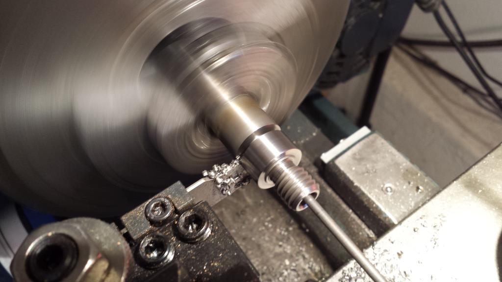

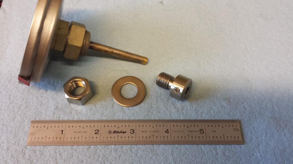

    Years ago I drilled a small hole in the dome above the smoking grates for a thermometer designed for another brand of smoker. It worked well but had to be removed each time I removed the hood to prevent it from falling out and breaking. I made an adapter with a set screw from 303 stainless steel rod for holding the thermometer. The adapter seats into a 1/2" hole the hood and has an extended boss, short threaded extension and secured with 1/2X13 nut. The thread on the adapter was single point chased on the lathe.
    Shown below is the adapter in place on the smoker hood and photos of the part.
    Thermometer holder adapter for smoker hood-thermometer-holder-adapter-installed-into-smoker-hood.jpg
    Electric smoker with dome temperature thermometer installed
    Thermometer holder adapter for smoker hood-thermometer-holder-adapter-smoker.jpg
    New 303 stainless steel thermometer holder added to top of smoker dome
    Thermometer holder adapter for smoker hood-thermometer-holder-adapter-parts-smoker.jpg
    The 303 stainless steel thermometer holder is threaded 1/2-13 and uses a stainless steel nut and washer from the local hardware store. A 8-23 stainless steel set screw holds the thermometer is place but a knurled knob with an 8-32 threaded rod could be substituted,
    Thermometer holder adapter for smoker hood-parting-off-303-stainless-steel-thermometer-holder-adapter-smoker.jpg
    Photo of completing the machining of the thermometer holder. Note the raised boss area fits into the thin sheet metal dome and prevents the holder from moving in the 1/2" hole in the dome.

    Unaware of composition or materials inside stem of such a thermometer; can they be shortened? Old high precision machines were fitted to read temperature of spindle housings, supposedly to calculate displacement by expansion. Maybe.
    I'd prefer monitoring temperatures, to determine when it's warmed up. All I've seen, have stems of excessive length. Sure don't want a thermowell sticking out 6''!

    Smoking meats is more of an art than a science. I also use an electronic probe in the meats as a secondary measurement but ideally, the air temperature above the meats should be maintained at constant temperature just slightly above 212F (100C) for an extended period of 4 to 12 hours. This smoker uses a liquid (you name it and it will proably work) in a lower pan that slowly purrs away simmering the liquid in a deep dish pan and you don't want to boil the mixture away too quickly. This is why I prefer the electric coil to generate a slow cooking heat to smoke the wood and provide a constant temperature, and other than occasionally adding more wood chunks and liquid, the smoker can be left on its own for hours. The biggest unknown is any wind chill factor on the steel skin of the smoker that will extend the smoking duration. However, using the just above boiling temperature technique means you can extend the smoking period by hours and not ruin the meat.
    This thermometer extends 2" below the hood. I test bottom 1" of the tip once a year in boiling water to see if it is still reading within a couple degrees. So far if keeps on working correctly within a couple of degrees.
