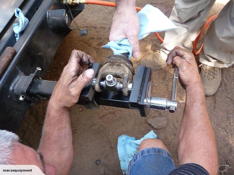

    Personally I would mount it to a trailer hitch bar arrangement, as pictured below, and I would mount the hitch socket permanently on the top or side of the post so that it is well out of the way when the vice is removed. Working in a body shop you probably have old trailer hitches lying around, or can fabricate the bits you need. Vice pictured is called something like "D-Vise" and is made in USA.
    It might also be easier to fabricate a vice stand from an old heavy wheel rim and a length of pipe. You will then be able to 'roll' it to anywhere in the shop and not run the same risk of having someone drive into it, as if it were to be fitted right in the doorway.
