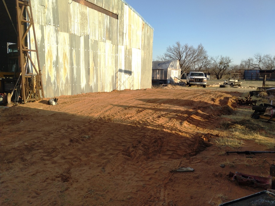

    I don't know if this is going to be a temporarily permanent or a permanently temporary addition to the back of my shop since it is right where I want to eventually set my American lathe. But for now a paint booth is going to be set up inside of it.

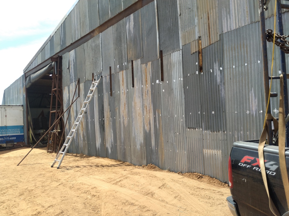

    I started off by laying down 50 cu yards of the red clay dirt
    Then anchored some supports to the East wall

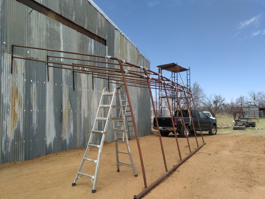

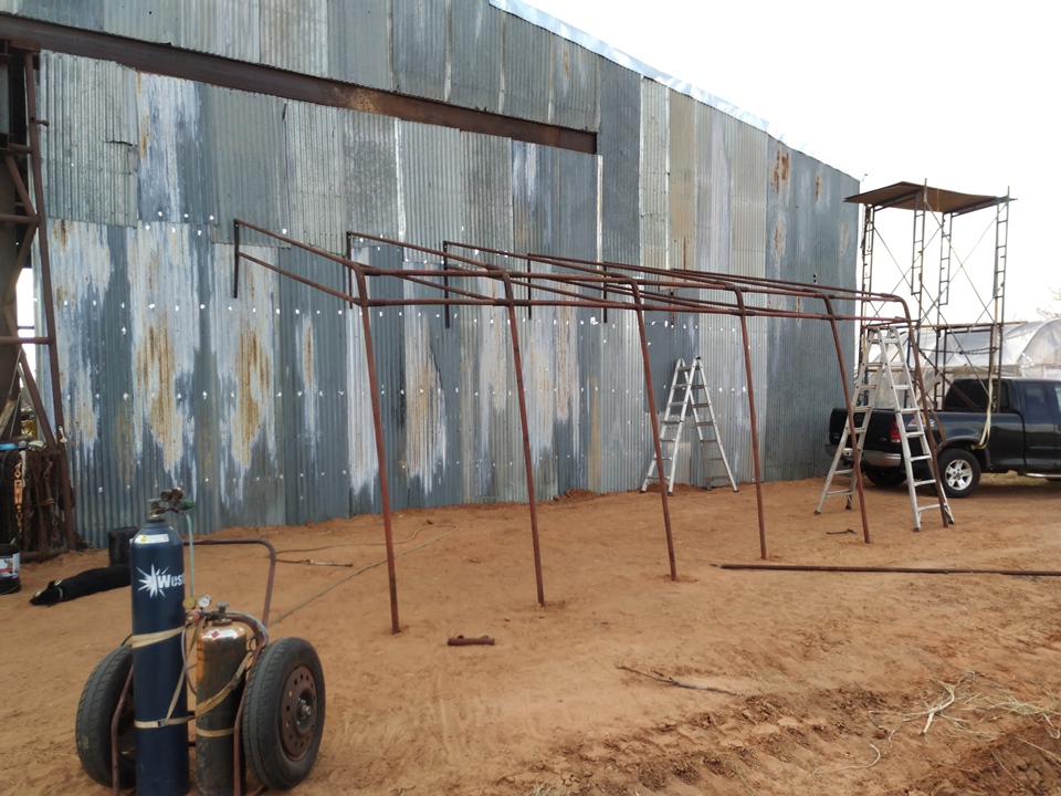

    Then started installing the structure

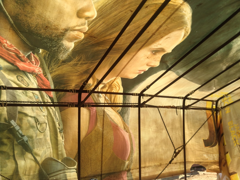

    That is what I will be covering this frame work with I have a 17x48 vinyl which will cover the top and both ends plus half way down the side, the remainder of the side will have a 6 mill clear plastic stretched over it to allow light in, one end will be left as a flap for entry. The paint we will be using on the things we will be coating required about 50% humidity to cure properly so before we hang anything from the overhead pipes we will wet the ground with a few hundred gallons of water allow it to soak in the tent itself will serve as a huge humidor chamber which with our normally too low humidity the moisture in the ground should be sufficient to raise the humidity enough for our purpose

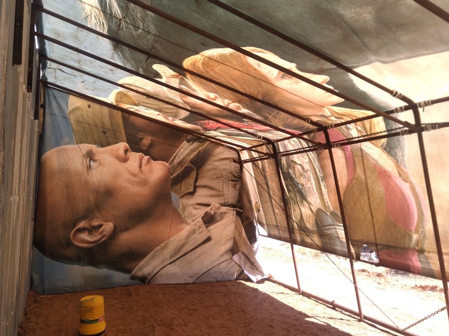

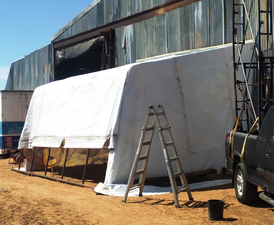

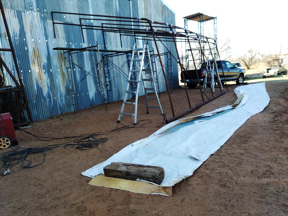

    I was hoping to get the billboard tarp on the frame today but the wind did not cooperate.
    Trying to wrestle and secure a nearly 900 sq ft tarp weighing 150 lbs while battling a 25 MPH wind with 35 MPH guests my myself is not my idea of safe fun while on a scaffold. Tomorrow the wind is supposed to be much calmer and out of an different direction so I enlisted a helper

    My helper showed up around 9 Am this morning I was hoping he would get here by 7:30 but you don't always get what you pay for now days. Anyway by 11:00 we had the tarp on the frame, and I cut him loose.

    Kinda looks like the Sistine Chapel...
    The girl is kind of cute isn't she
