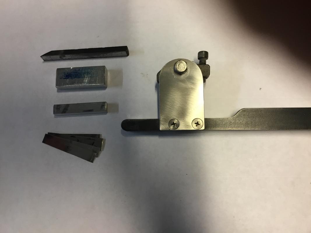

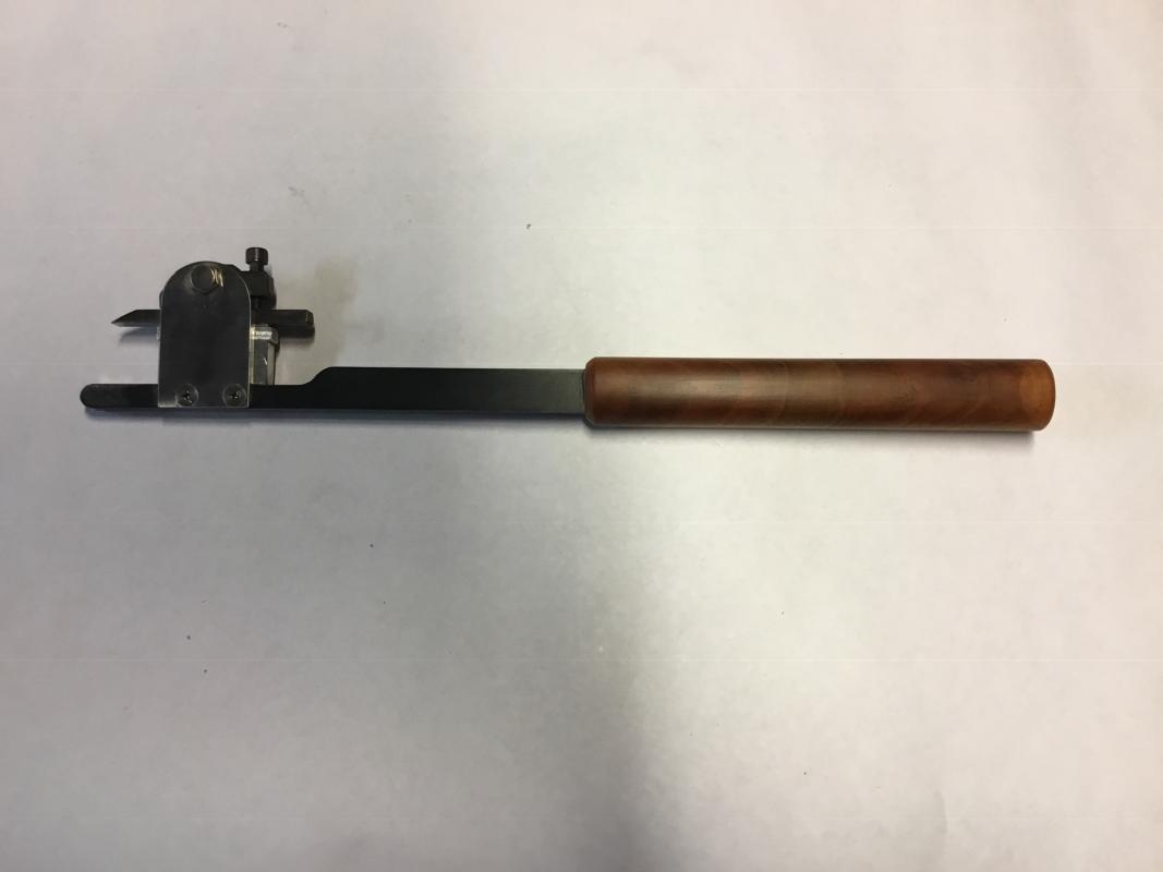

    I make handles for a maple syrup equipment co. 150 to a batch and repetition is not my thing so I made a tool to make consistently sized tenons. The cutter is from a hanger queen plow plane and I just vary the shims to a hive the desired size. The blade is 3/8 wide so three passes on a 1 inch tenon and done.Tenon sizer-f067e0d6-e177-4e51-ac59-830e44d23494.jpgTenon sizer-10b7d584-a82c-4b84-909b-5f2455d03e45.jpg
