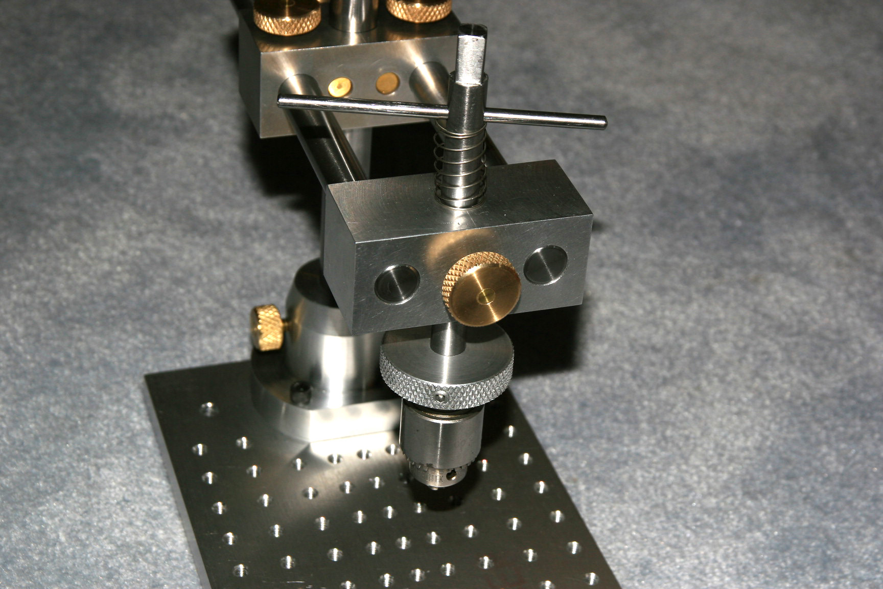

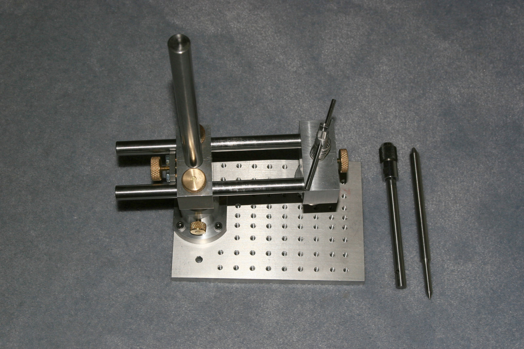

    Inspiration for this one is from Projects In Metal book 3. It was not meant to be an exact duplicate
    but rather a build using materials that I have on hand.

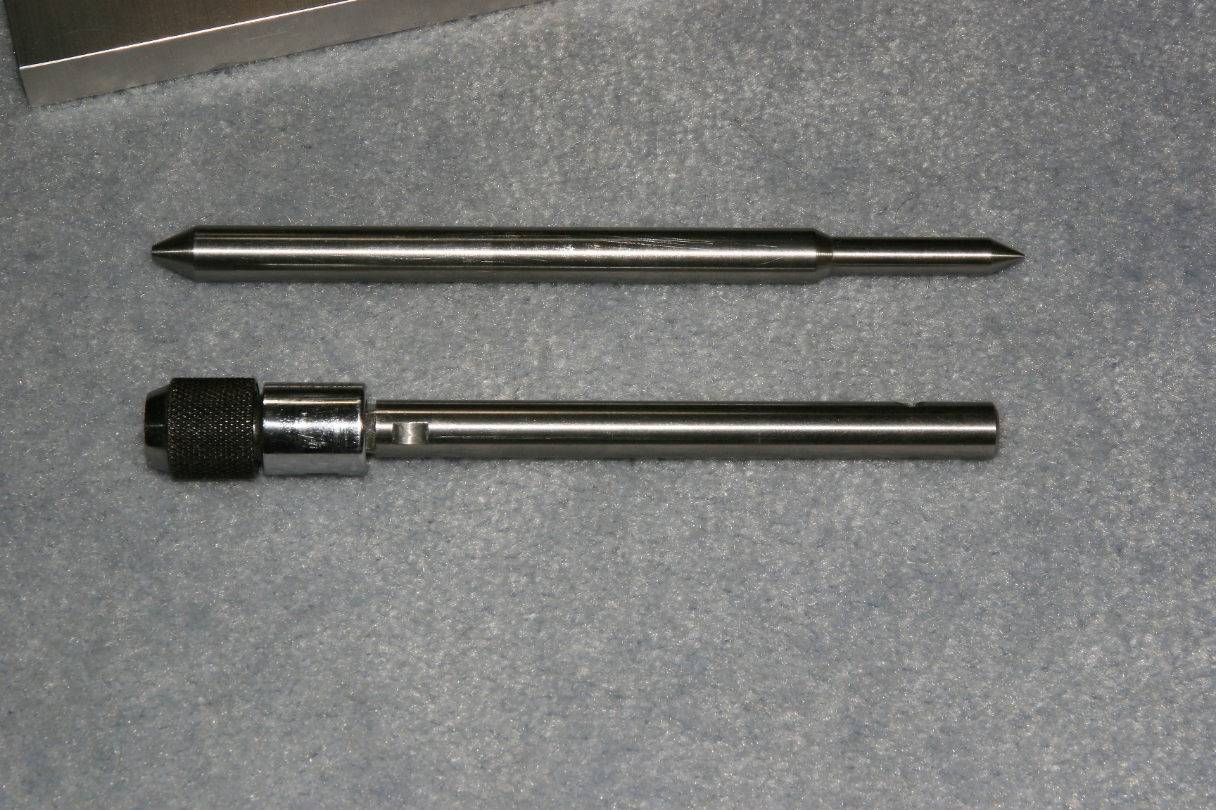

    The tapper includes two tapping spindles at present and more could follow. Either spindle can be driven
    by the tommy bar or the knurled aluminum knob.
    The knurled knobs were made from round bar stock and some flat head screws I had on hand.
    The cotters are made with 3/8 aluminum and differ from the method used in Projects in Metal.
    Cotter details are here:
    http://www.homemadetools.net/forum/m...rt-shaft-71576
    In addition to the two spindles for tapping there is a hole locator also. It should work for most
    material thicknesses with the two ends. If not then I will just make another.

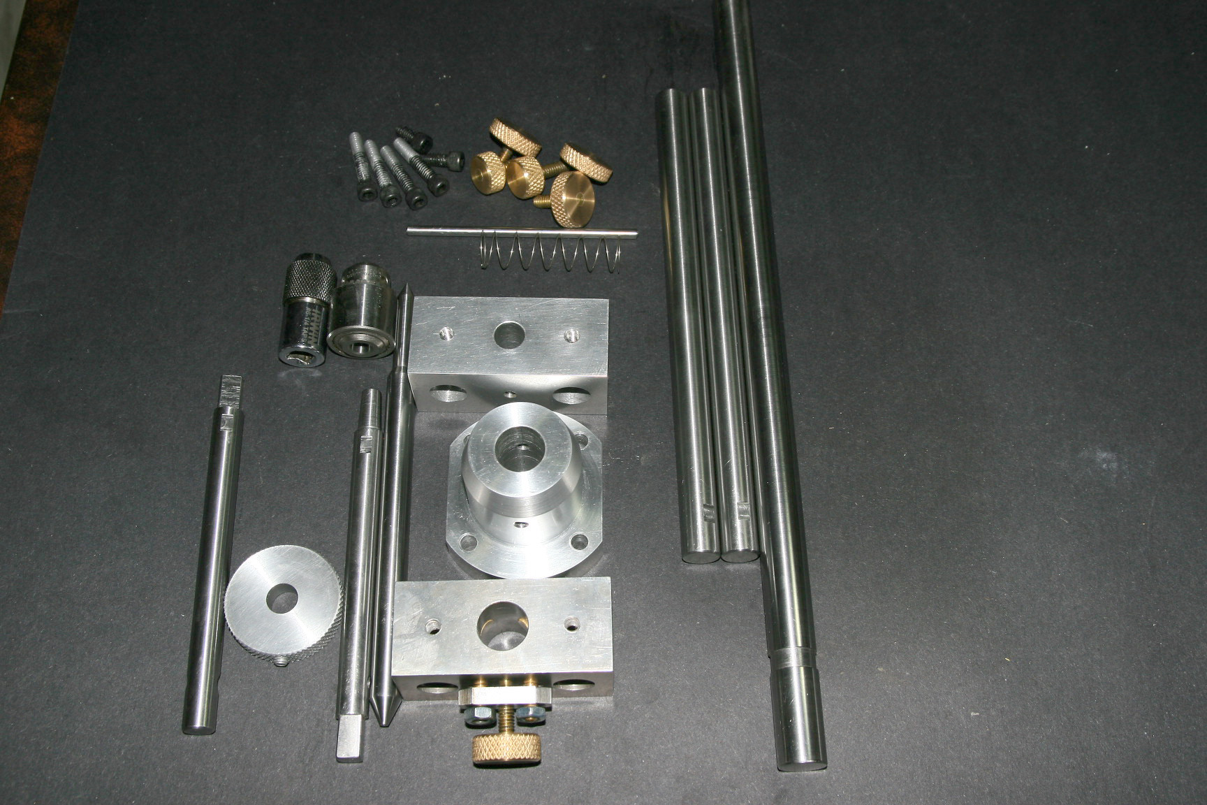

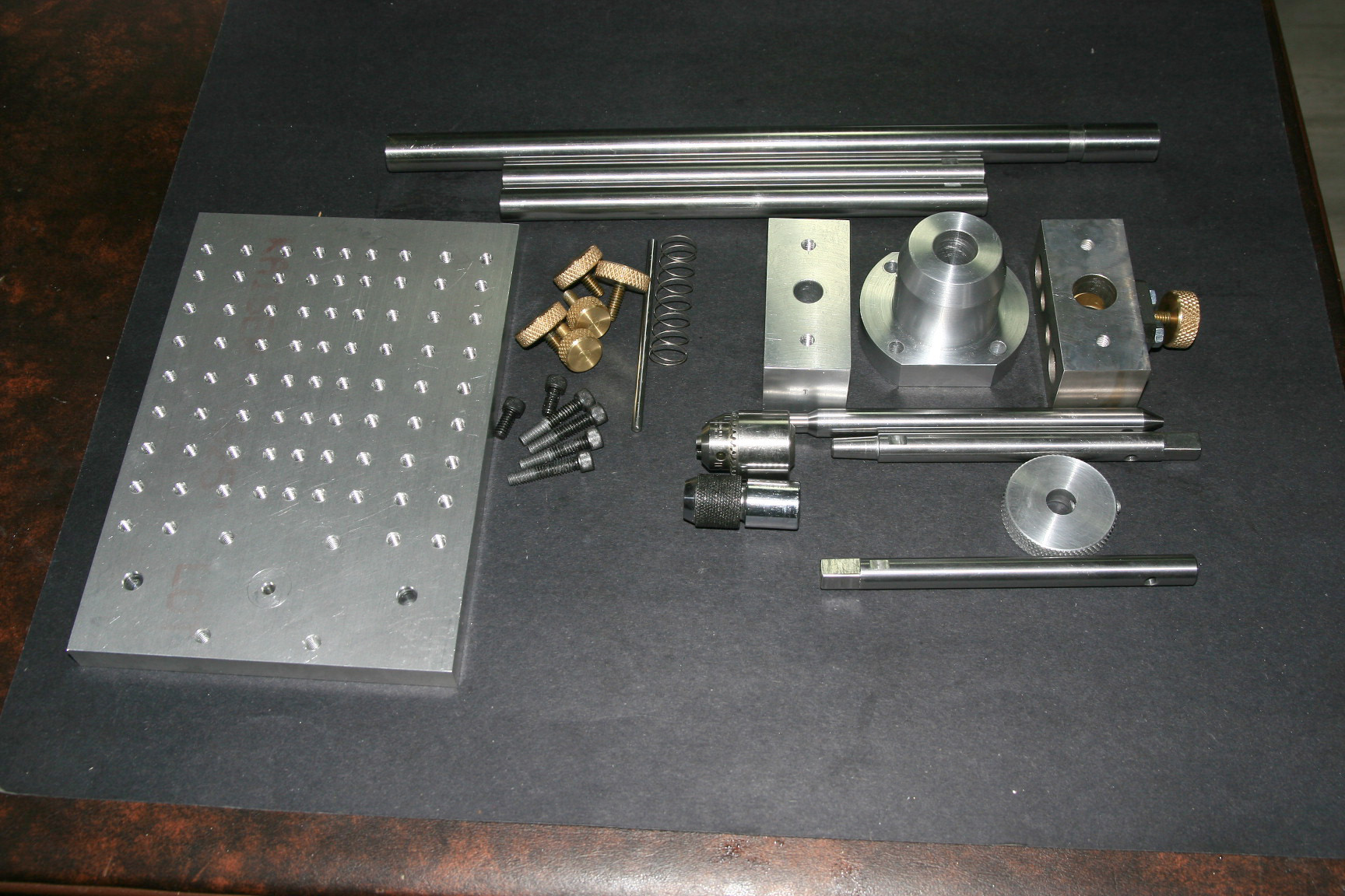

    The Post is 14" long 3/4 inch in diameter drill rod. One groove helps retain it in the column support with
    the addition of two locking knobs.
    The Rails are 5/8" drill rod by 9 1/4" long.
    Spindles are 1/2" diameter drill rod and vary in length.
    I still need to wind a new spring for the spindles, the one from stock is not strong enough.
    The base plate is 6 1/8" x 9" and 5/8 inch thick aluminum plate. The only steel parts are the parts from drill rod.
    Drilling 72 holes can be fun if you have a power tapper. Check out this thread for an inexpensive power tapping system.
    http://www.homemadetools.net/forum/t...ut-close-71605
    Cheers, JR

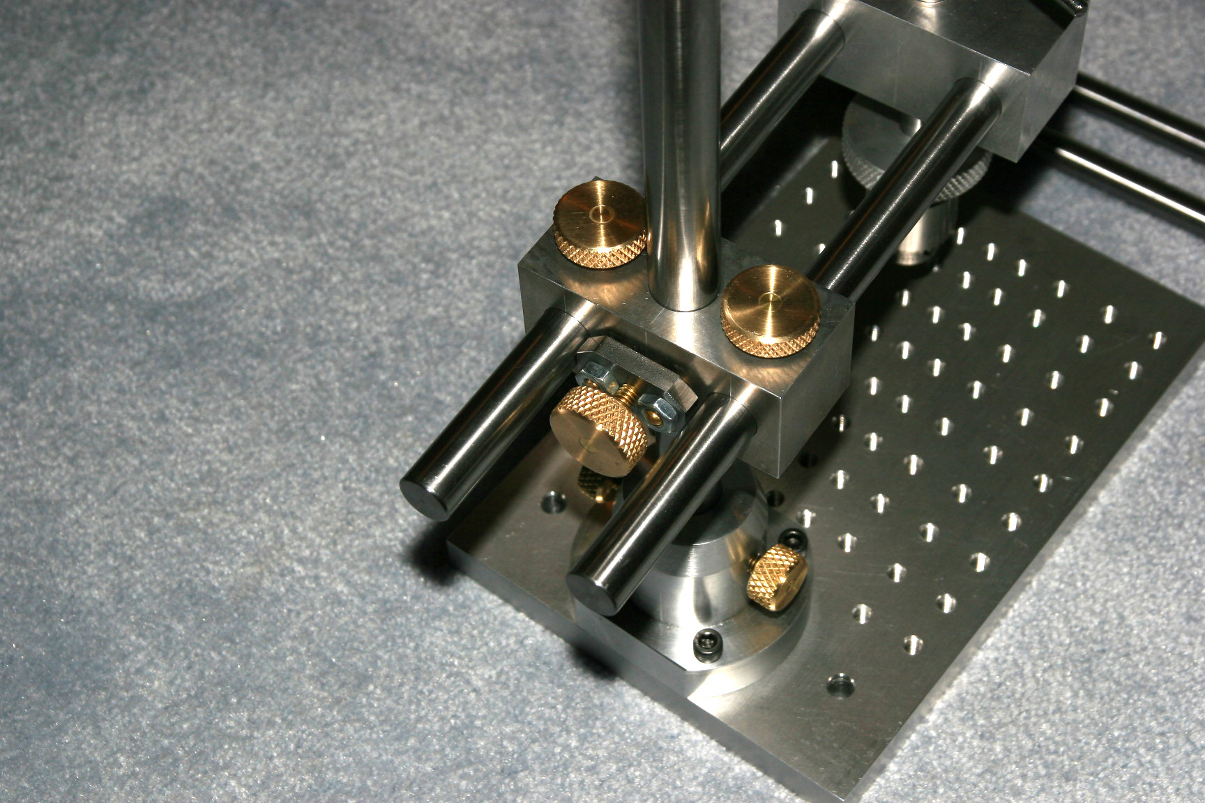

    Great looking tapper! I do have one question that may be related to my inexperience. What is the "jam" plate on the vertical adjustment screw for?
    Dave

    Hi Dave and thanks for you comments. The plate in addition with the knurled knob are the locking/unlocking
    mechanism for the two "cotters" that lock the horizontal rod assembly to the vertical post. You can get a better idea
    of the system in this post:http://www.homemadetools.net/forum/m...rt-shaft-71576
    You can see the cotters have threads on both ends. The front threads were removed after the 3/4" diameter
    hole was drilled thru both of them. The forward threads were only needed to get the cotters drilled. The yoke or
    jam plate will pull the cotters tight when the knurled knob is tightened.
    Cheers, JR
