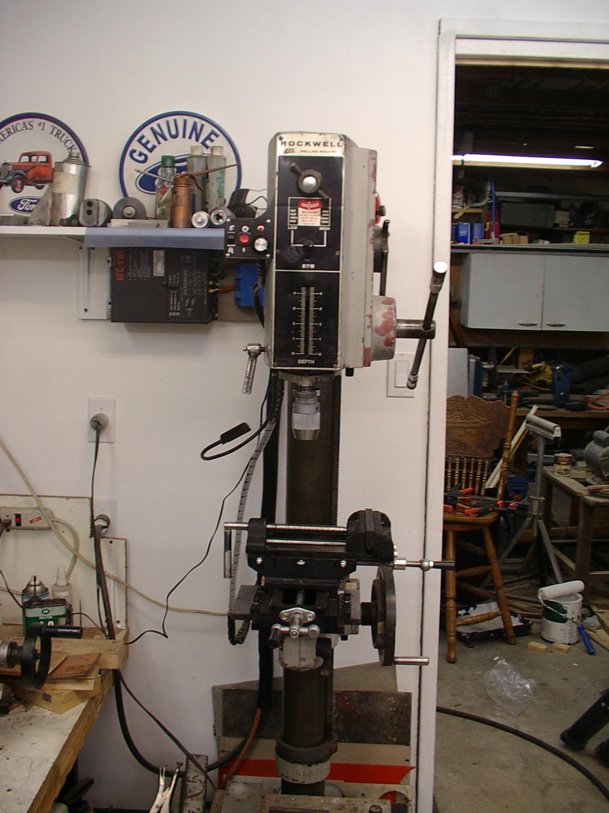

    I use my cordless drill to tap down to 6/32 I can go smaller in my drill press, but then my drill press is 3 phase variable speed and reversible. I have a set of drill/taps that would be perfect for tapping a bunch of holes in plastic. Drill and tap with one bit. Also, I love the spiral point taps for tapping under power.
