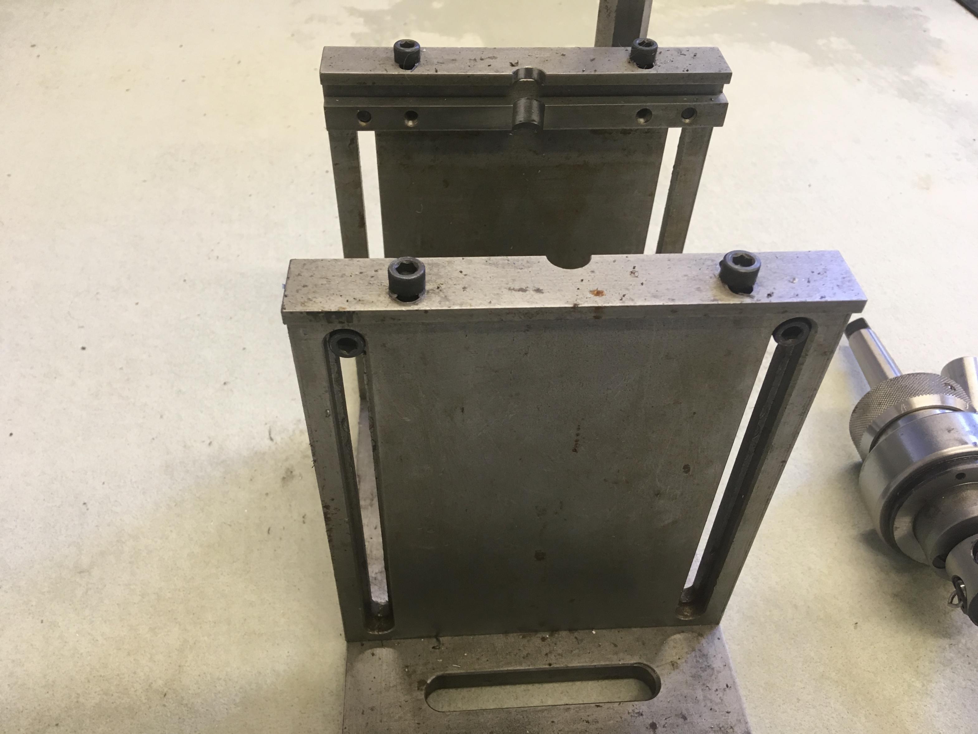

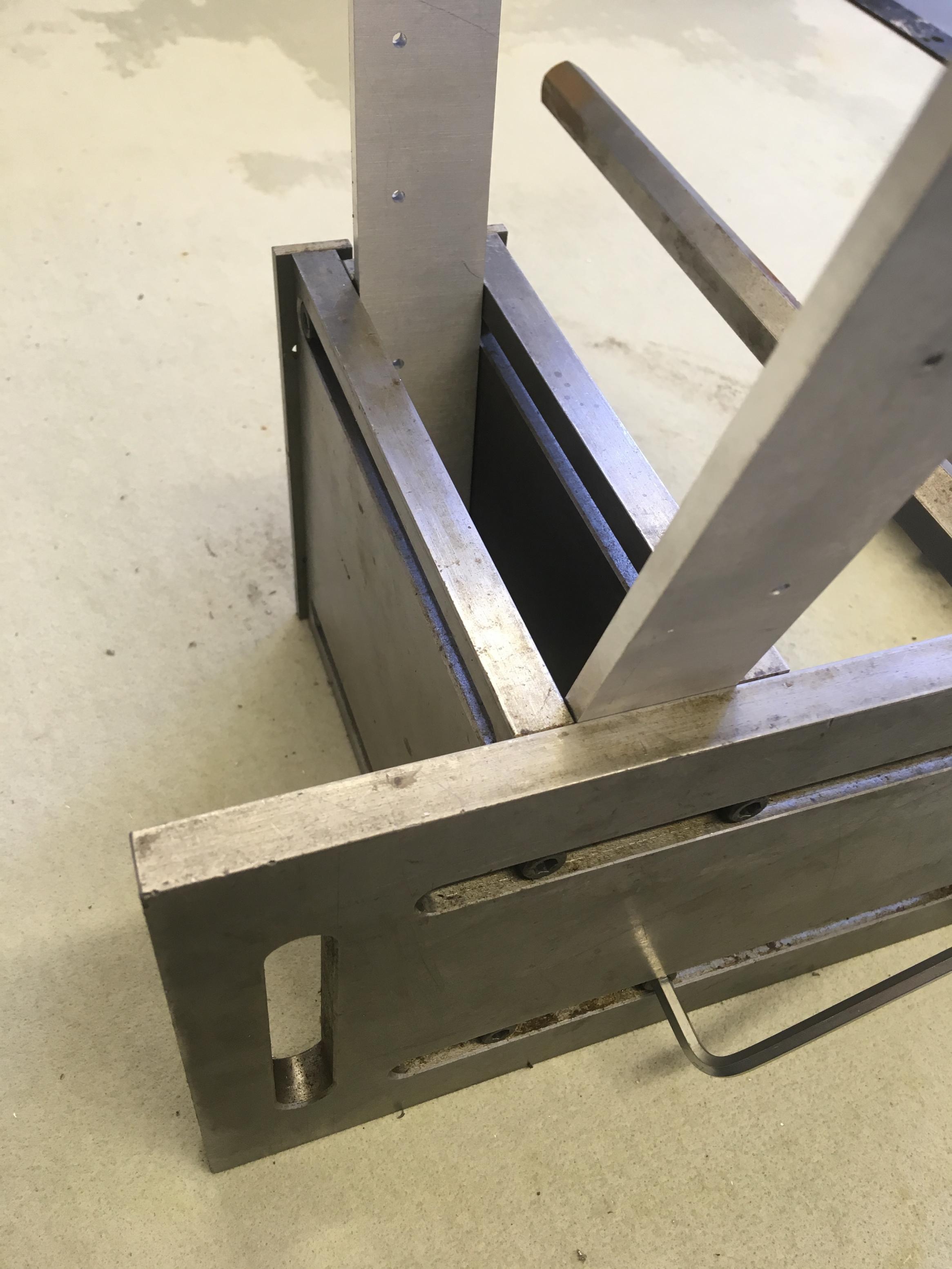

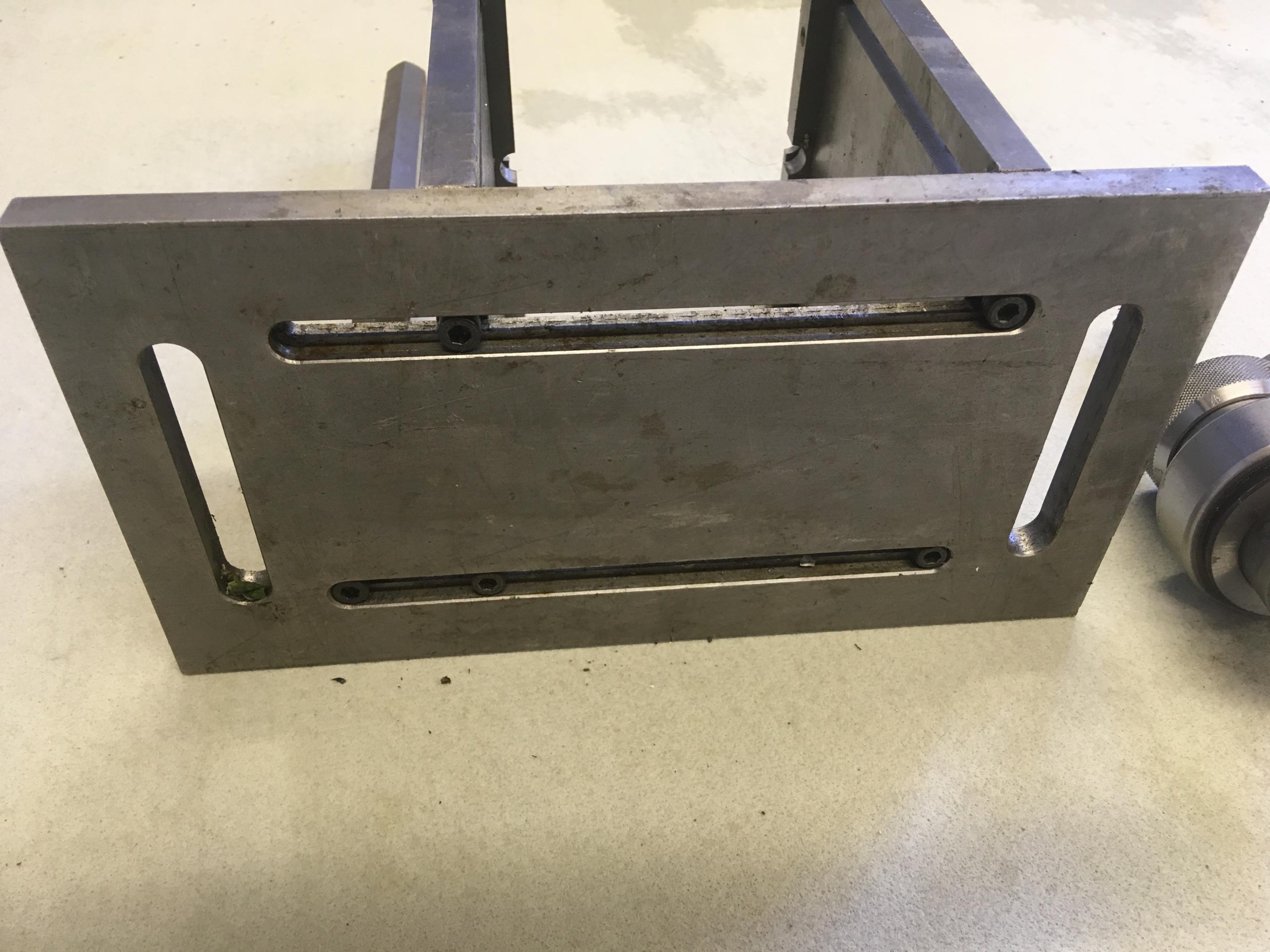

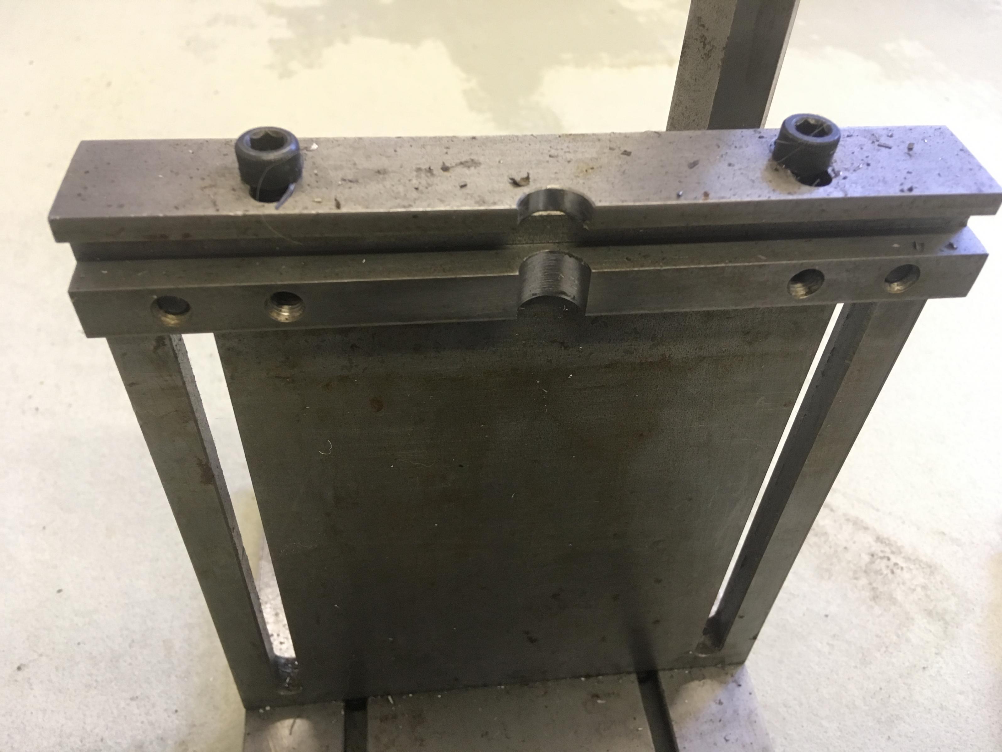

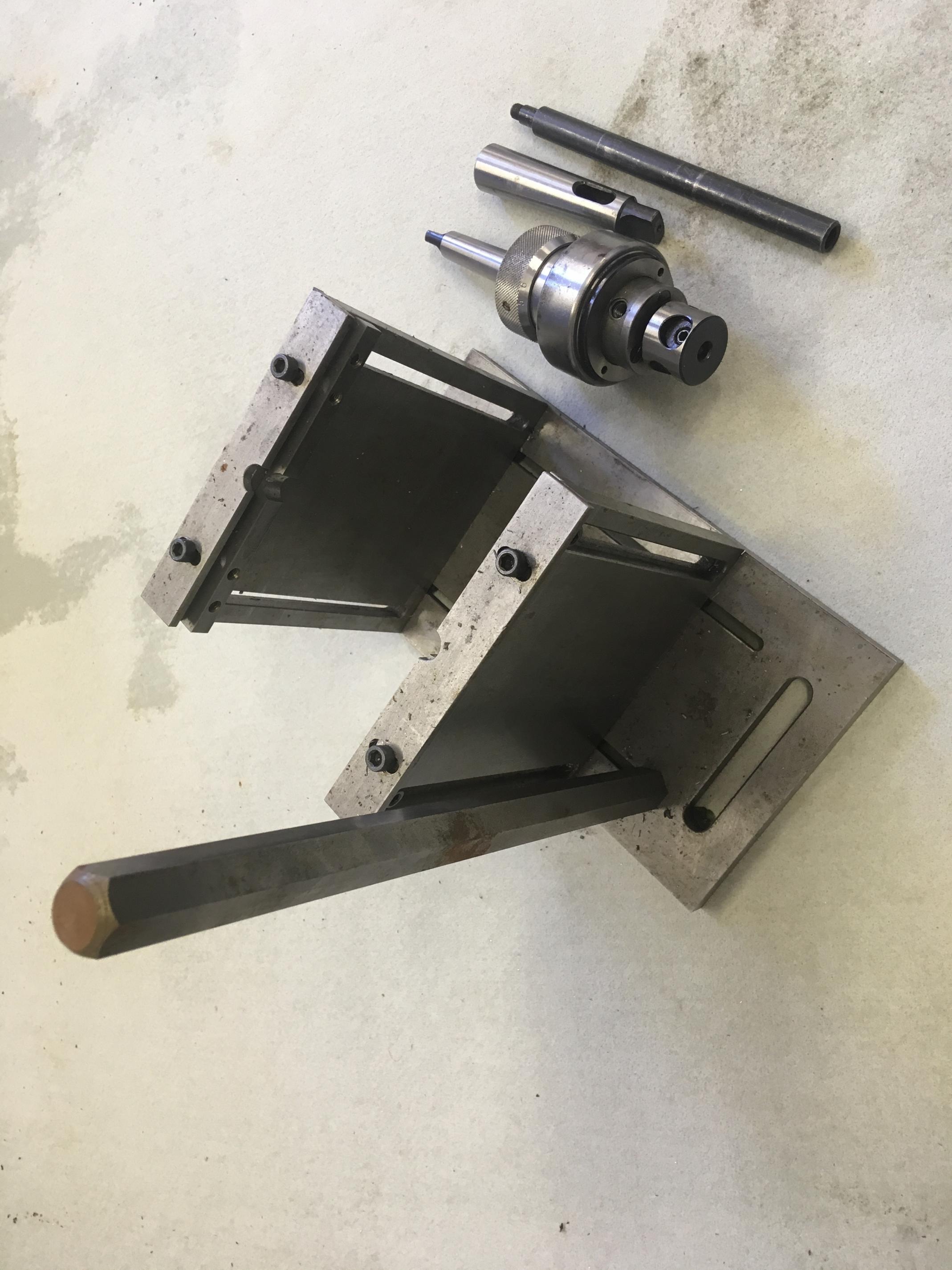

    Hi All
    This is an adjustable tapping fixture, which I made to use in conjunction with an auto reversing tapping head. The idea is to set the work-piece so it is supported and held in the fixture but is easily slid within the fixture. The fixture is then, positioned under the drill spindle and bolted to the table and each hole in that plain, can be tapped. (The video should clarify this).
    The clutch on the tapping head can be set to avoid breakage. To reverse the direction of the tapping head you simply lift the quill upwards, which reverses the direction of the cutting tool without having to switch the machine off or change the motor direction. The hexagon bar acts as a stop to prevent the main body of the tapping head from rotating.

    Tapping fixture and auto reversing tapping head-img_1760.jpg setting the work-piece in fixture

    Thanks homeengineer. That is a nice fixture for the tapping of small parts.
    I was trying to come up with something along these lines that would work
    for various size pieces and you have a great solution. Looks like it would
    also work for drilling and countersinking or chamfering holes.
    Cheers, JR
