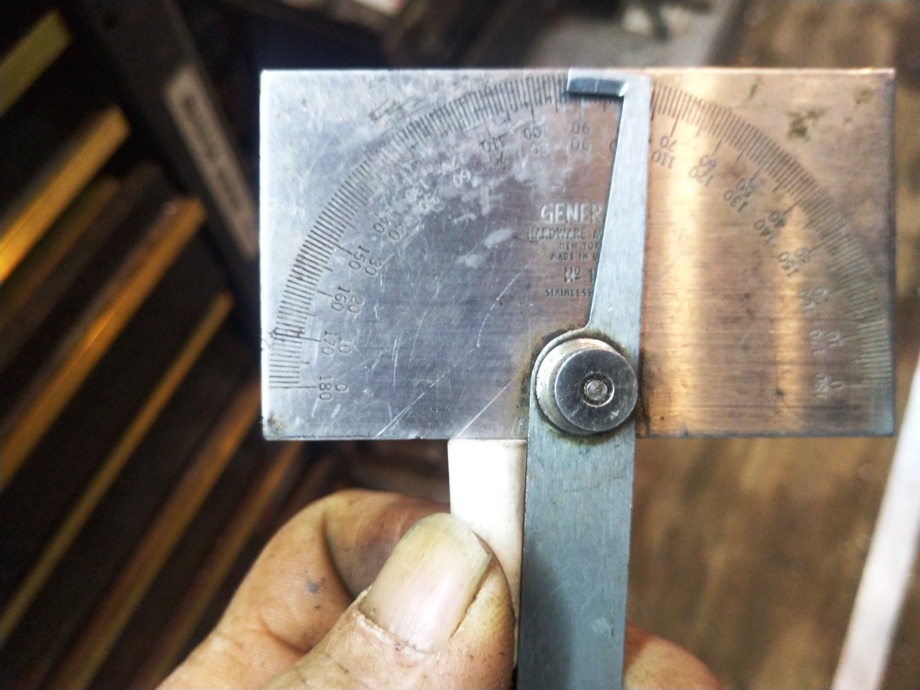

    I don't normally use the sides of the flutes of a drill bit to profile a hole, nor to I condone the practice. But today I found myself in need of drilling a tapered hole to 3°ish, through 1/8inch thick brass, instead of drilling a straight hole and running a small boring bar through it to make the angle I decided to just taper the flutes of a drill bit instead. To do this first I checked the side angle of the ceramic sand blast nozzle with a protractor

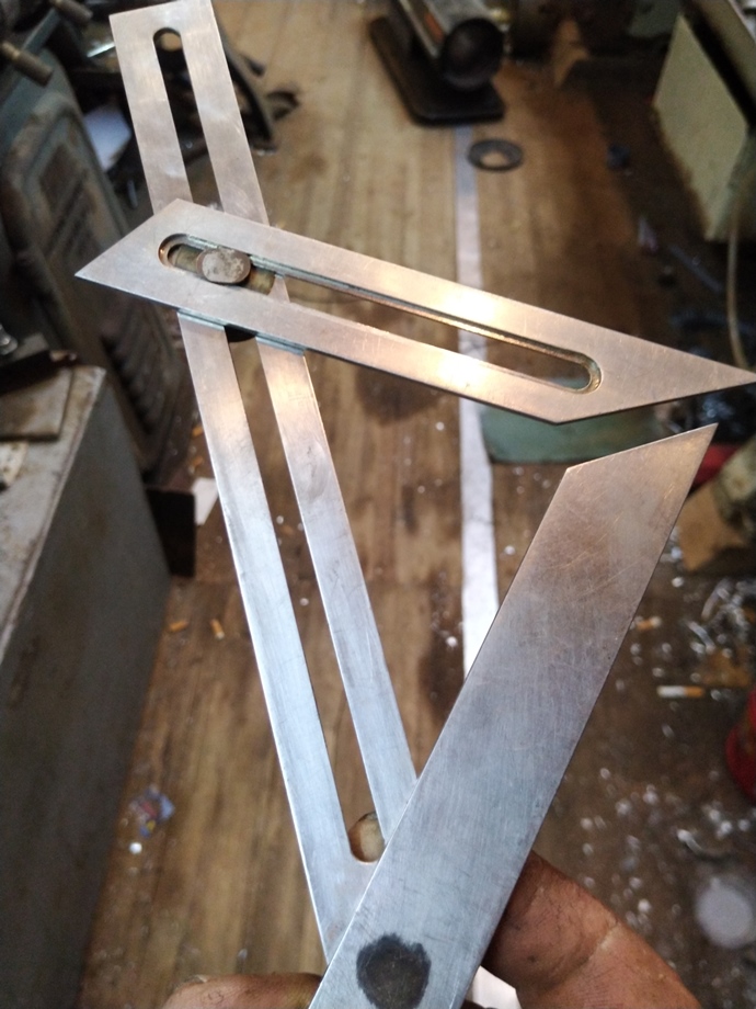

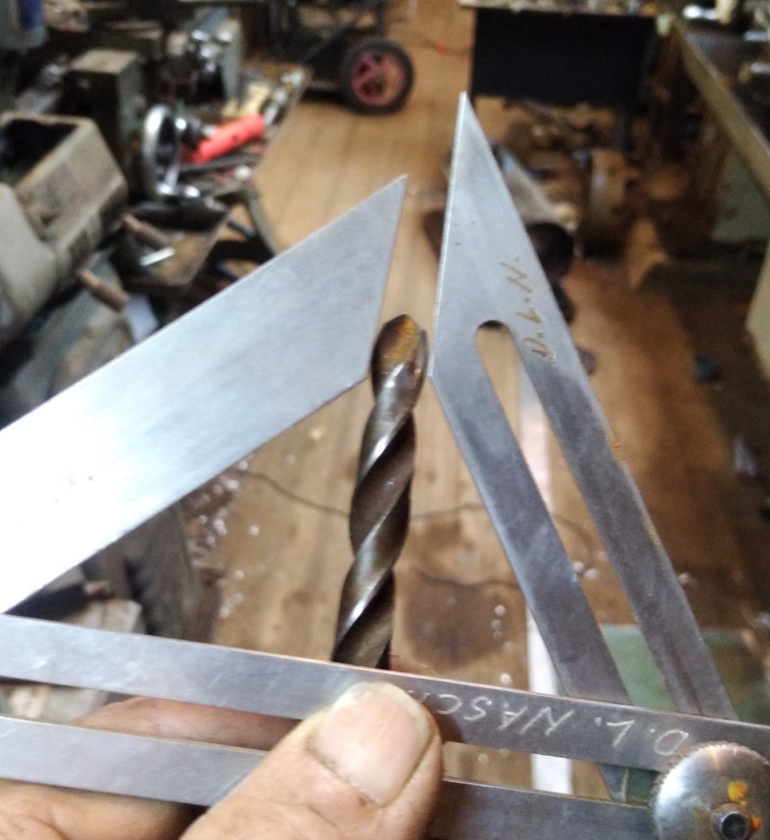

    Then set both sides of my double combination bevel gage made by and given to me by one of my students of bygone years.
    Obviously not the best way to check the angle of the flutes but remember this only had to be an ISH angle

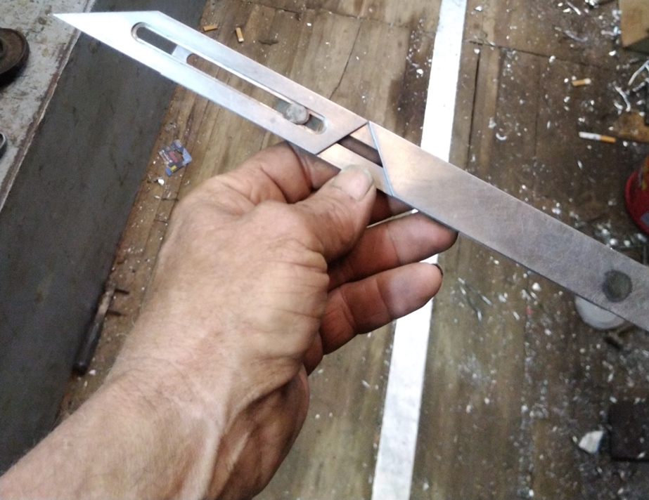

    the Bevel gage is patterned after the LS Sterrett #49 except it is longer and closed on both ends I believe it is actually a higher quality than A Sterrett if that is even possible

    That double combination bevel gauge looks like a nice tool to have. Would you care to post some dimensions and angle sizes? And perhaps a rough sketch? I may find time to make one after my present list of about 99 projects.
    And just spitballing here, but it looks like a small, fourth piece which would provide a right angle might make a helpful addition. If it were small enough to fit between the other two blades, it could have been used to hold the drill bit in your photos perpendicular to the main beam of the tool.

    I ground a slight relief in the flutes making them more like those of an end mill Just hand ground on a green wheel
    What I do for that is I have a 6 inch tri square to push against the back beam but nearly impossible to hold that many pieces and take a picture.
    This one was made by one of my mechanical engineering graduate students who minored in machining philosophy, couldn't begin to tell you where he got that idea He also worked in my shop for 3 semesters. He and 3 or 4 others would show up late in the afternoon on days they knew I would there until late. I pretty much left them on their own cognizance in the shop while I was in my office above. if things got too loud or too quiet all I had to do was glance out the window to see what was going on. Danial used the bevel gage as his class project after graduation he gave it to me to show his appreciation for helping him through his years at university. I've had it now for nearly 20 years and have never seen another exactly the same although the LS Sterrett #49 compound bevel gage square comes close.
