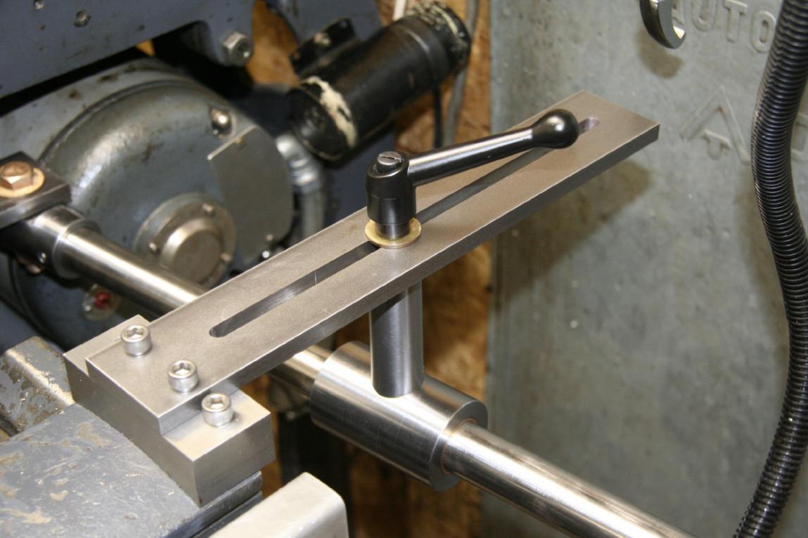

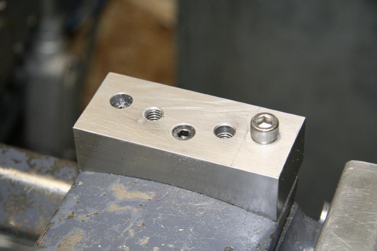

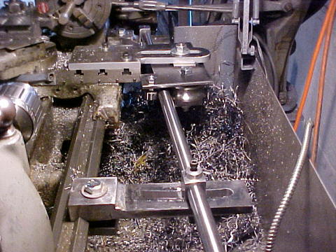

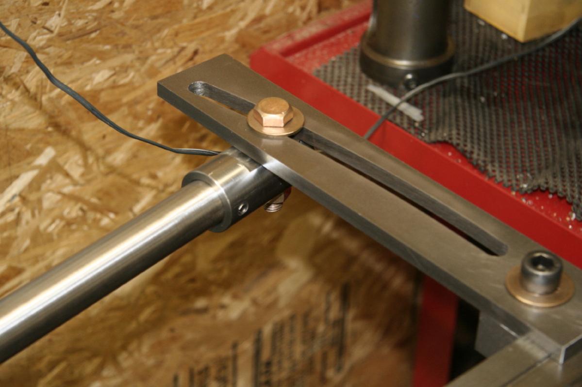

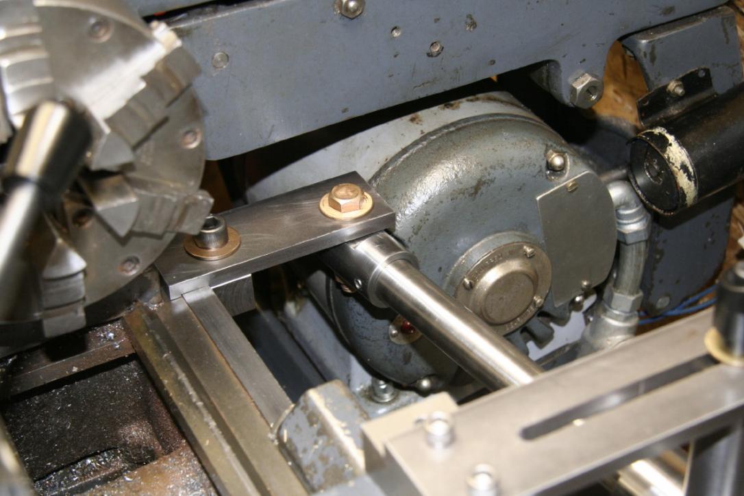

    Taper Attachment for 11" Logan Lathe
    My new Taper Attachment for my Logan 11' Lathe. Materials, 3/8" x 2" CRS, 1" x 1-1/2" CRS, 2" dia CRS, 1" dia. CRS ,1-1/8" dia oil Impregnated bronze, 1/2"-13 SHCS, 5/16"-18 SHCS, Stainless Steel heavy walled tubing. Works well less than $100.00 in material I had to buy just the CRS. All the rest reclaimed materials. Taper Attachment for 11" Logan Lathe-taperattach1_1.jpgTaper Attachment for 11" Logan Lathe-taperattach5_1.jpgTaper Attachment for 11" Logan Lathe-taperattach6_1.jpgTaper Attachment for 11" Logan Lathe-taperattachcrossmount1_1.jpgTaper Attachment for 11" Logan Lathe-taperattachcrossmount4_1.jpgTaper Attachment for 11" Logan Lathe-taperattachheadmount1_1.jpgTaper Attachment for 11" Logan Lathe-taperattachheadmount2_1.jpgTaper Attachment for 11" Logan Lathe-taperattachtailmount1_1.jpgTaper Attachment for 11" Logan Lathe-taperattachtailmount2_1.jpg
