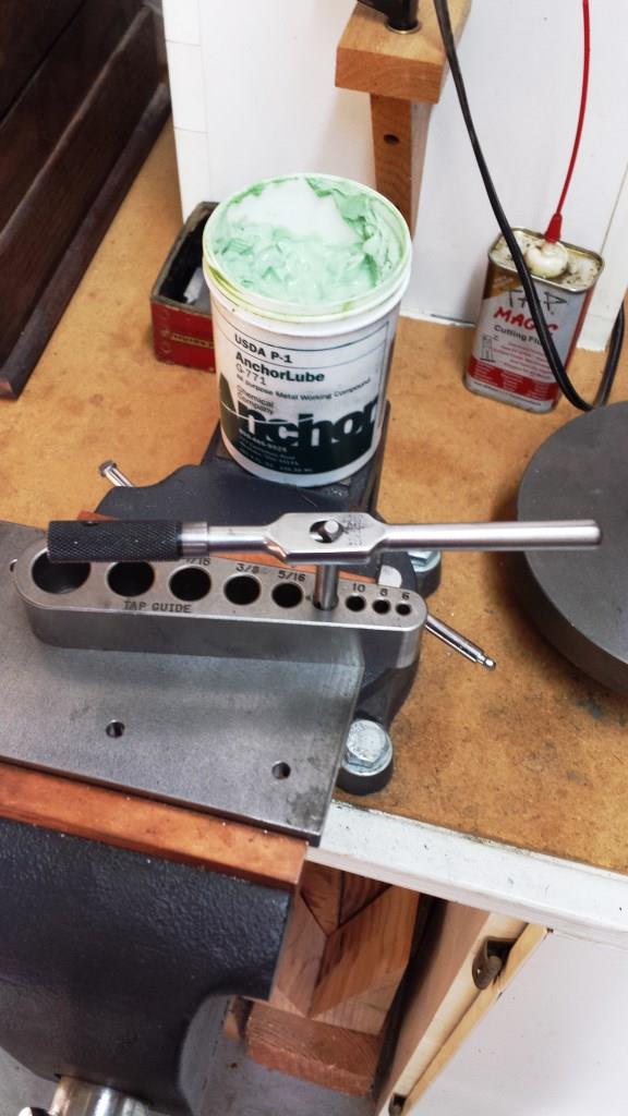

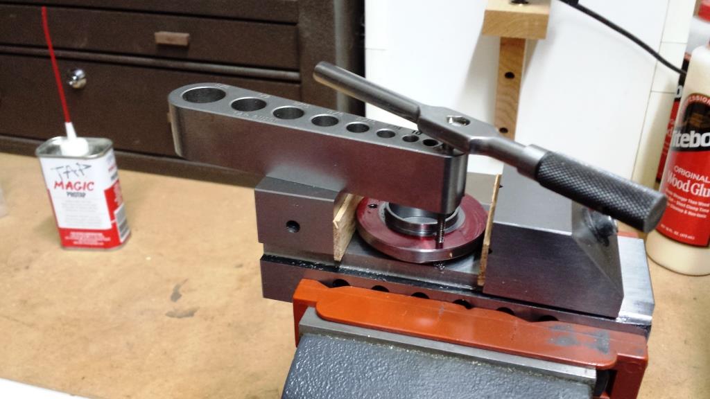

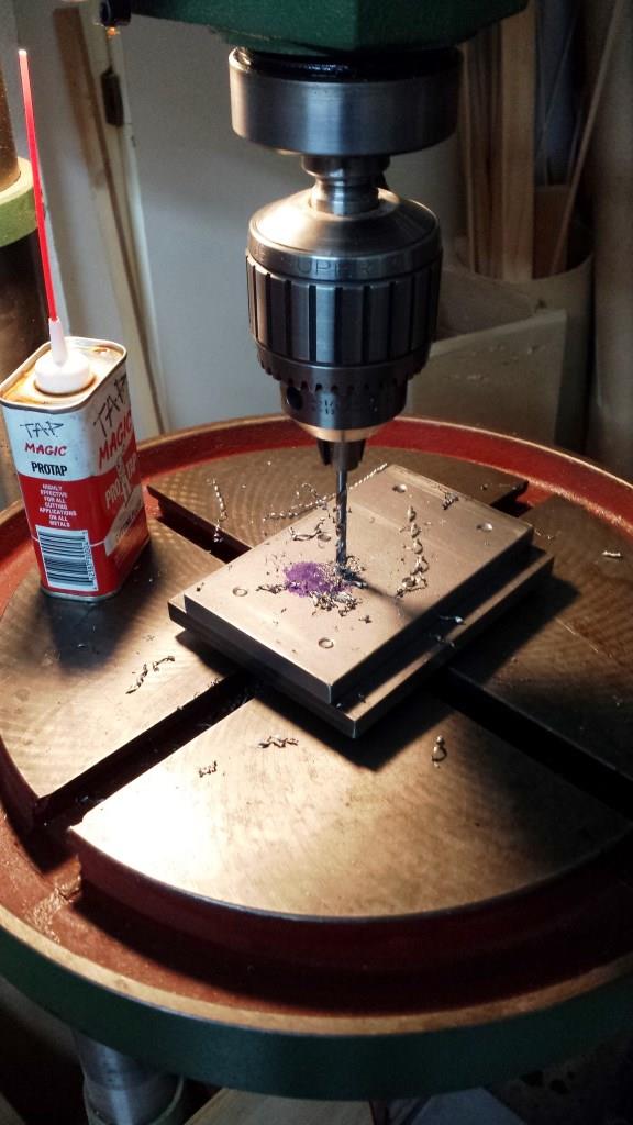

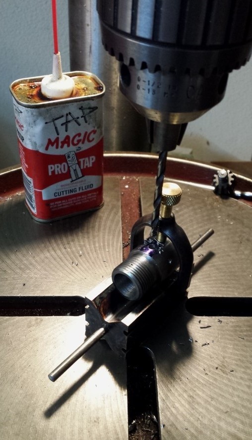

    I have several of those small Tap Magic cans around the shop. I fit the Tap Magic can spouts with those thin red plastic spray straws that come from used WD40 sprayers (and other spray cans like carburetor cleaners). Just drill a slightly smaller hole in the end of the Tap Magic's white spout and force the red straw down into it. Doing this allows placing just the right amount of Tap Magic as needed with the straw modification.
