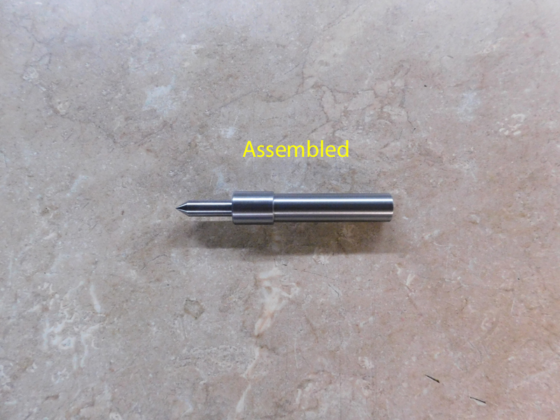

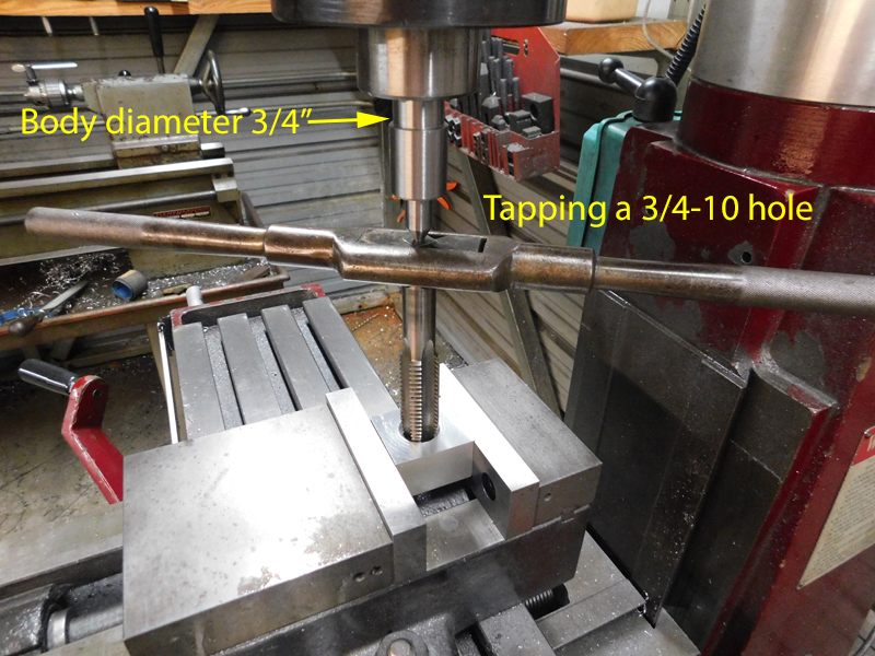

    Had to tap a 3/4-10 hole the other day in the mill and found out I had no way of driving that size of tap under power much less keeping it straight, I had a tap handle but no way to keep it straight while I hand tapped the block.
    This little tool is by no means new and probably everybody has one except me, I did however back in my apprentice days make one just for experience, whatever happened to it no one knows, that was many moons ago.

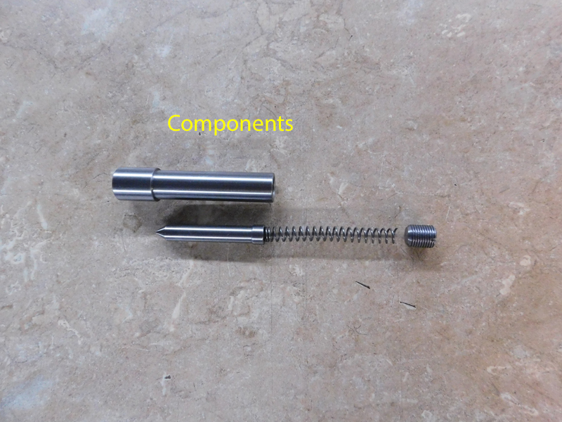

    It has a 3/4" diameter body for use in a collet with a spring loaded 7/16" diameter follower shaft that has a 60° hardened point, the follower shaft itself has an 1-1/4" of travel, it worked very well, I want loose this one, but probably never will use it again either.

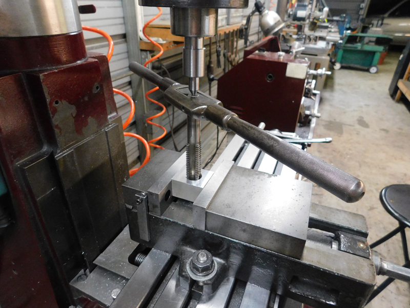

    It looks from the picture that the handle of the tap wrench will not clear the column of the mill, if so what is your technique to drive the tap? Thanks
    Eric
    11,729
    2,238
    Eric At one time I had a very similar tool that Doug has made they work great especially if the pointed cylinder has a small enough and long enough shank diameter to allow the tap handle to be lifted off the tap for re-positioning when in cases such as it appears in the photo that the tap handle can not make a full 360 swing. Just turn it as far as it will go lift off the tap square and rotate back 90°. Having to re-position a handle 4 times per thread cut is a pain but the job still gets done

    Quote Originally Posted by suther51 View Post
    Eric
    You simply turn the handle as far as it will go and reposition the handle

    Kind of thought so but sort of hoped that there was some tricky solution to bend my mind with. Thanks
    Eric
    Well, there is one way. Most of us wouldn't for a single piece, multiples certainly. Run the ram out far enough to swing the tap wrench, then setup in position for that temporary centerline.
    In most job shop knee mills, somebody has felt-tipped a mark showing ram position that spans entire "Y" axis. They may have marked a fully retracted area also, when a little extra rigidity is needed. That flexibility makes Bridgeport pattern widely copied, not the best mill ever, but gets incalculable numbers of shops out of a bind.
