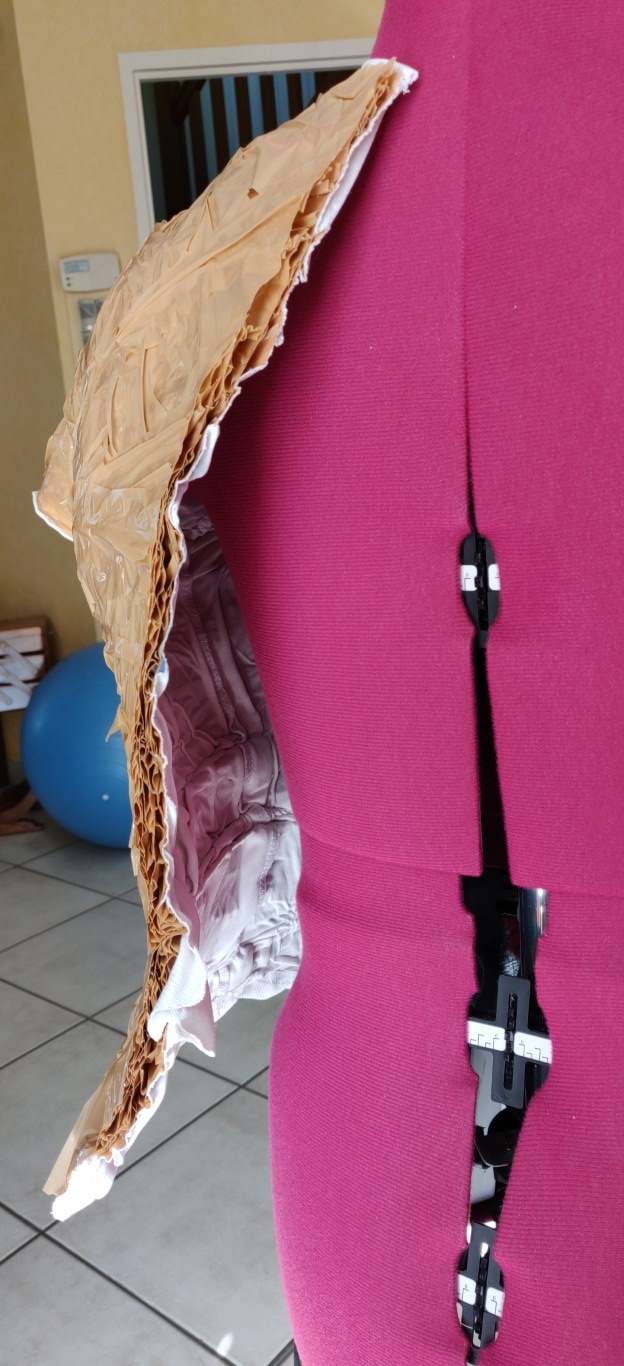

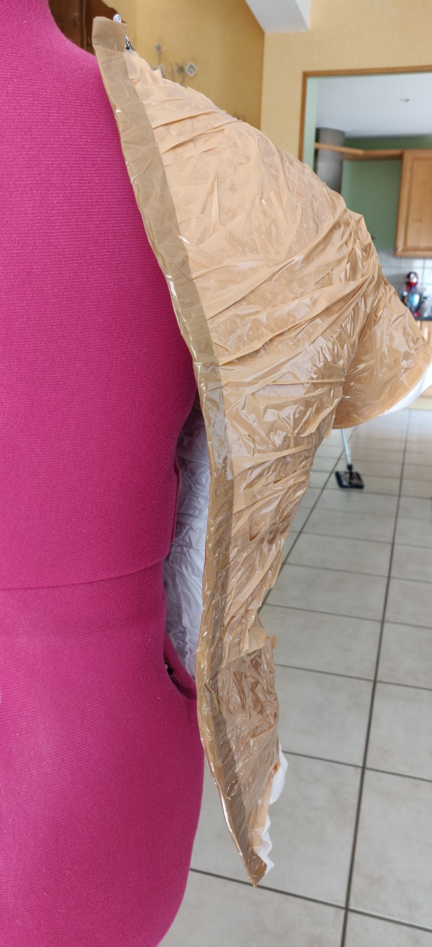

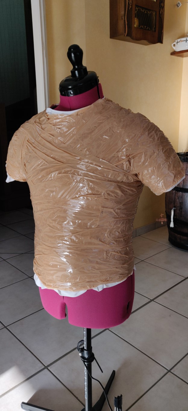

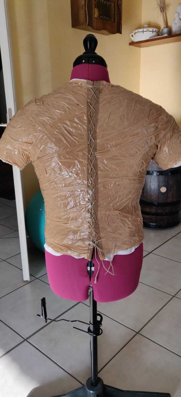

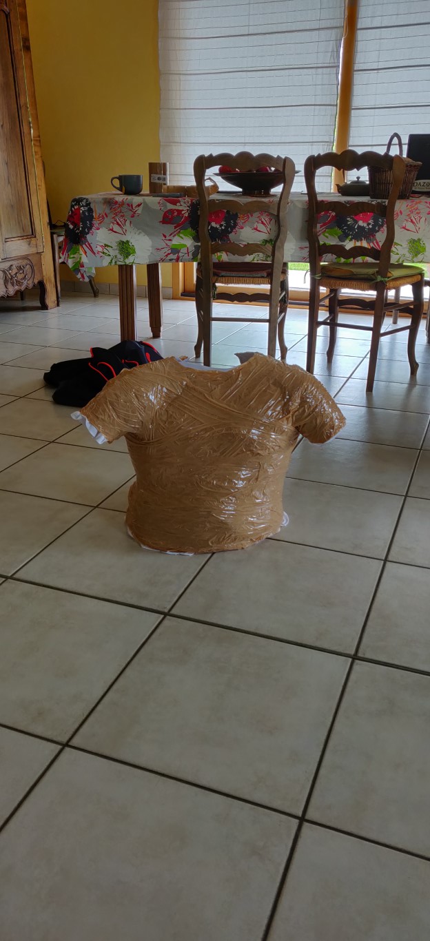

    While we are on sewing projects, my son and I do a lot of sewing, for the the girls in the house, and and for us as well.
    Yes, I know, unusual, but that's it and we are very proud of it.
    While it's very easy to get affordable dress forms for women, it's quite difficult to find them for men, and moreover, there is the question of the size.
    Here is how, with my son, we did an extension to the lady dress form for our custom sizes.
    Take an old Tshirt, and plenty of packing tape : here we used 3 rolls if I remember well.
