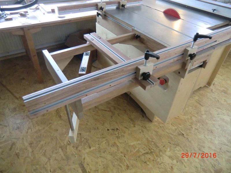

    Thanks for the welcome. What you have listed as a Panel Saw is actually the 2009 version of my Table Saw. There are two more versions (modifications of the original) which saw the light in 2014 and 2015. Eventually the 2015 edition became the "prototype" for the 2016 one that was built by André Wagner from Germany. This one incorporates all the latest improvements and is the subject of the plans we're offering for sale.
    As requested, here are some photos.

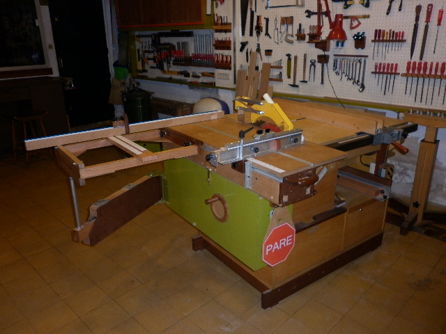

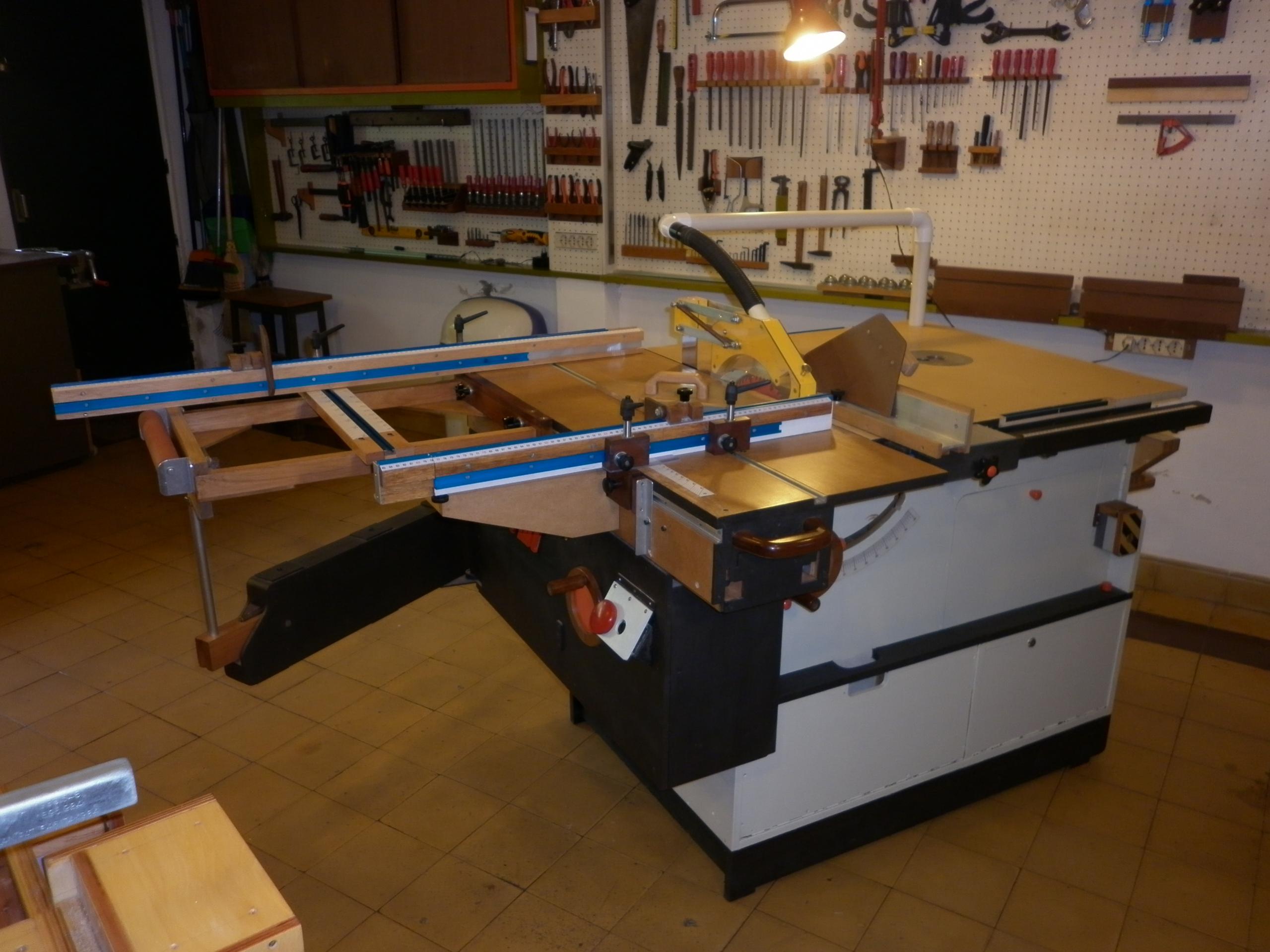

    Tacuabe-tablesaw_2014.jpg This is the saw as it looked in 2014

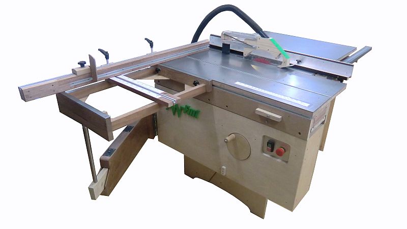

    Tacuabe-tablesaw_2016-resized.jpg And in 2015 up to the present day. This one is what we called "prototype" as told above

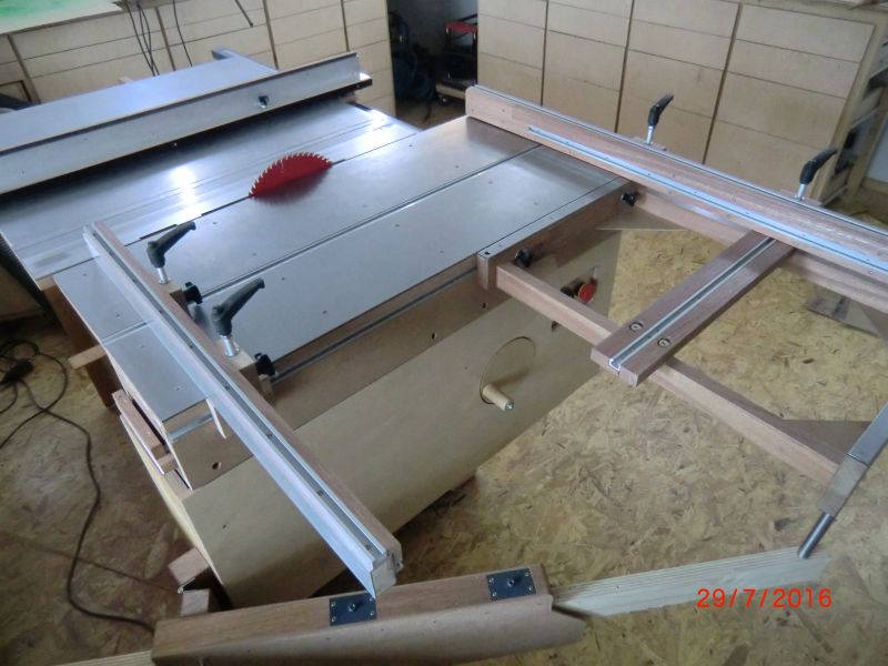

    Tacuabe-tablesaw_2017-resized.jpg This one is built from the plans we offer in our website: AW-Thinkbold

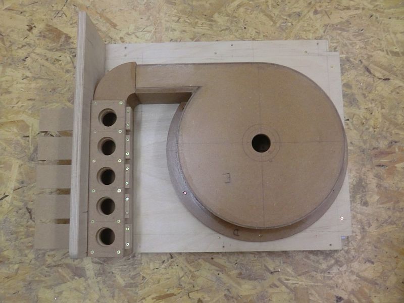

    Tacuabe-dc_13.jpg A view of the Thien Separator and Blast Gate Manifold

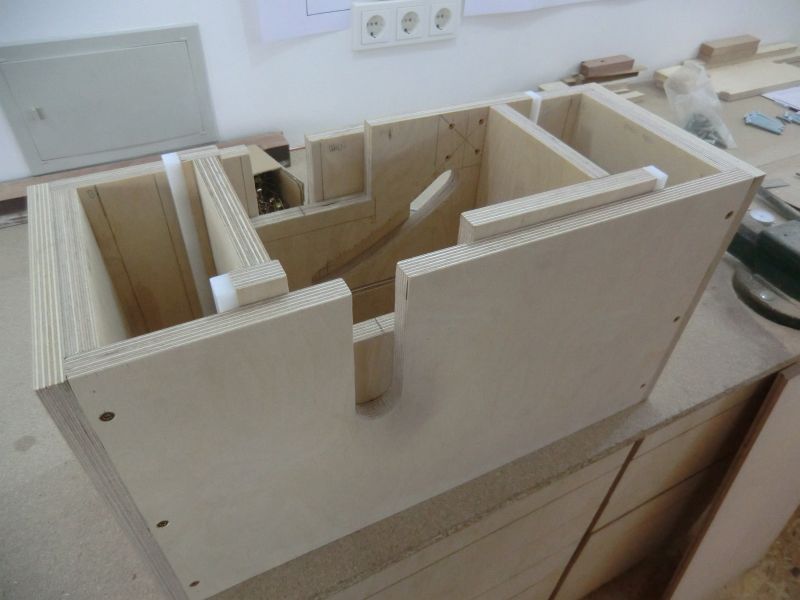

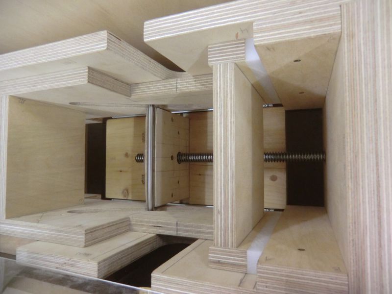

    Tacuabe-st_22.jpg The Sliding Table Support Structure
    Tacuabe-st_23.jpg Pulled to the front
    Tacuabe-st_24.jpg Pushed full to the back

    It's beautiful! Nice video too.
    If you like, you can offer the plans for sale in our Tool Plans Marketplace. We would add it here: Listing of All Tool Plans for Sale. PM me if you're interested.
