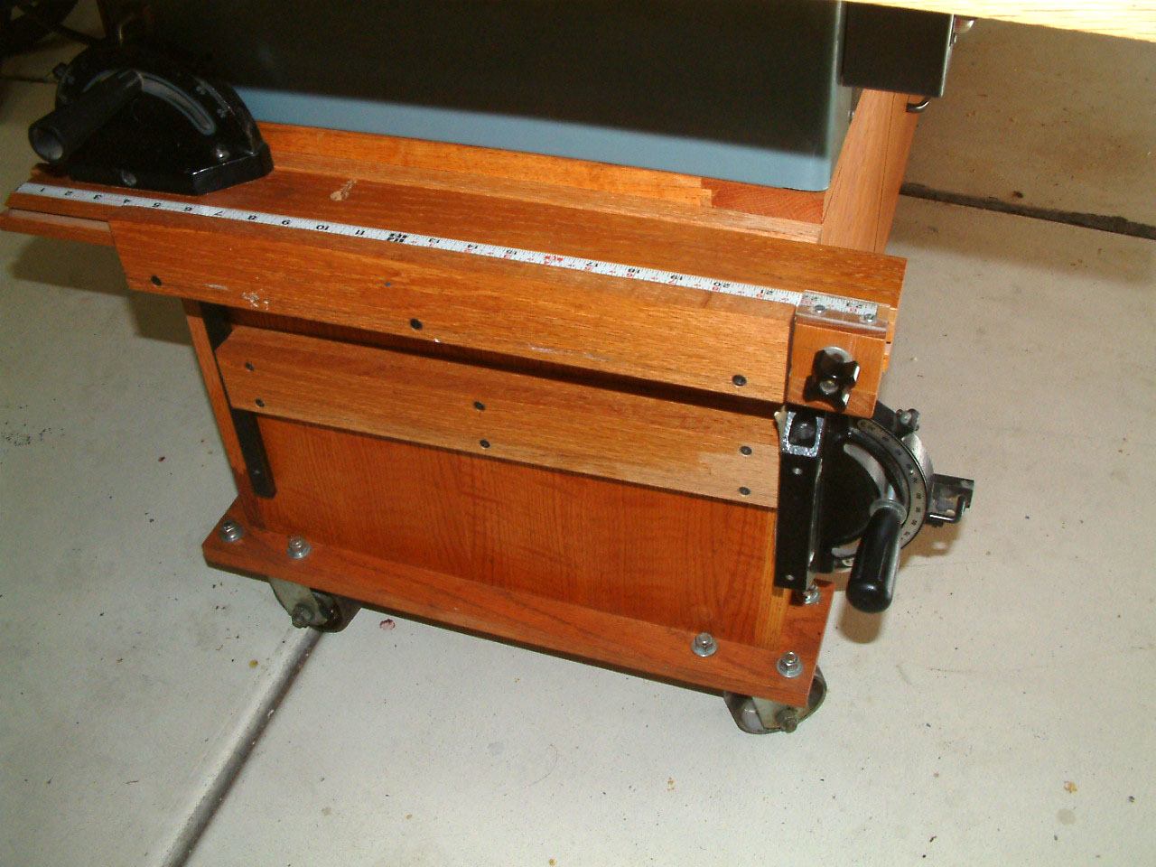

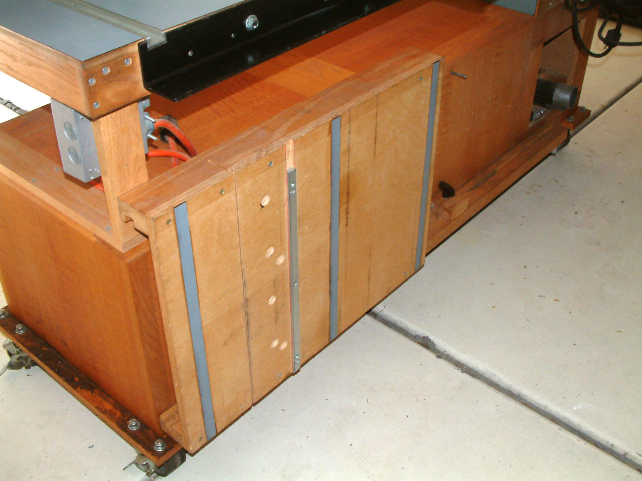

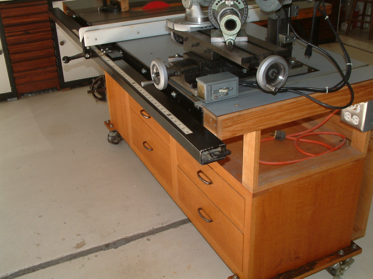

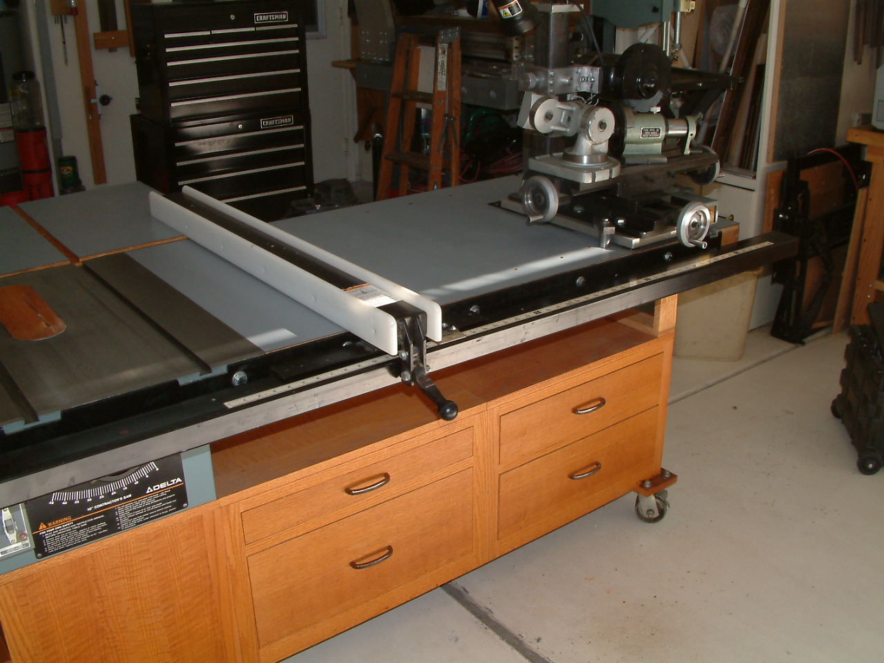

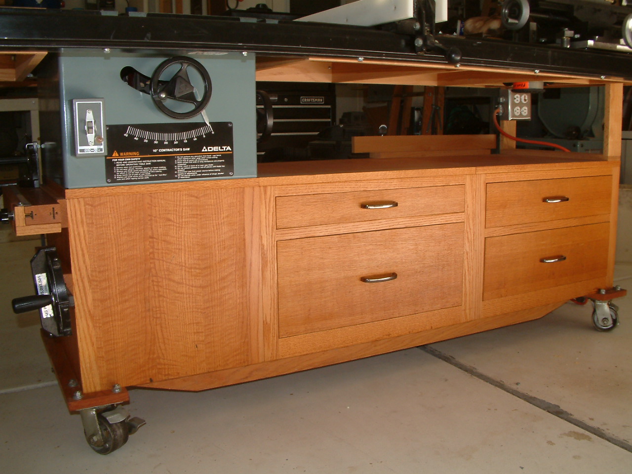

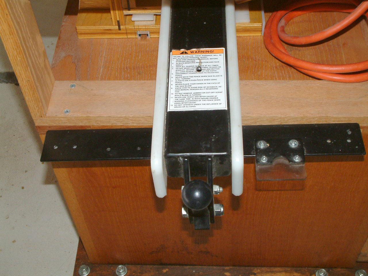

    This is an oldie that takes center stage in my shop on many days.
    The table saw is a 20 year old Delta Contractors 10" saw. Originally it had a set of steel legs but I wanted a 50 inch T-Square Fence. Bought the Fence from Grizzly and a bunch of 3/4 Birch Plywood. The unit is built in 3 sections that are all connected by the "beams" that you can see from the front view and bolts thru the cabinet sides. The wheels are casters with a 5" steel wheel. The wheels (up until about 1 year ago) had urethane tires that started to disintegrate. I removed the wheels and cut,filed,burned that urethane off to just leave the steel. They actually work much better now. The delta saw section includes a dust bin under the saw and I connect my shop vac there when in serious use. The right is the router end but it now has a grinder on the top. I move the grinder when it is time for the router. Plans for the bench were in Shop Notes number 9. Wood finish is Danish Oil. I added an outfeed table to the unit that can be seen behind the Delta Saw. This is my multi-purpose roll around bench. I can still get one car in the garage. Electrical outlet box is on the underside by the router area. The Delta saw's original toggle switch was replaced with a real switch. I had the toggle switch on my Delta band saw fail and figured this one would fail also so I just got ahead of it. There is storage for jigs and fixtures, miter gages, fences, etc on the lower deck, side and back. This is my multi-purpose bench.

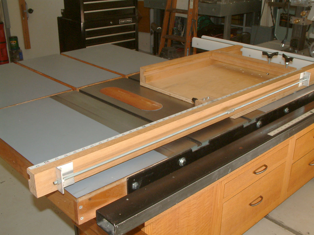

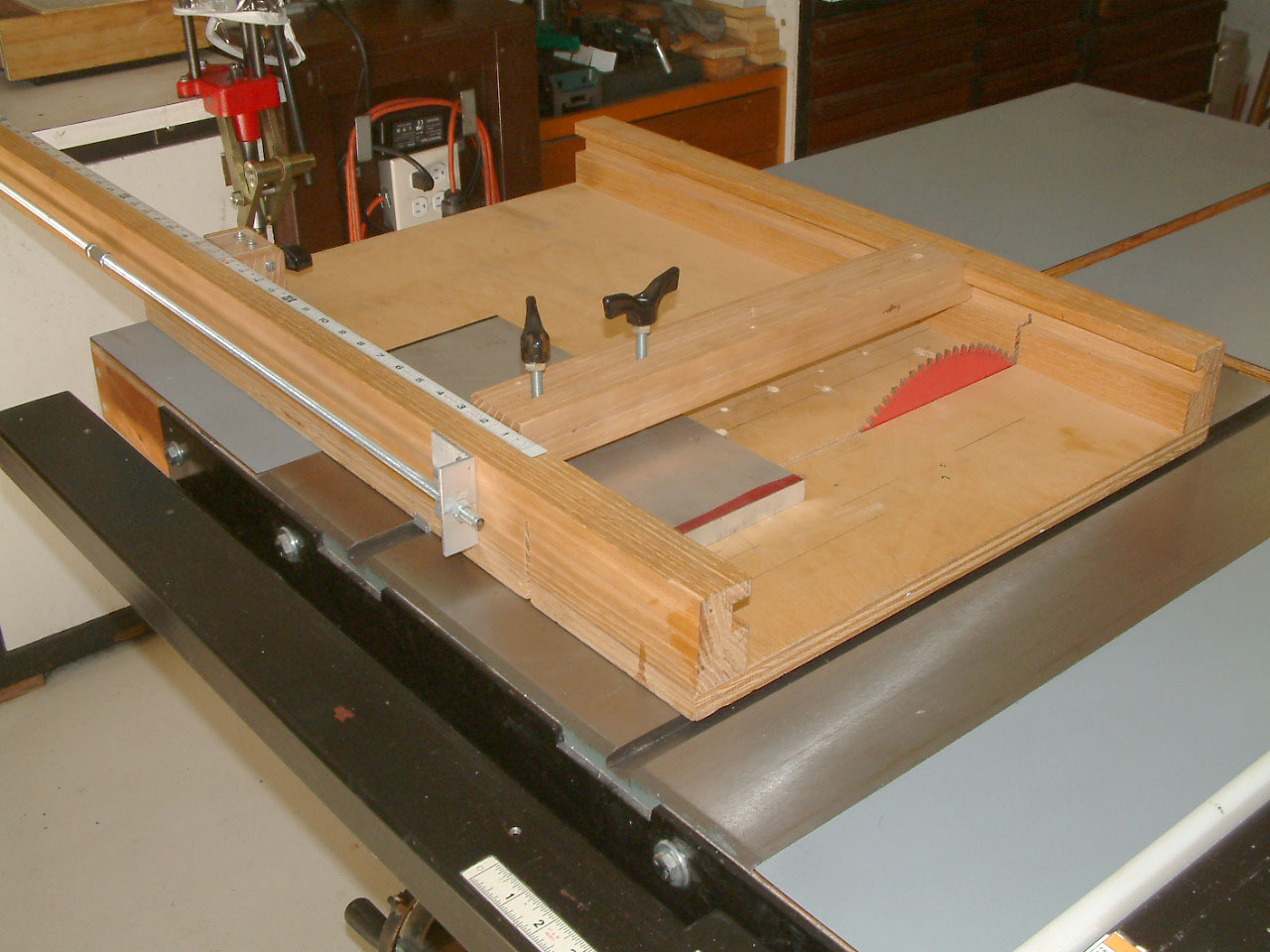

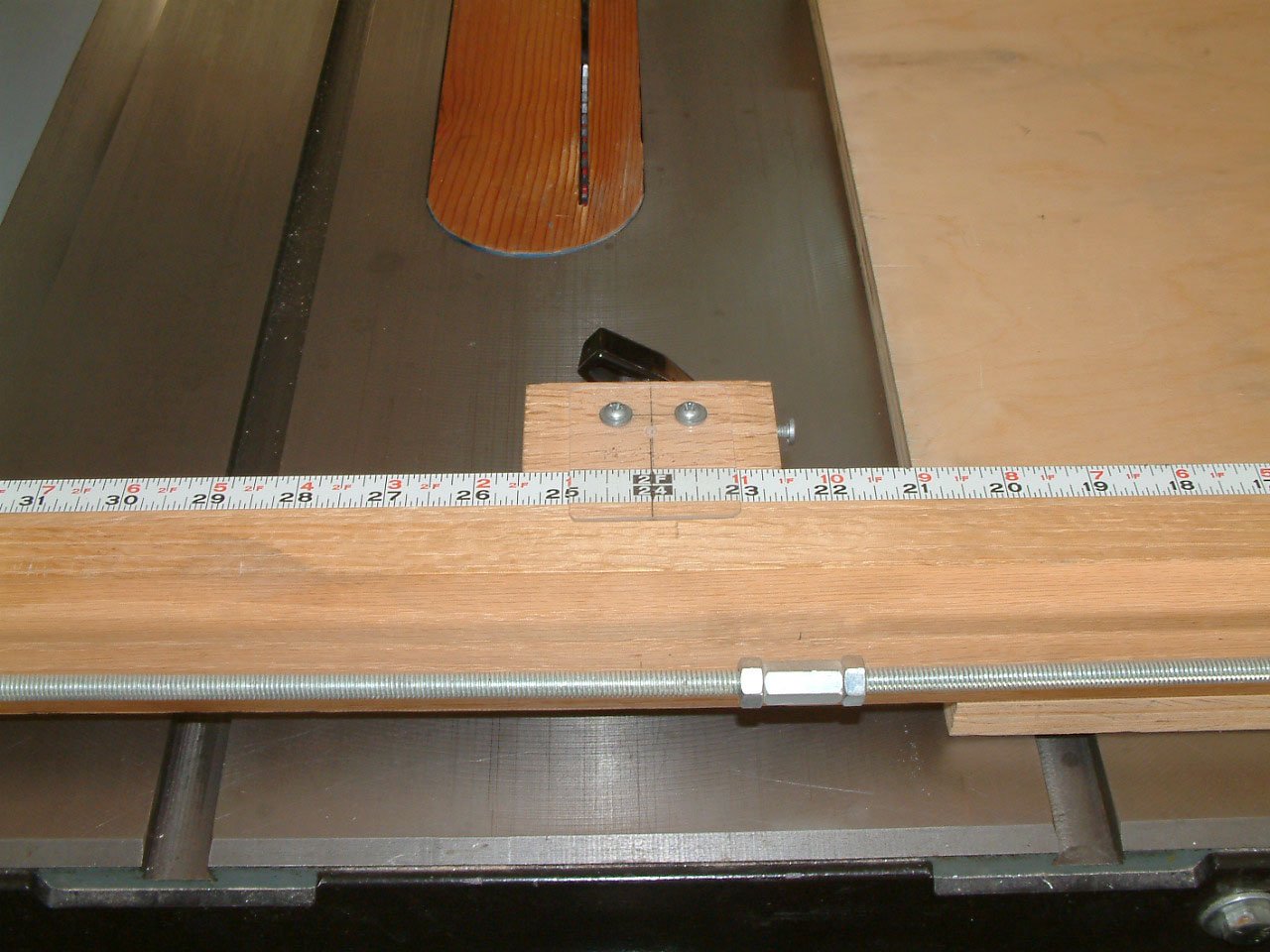

    Sliding Cutoff Box or Sliding Table Fixture
    The sliding table or box is the only way I will cut aluminum and plastic on my saw. This fixture holds the material firmly and secure so that I do not have a problem with the blade grabbing it. The blade is an 80 tooth Freud designed for non ferrous metal cutting. I have cut aluminum over 2" thick by "double sawing" it in the box.
    This box was designed for wood working and long work. That is why the fence is 48" long. Storage when not use is at the back of the roll around table.
    Cheers, JR

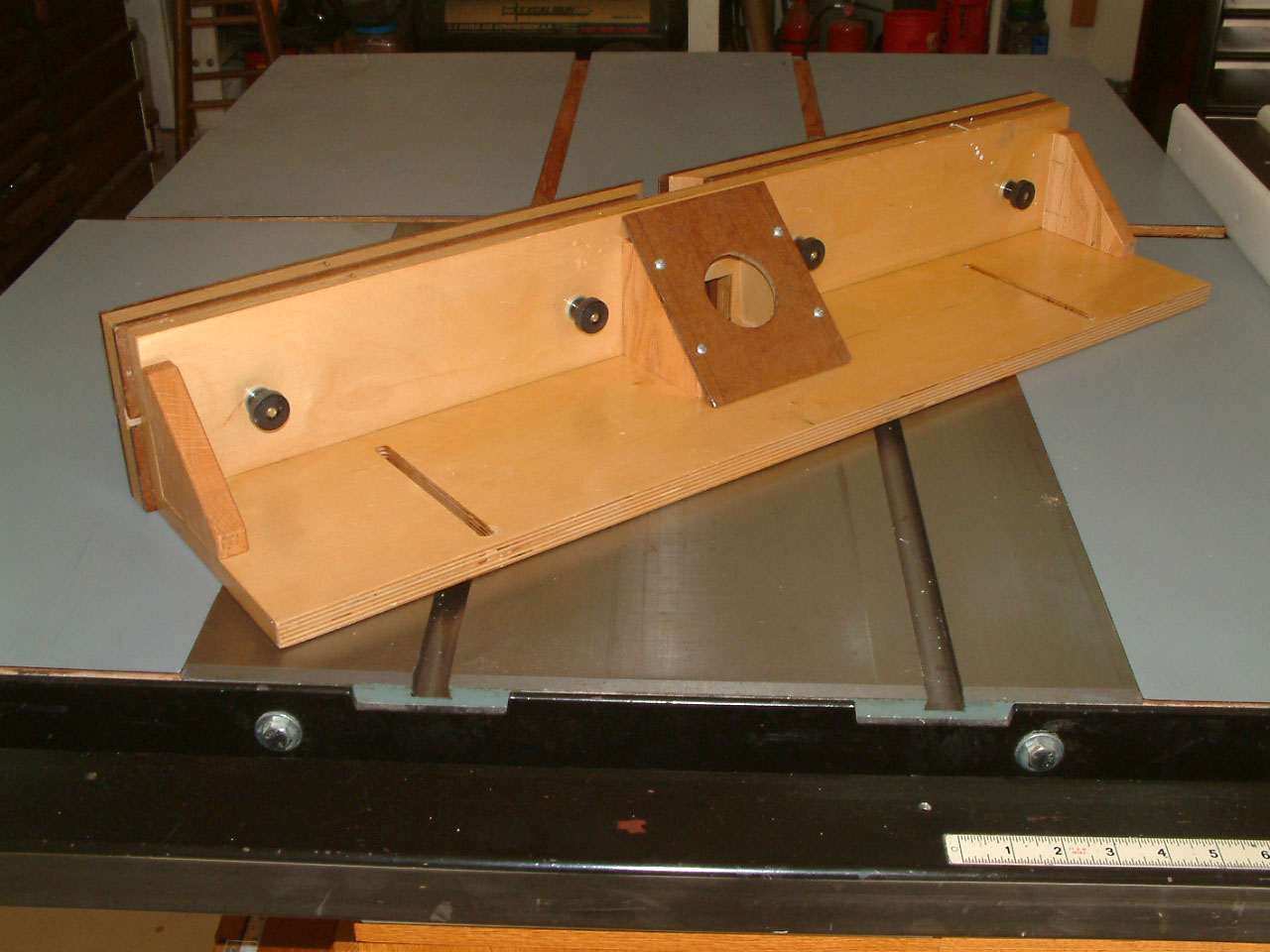

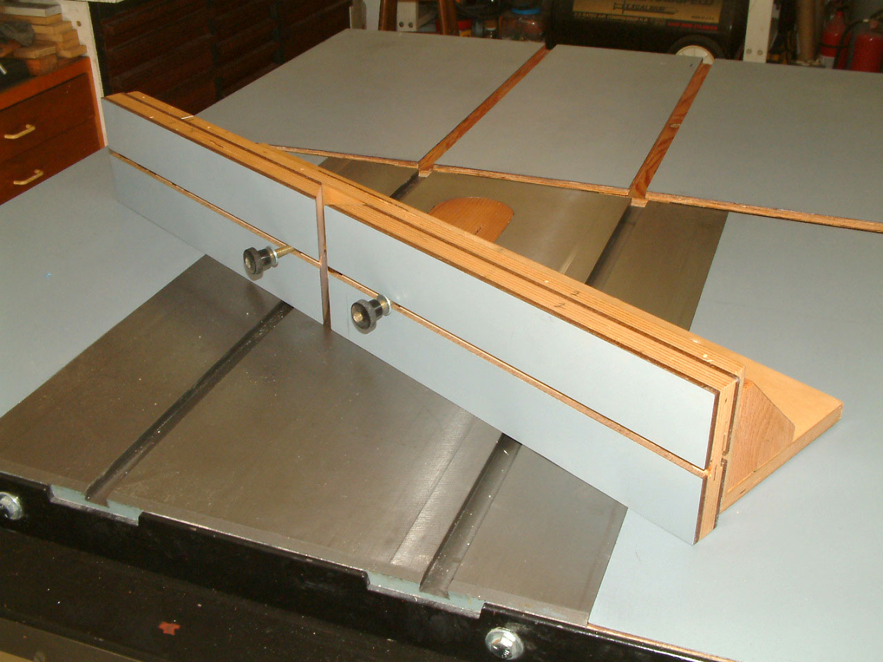

    Router Table Fence
    Adjustable router fence with lots of clamping and guiding options. Versatile for many types of routing on the router table when the grinder is not in the way. Note the vacuum port on the rear and the double panels that may be positioned for cutter clearance.

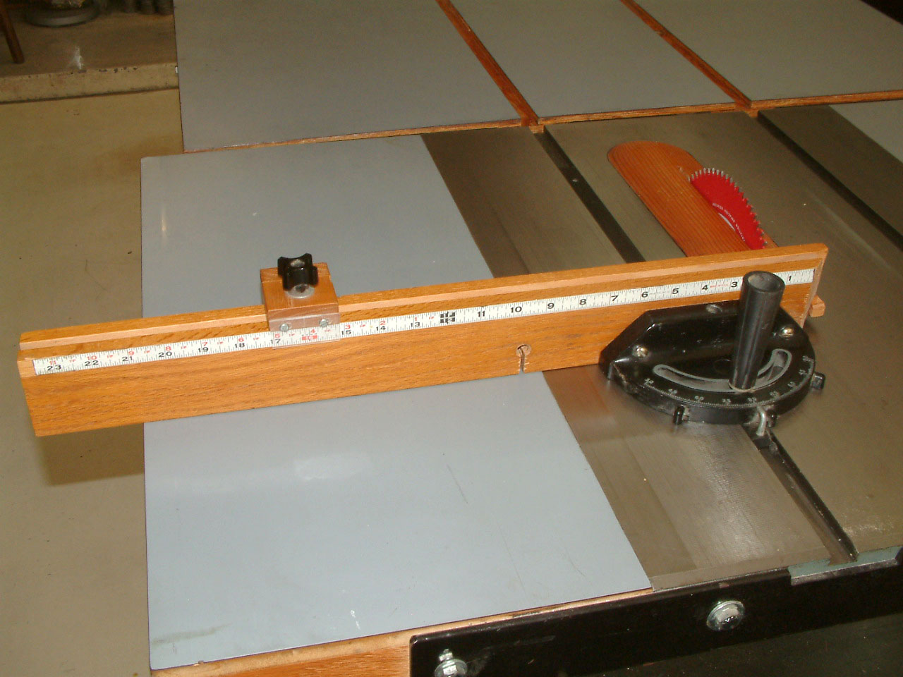

    Miter Fence
    Extended Miter Fence with adjustable stop. This is my go to fence for multiple piece work. I have another Delta head with just sandpaper for a face for general use.

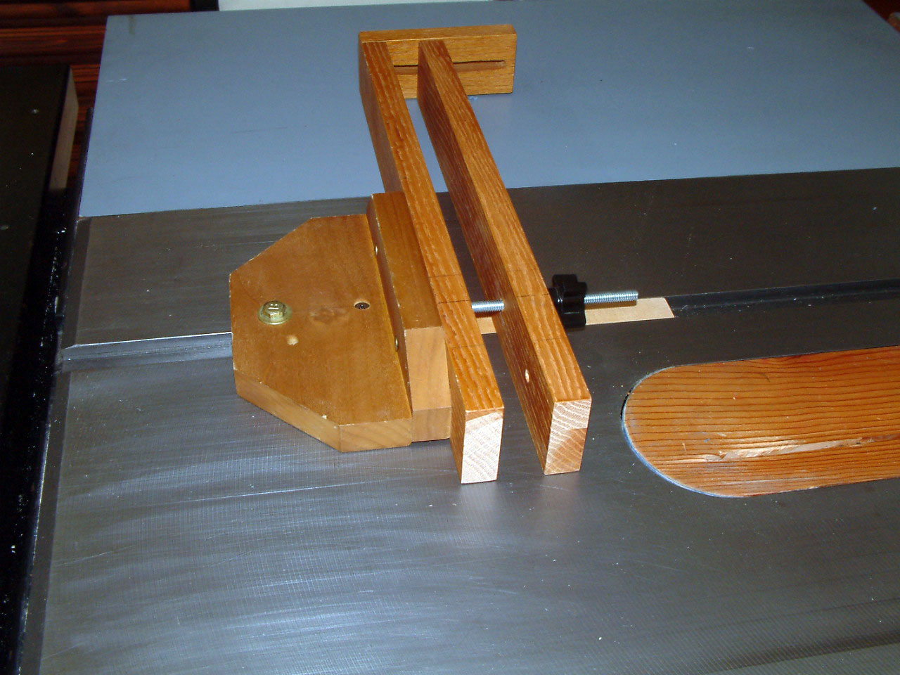

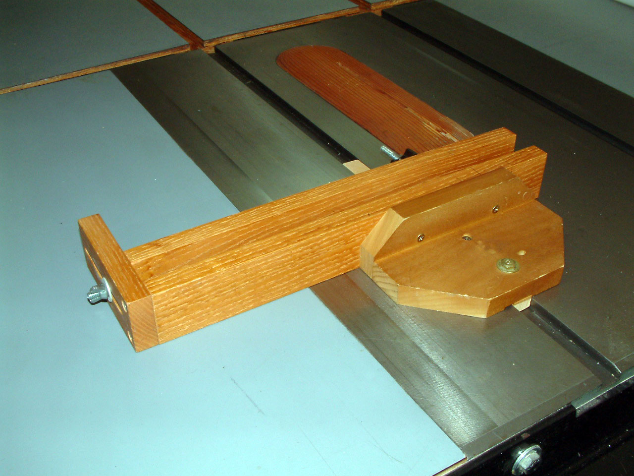

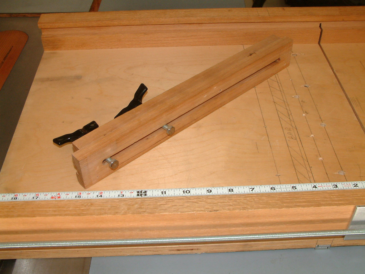

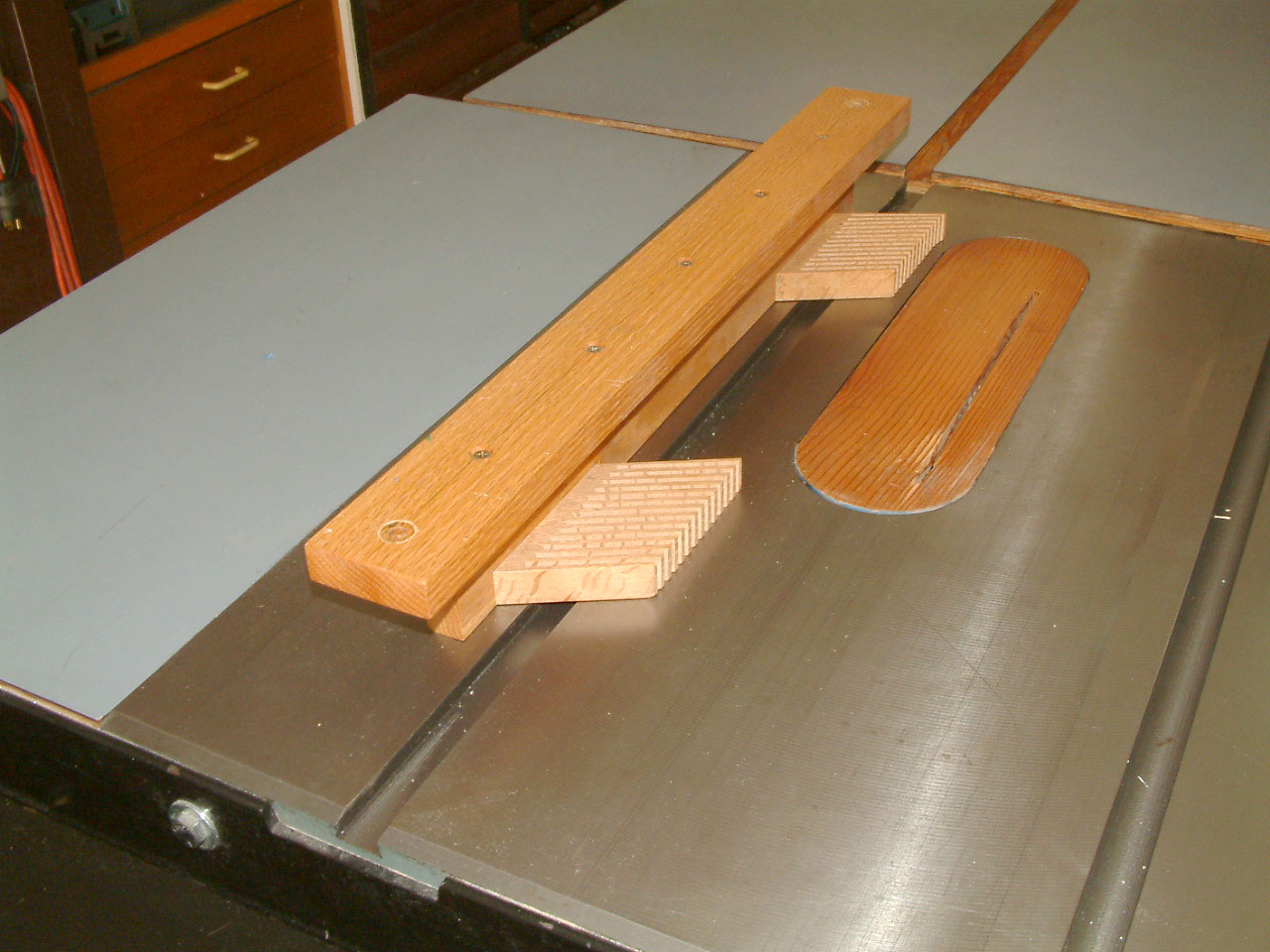

    Small Part Cutoff Fixture
    This one gets a lot of use with parts that are just too small to safely cut any other way.

    jjr2001's Tools

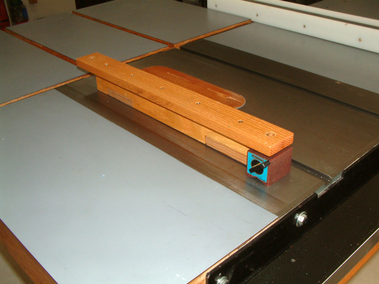

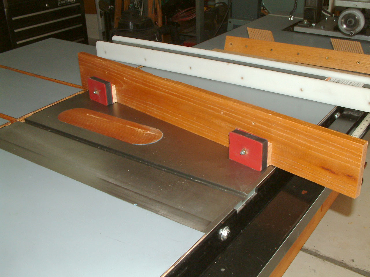

    Magnetic Feather Board
    Metal workers will notice the indicator magnetic base. Actually there would be two of them. One on each end but the other one was in use in the metal shop. Very easy to relocate and adjust.
    Cheers, JR

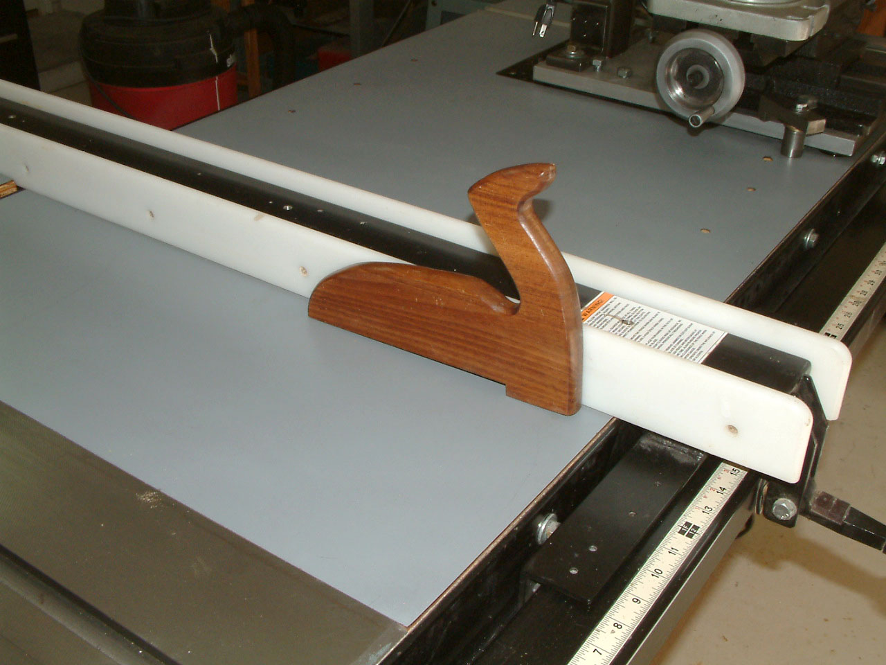

    jjr2001's Tools

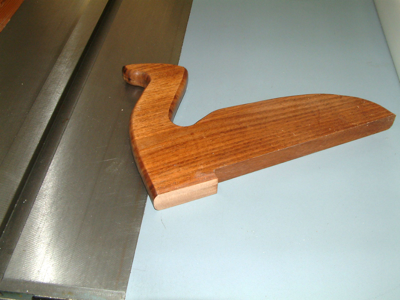

    Push Stick
    Every one needs a good push stick or even a few good push sticks.
    Cheers, JR

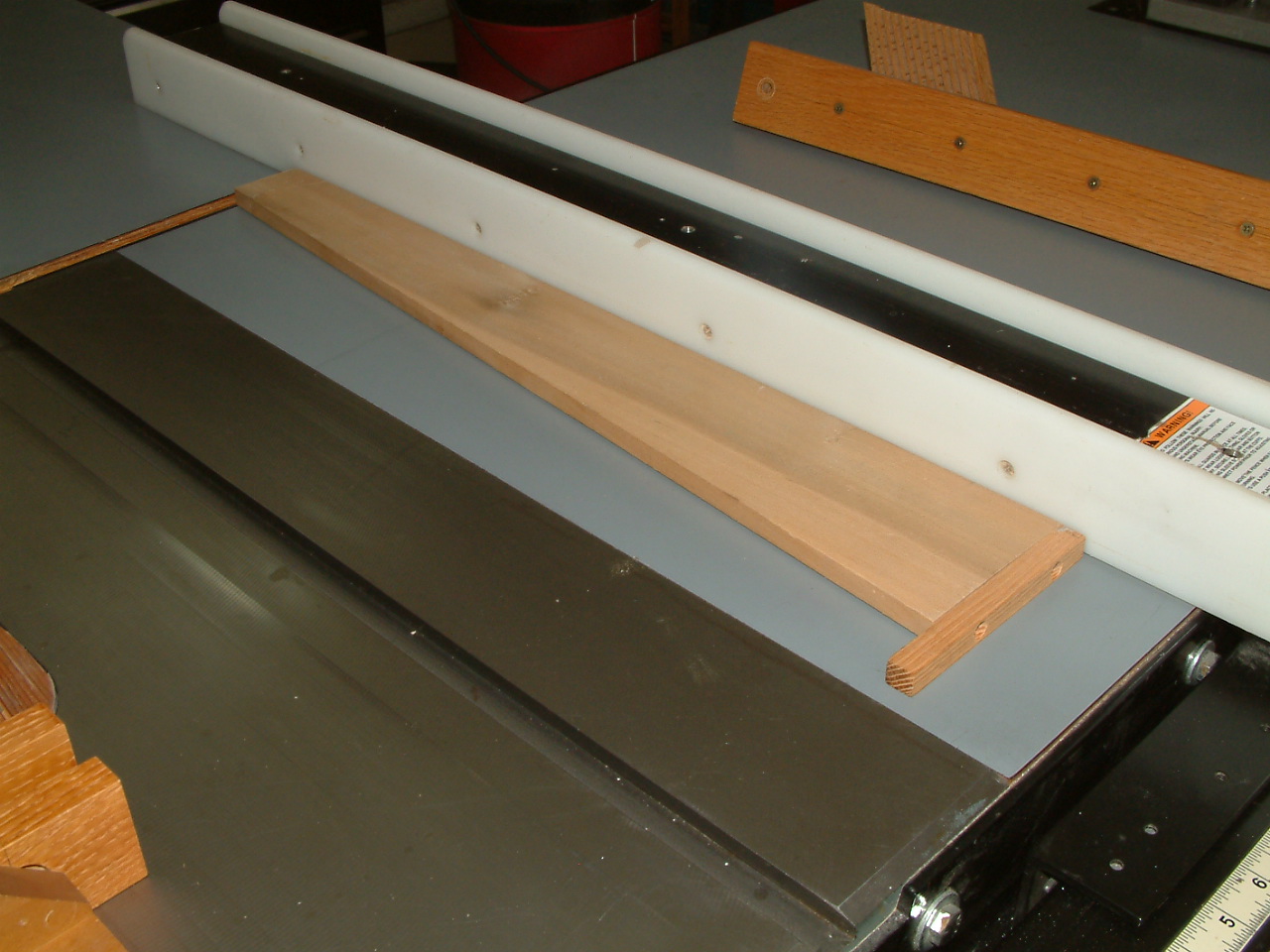

    jjr2001's Tools
    Table Saw Taper Jig
    Simple tapering jig.
    Cheers, Jr
