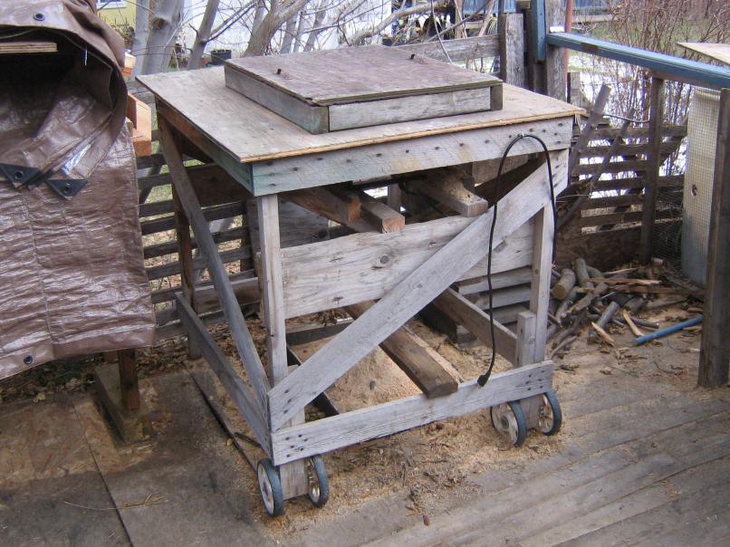

    This was originally a lightweight table I made to use in and around the shop,
    when I was given a 6amp portable saw with an 8¼" blade I decided to mount
    it under the table using a simple wooden frame. the table measures 38" wide
    x 44" long x 40" tall.
    Attached Thumbnails Attached Thumbnails Table Saw-img_5710.jpg   Table Saw-img_5722.jpg   Table Saw-img_5715.jpg   Table Saw-img_5717.jpg   Table Saw-img_5720.jpg
