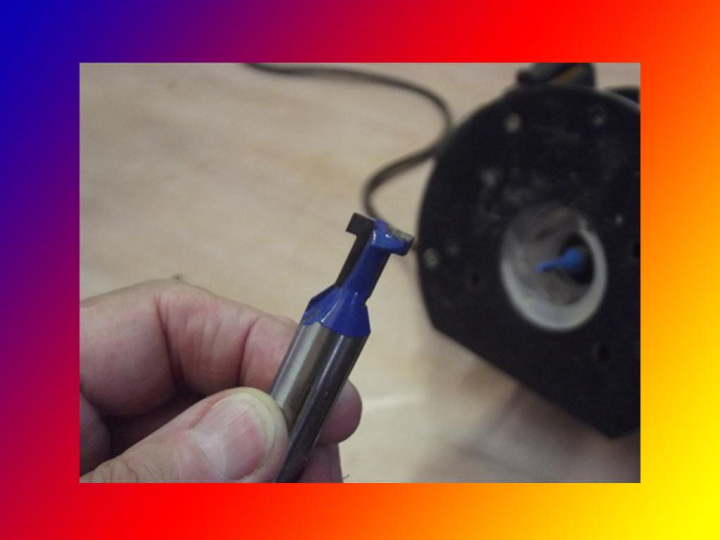

    Probably helps if I show a piccy of the t cutter router bit I was referring to...
    Sorry
