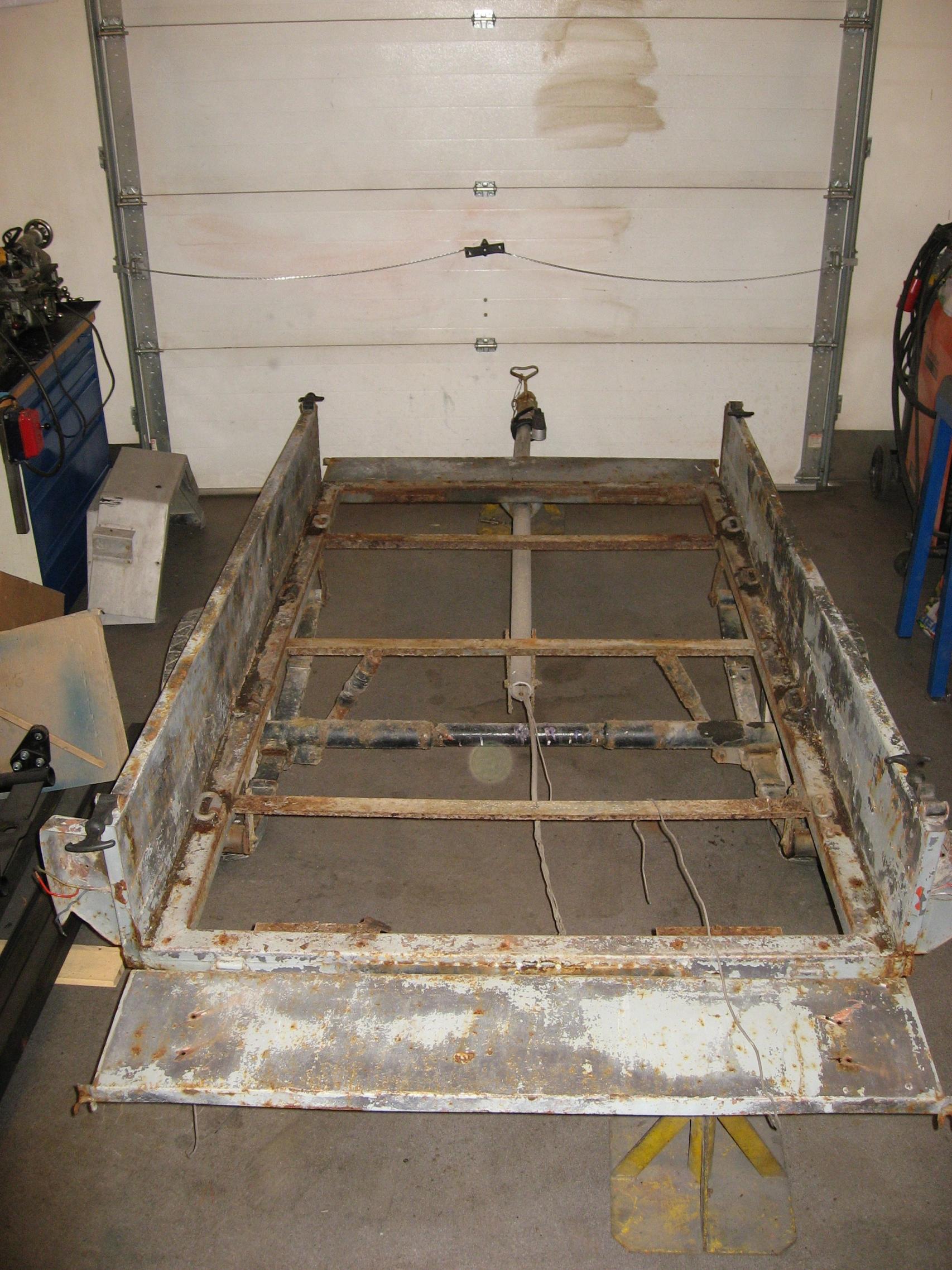

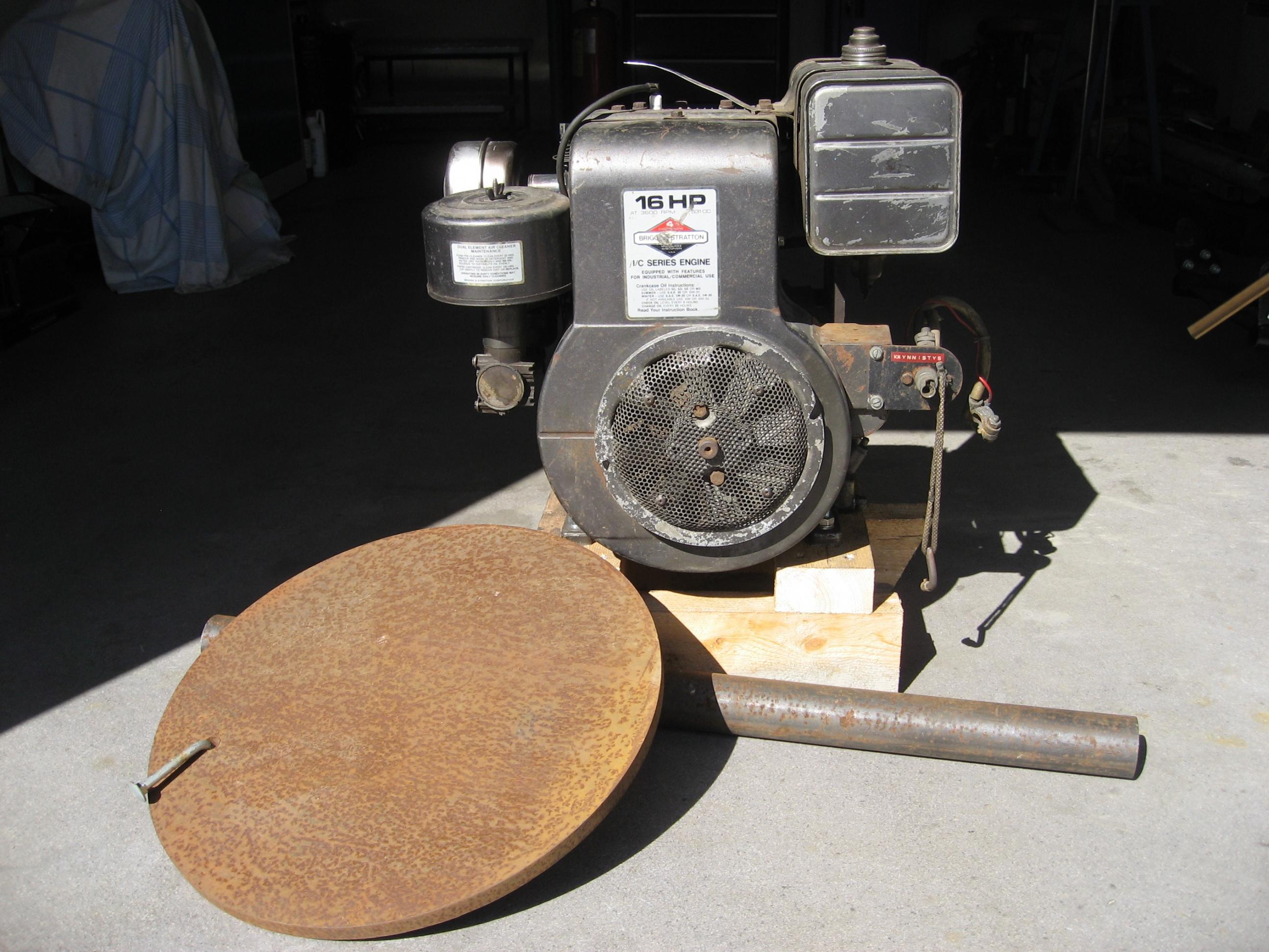

    I got my wood chipper made ready - although I am retired it took me over 13 months. The whole project started from this
    T-Rex - my towable wood chipper-haketintarvikkeita.jpg T-Rex - my towable wood chipper-k%E4rryaihio.jpg

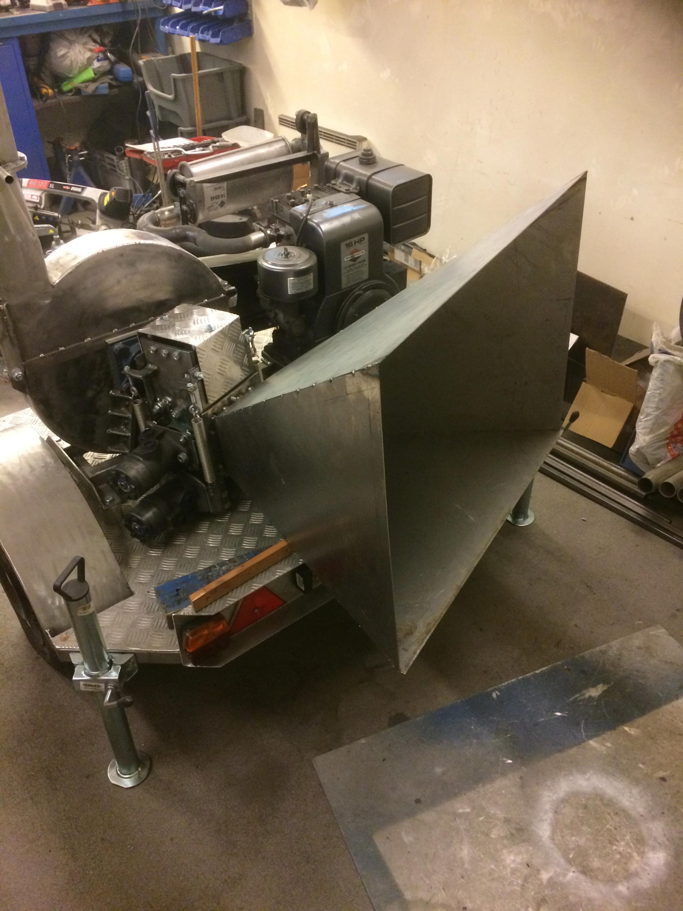

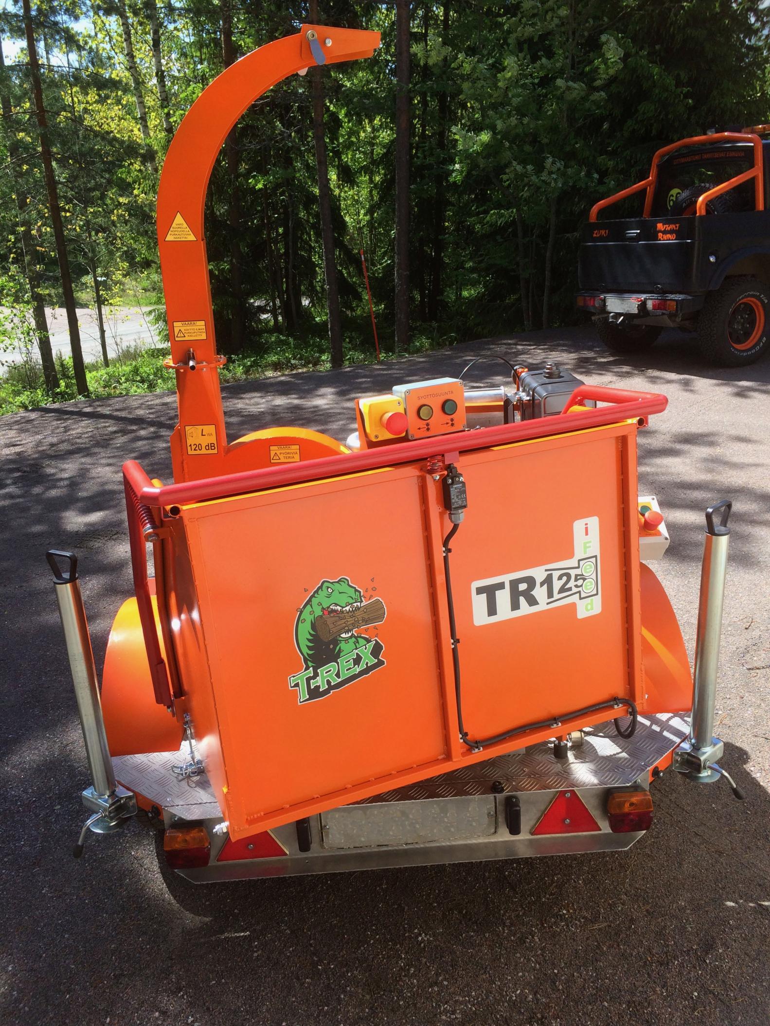

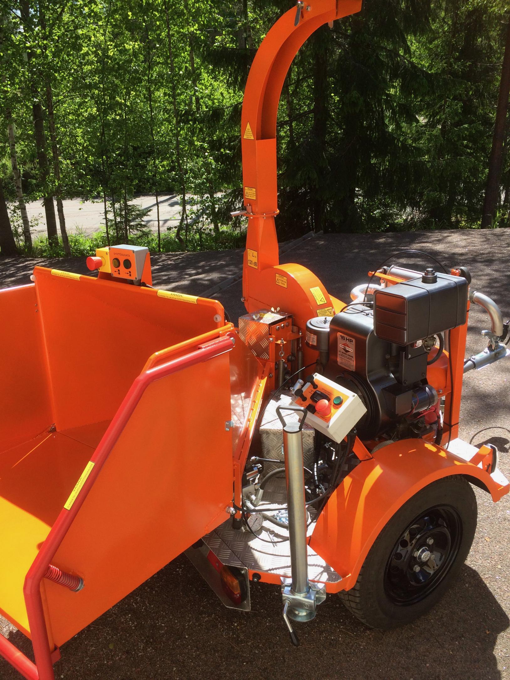

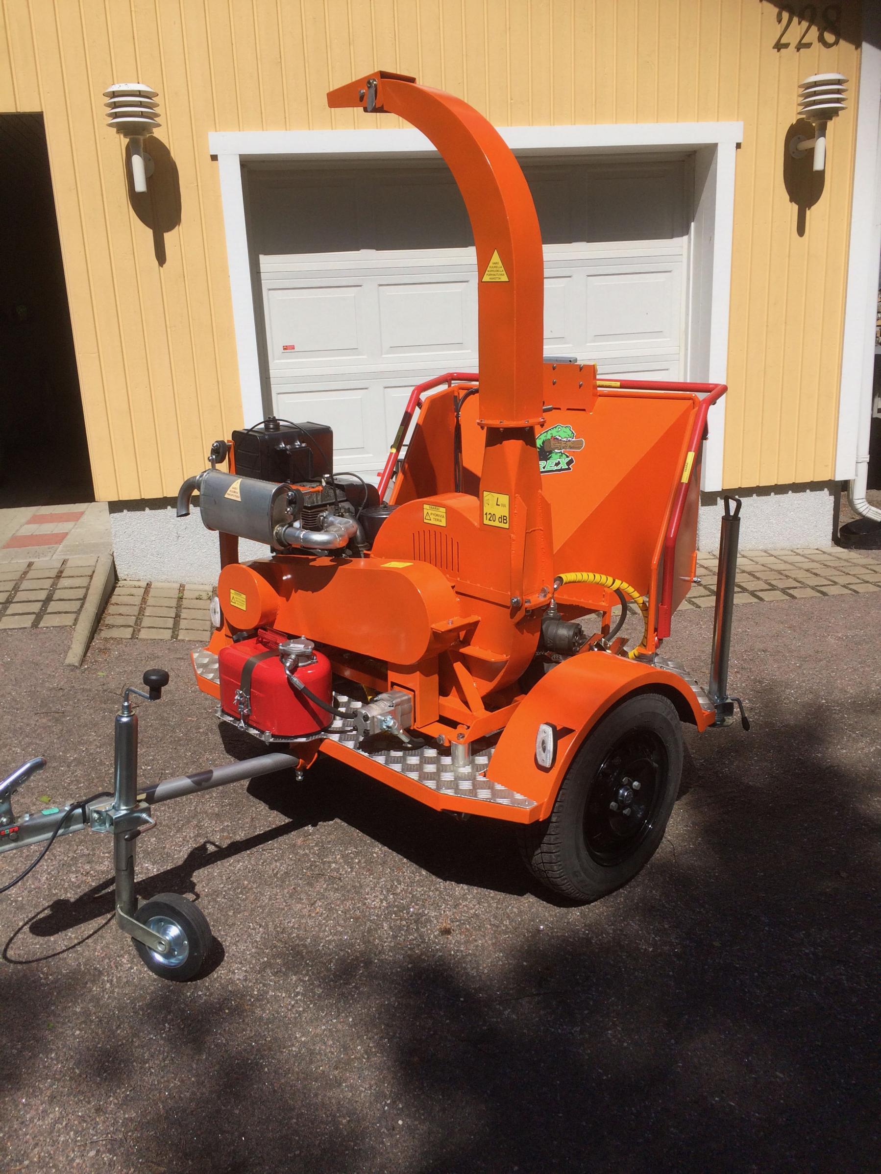

    and ended up with this towable hydraulic feed chipper
    T-Rex - my towable wood chipper-valmis-haketin-1b.jpg T-Rex - my towable wood chipper-valmis-haketin-3b.jpg T-Rex - my towable wood chipper-valmis-haketin-5b.jpg

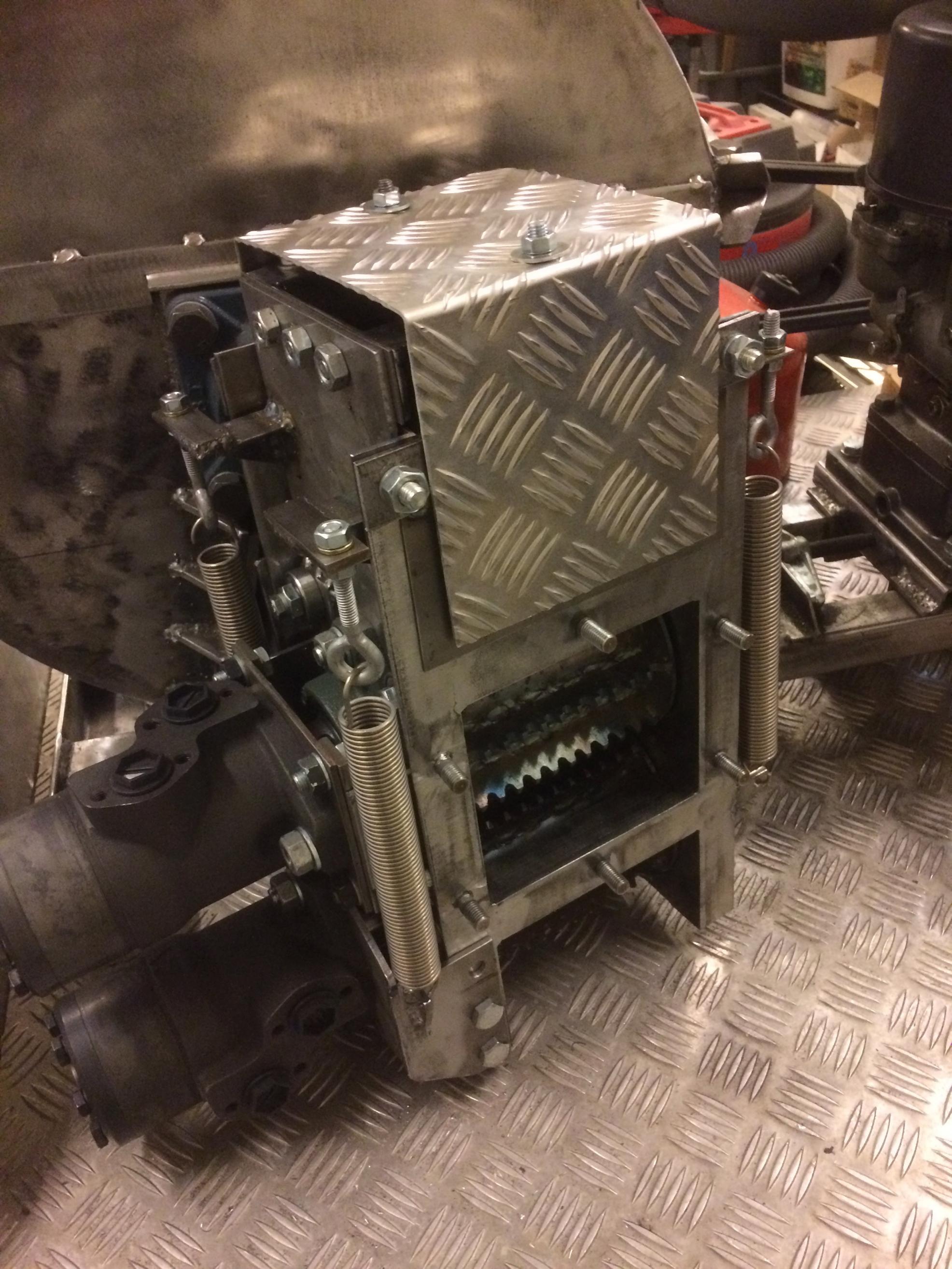

    Initially I made the chipper with manual feed but first tests showed that it did not work very well so I decided to redesign it to hydraulic feed. As I had to buy the hydraulic parts as new the whole project budget was doubled.

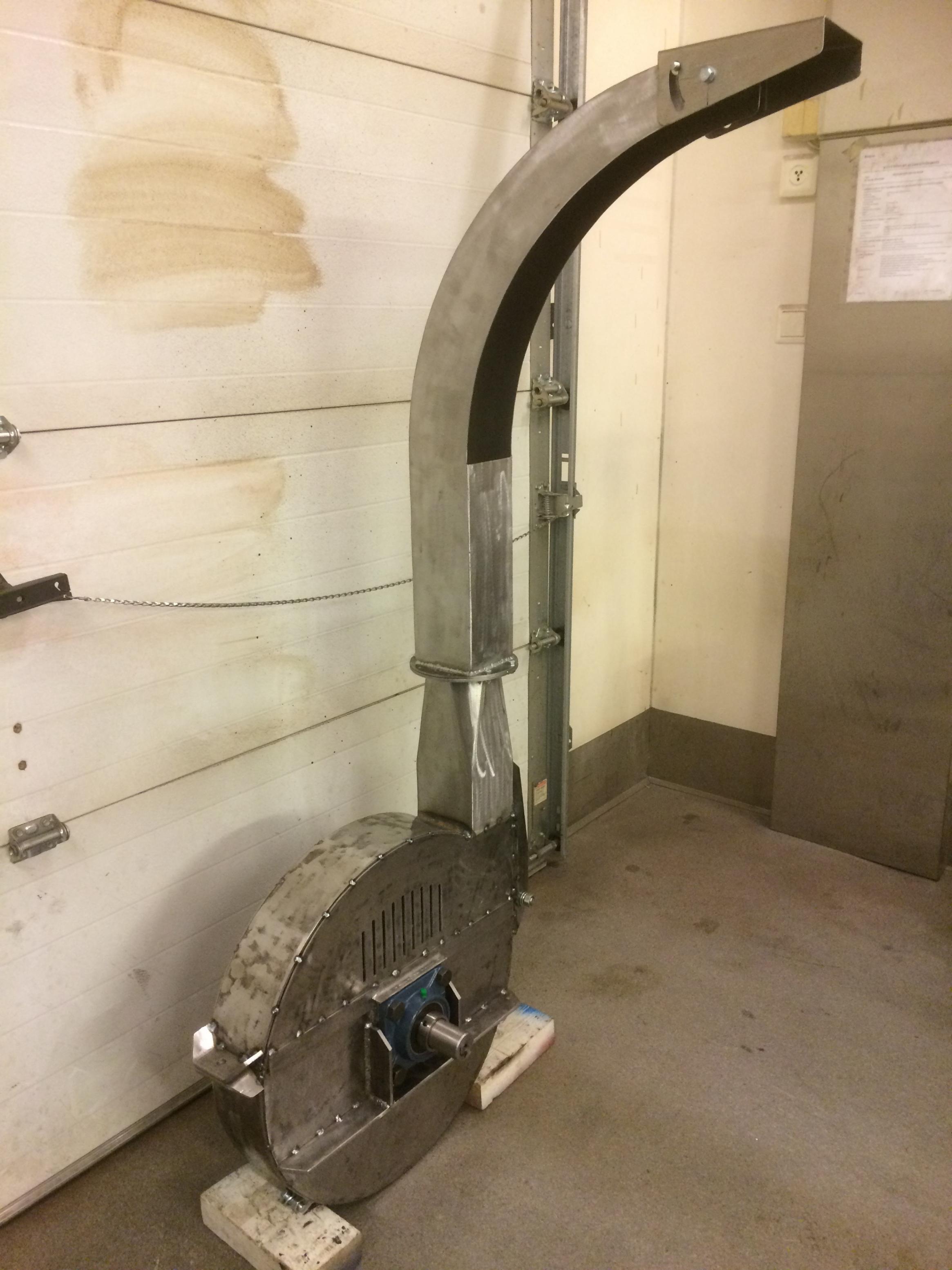

    The chipper is powered by a 16hp Briggs&Stratton cast iron engine from 1979. The axle and frame is from a old homemade trailer from 1980. The chipping wheel diameter is 500mm and thickness 20mm and fitted with two chipping blades. The weight is about 32 kg and it rotates at 1 300 rpm. The engine axle has a centrifugal clutch with two V-belt groves with diameter 90mm. The chipping wheel pulley diameter is 180mm. The hydraulic pump with a flow of 7,4 L/min. is also driven from the chipping wheel axle.
    The infeed rollers are driven by 250ccm gerotor motors. The direction of the motors are controlled by two solenoid valves. A flow divider is also fitted to make it possible to adjust the infeed roller speed. Additionally an Arduino microcontroller is via an inductive sensor fitted to read the chipper wheel speed. If too heavy load is applied and the chipper wheel speed drops below a set rpm value the microcontoller cuts voltage to the infeed roller solenoids until the chipper wheel gains enough rpm again. The chipper is capable to chip wood up to a diameter of 125mm.
    The feed table edge to indeed rollers is 1 250mm to meet CE safety regulations. An infeed cutoff bar is fitted around the feed table edges. Emergency stop switches are fitted above the infeed and on the control panel. The chipper wheel housing cover is also fitted with a safety switch.
    The towable chipper trailer base is re-registered as a towable machine and it is now allowed to tow it on public roads. The total weight of the chipper is 380kg.

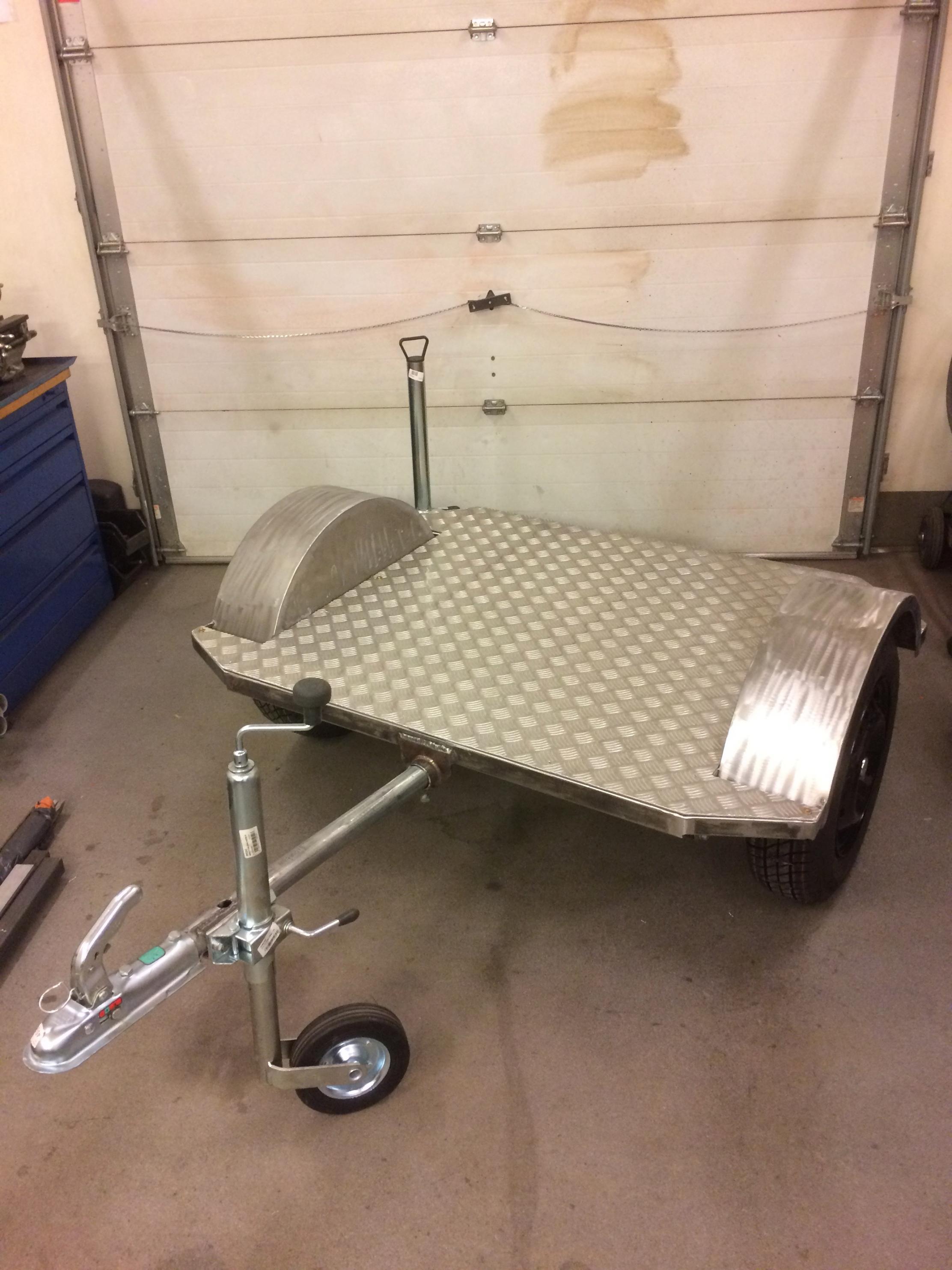

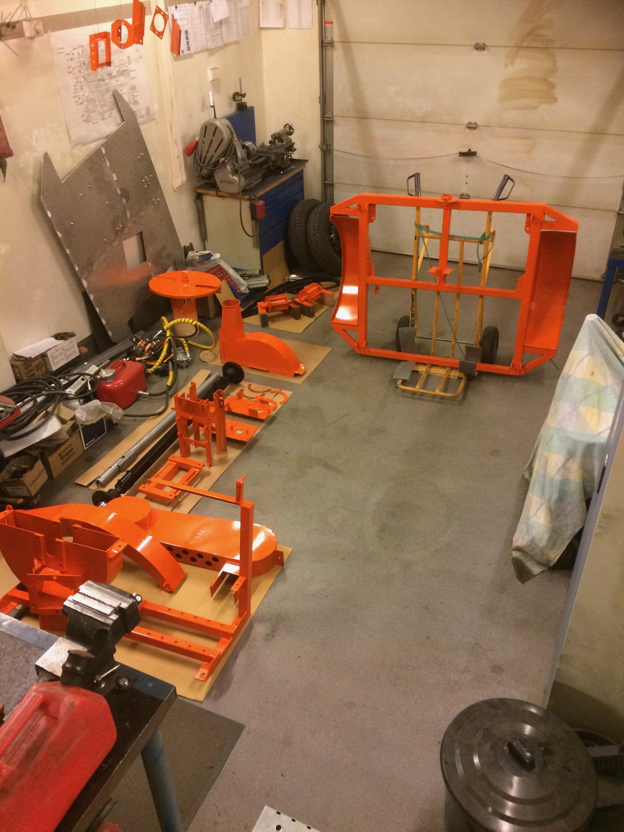

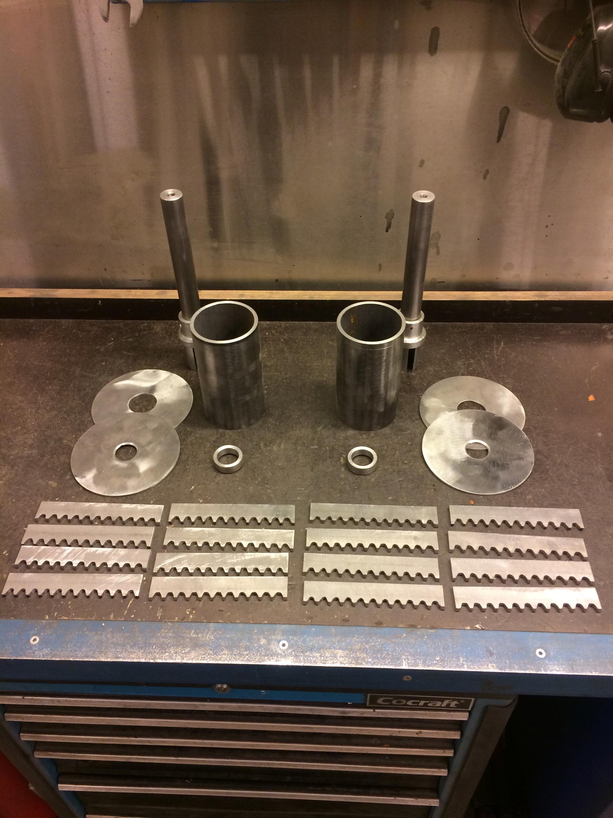

    Here are some additional pictures taken during the project.
    T-Rex - my towable wood chipper-laikka-valmiina.jpg T-Rex - my towable wood chipper-haketinrunko-koottuna.jpg T-Rex - my towable wood chipper-hakettimen-alusta-valmiina.jpg T-Rex - my towable wood chipper-sy%F6tt%F6rullien-osat.jpg
    T-Rex - my towable wood chipper-sy%F6tt%F6rullakehikon-osat.jpg T-Rex - my towable wood chipper-sy%F6tt%F6rullakehikko-valmiina.jpg T-Rex - my towable wood chipper-sy%F6tt%F6suppilo-heftiss%E4.jpg T-Rex - my towable wood chipper-osien-maalausta-2.jpg

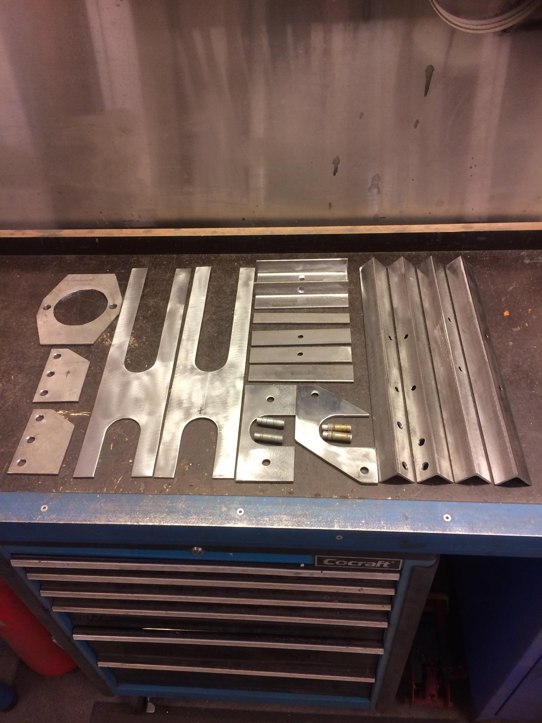

    I forgot to ask. What method did you use to cut the plate?

    I cut all the plates with a Bosch jigsaw.
    It works surprisingly well on plates up to 2mm thickness. Cutting 3mm plate is getting a little bit slow and 4mm is both slow and eating up blades faster.
    One thing that you have to do very often is to drill 10mm holes in corners for the cutting blade. The plate must also be held firmly in place, otherwise it starts to vibrate that slows down cutting and increases the risk for breaking the blade.

    That is a nice chipper you made there, what material is the blade made from and how did you go about balancing it?
  13. #10
    Supporting Member ruxu's Avatar
    May 2017
    Southern Finland
    18
    Thanked 133 Times in 14 Posts
    ruxu's Tools
    Thank you for your kind praise.
    I did not make the blades myself as ready made blades for a commercial chipper were available for 20€ a piece. They are for a Kellfri 100 chipper - basically the same as a Jinma chipper. I used two rotor blades and one anvil blade.
    T-Rex - my towable wood chipper-r13-wc10_001.jpg T-Rex - my towable wood chipper-r13-wc10_007.jpg
    For balancing of the rotor I made two brackets with small bearings that I fitted on my car stands. I also made a adjustable alignment tool to set the rotor correctly to the axle before welding in order to avoid rotor wobble. When the rotor was completely welded I rotated it on the balancing stand and had to add a small piece of plate to get it balanced. Actually I first welded the plate piece and then had to grind off a little bit. I thought this was easier than removing material from the opposite side by drilling shallow holes due to the size of the rotor.
