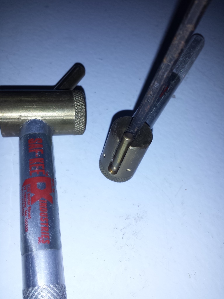

    Quote Originally Posted by Saltfever View Post

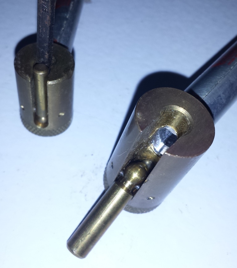

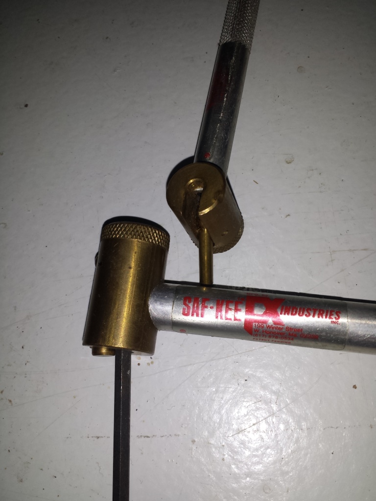

    I wasn't going to post to this thread because after all, we are "homemade" tools. But, per a few posts and Marv's request, here are pics. These were purchased in the mid-80's. I searched for the company but no joy. Either end of the wrench fits into the handle and the spring-loaded, brass, toggle then snaps closed. Two sizes fit almost all my needs.
    Attachment 24636Attachment 24637Attachment 24638
    Great pics. Another project for the project collection. I've been looking for tools like this for a long time. Thanks.

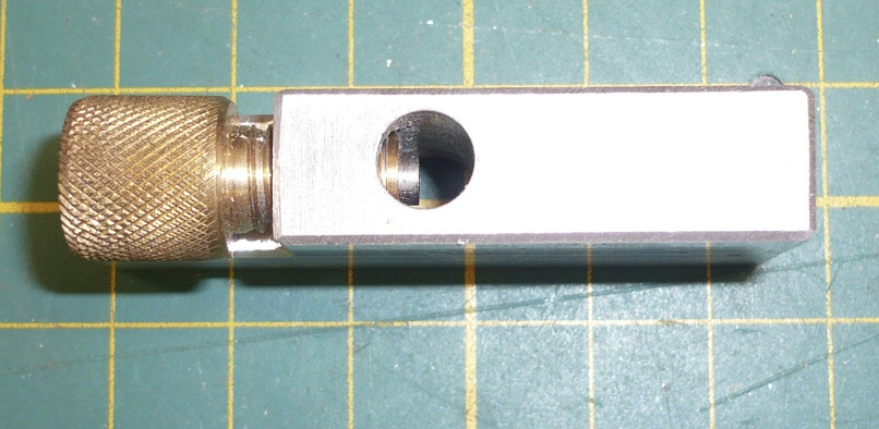

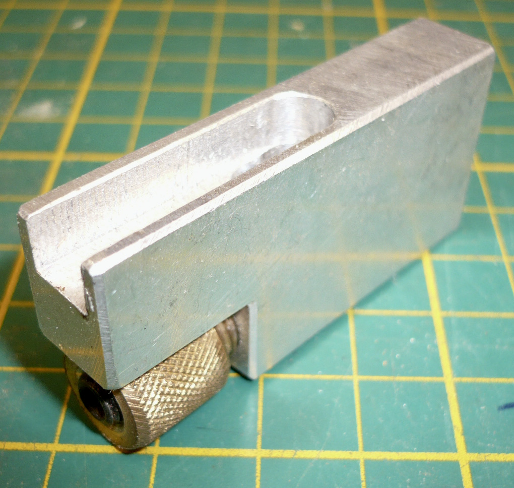

    for me the original design of Marv's tool needs the slot to break out at the end of the handle so the long arm can also fit in the handle, and the short arm used as intended. The handle would then give a shorter handle 180 degrees offset for tight work, and for some size keys add a measure of comfort when turning.

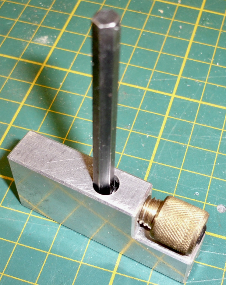

    Quote Originally Posted by desbromilow View Post
    Look carefully at the first picture in my original post. The slot extends to the end of the handle as you wish. The plastic retainer conceals that fact in the other pictures but it's still there.
    That said, I've never had occasion to use the handle in the way you describe. If the job requires that much torque I have several ratchet wrenches that can directly accept a 1/4" hex Allen tip. Much more comfortable than trying to put huge torque on the short end and the ratcheting ensures one can obtain a good wrenching position.
    Regards, Marv

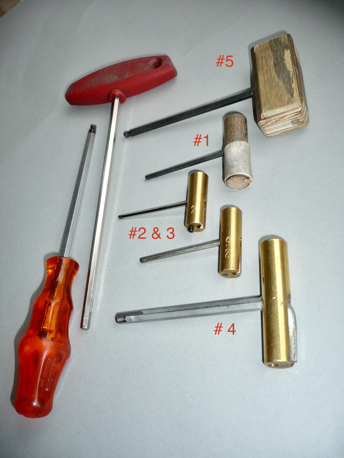

    a propos style: See the genealogy of my T-handles
    T-handle for Allen wrenches-05914ffd-ba00-495d-8e0a-2942d5325a50_1_201_a.jpeg
    #1 was a makeshift for an imperial size (dowel with groove and shrink tubing - too weak)
    #2 & 3 is what I use daily for small key sizes down to 0.9 mm (keys are clamped; each key with its own handle - changing handles is a nuisance)
    #4 epoxy glued handle for an imperial key
    #5 wooden handle glued (quite robust, pleasant feeling, looking not so nice)
    #6 (un-numbered) luxury version:
    ('springy' clamping screw, pleasing to use, almost never used)

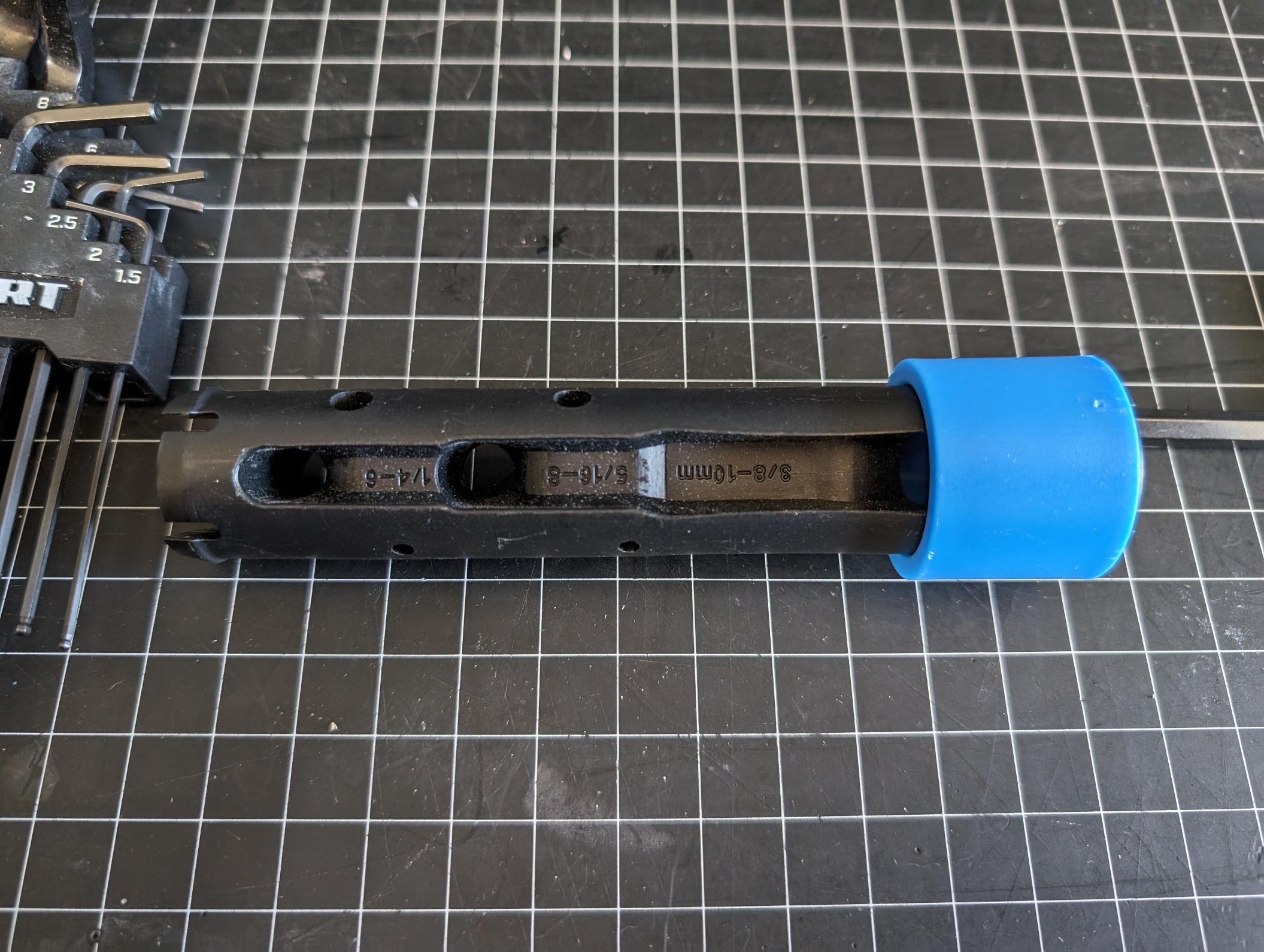

    Here's an example of a commercial unit, I *think* from a wal-mart house brand set.
    Notable features. There are muliple size slots for different wrenches clocked around at 120 degree intervals. Some of these are inconveniently placed i.e. the 6mm one is at the end instead of the center. A better design might be to have the smaller ones in the bottom of the larger ones and let the wrench decide how deep to sit in the holder.
    If I get the time to try to make a 3-d printable version, I'll try to make it square so it's less inclined to roll away, probably try that deep/shallow trick, and add compliant mechanisms (bendy bits) so small wrenches don't flop in the big and hold the slider in the open and closed positions. It's a great idea. 10/10.
