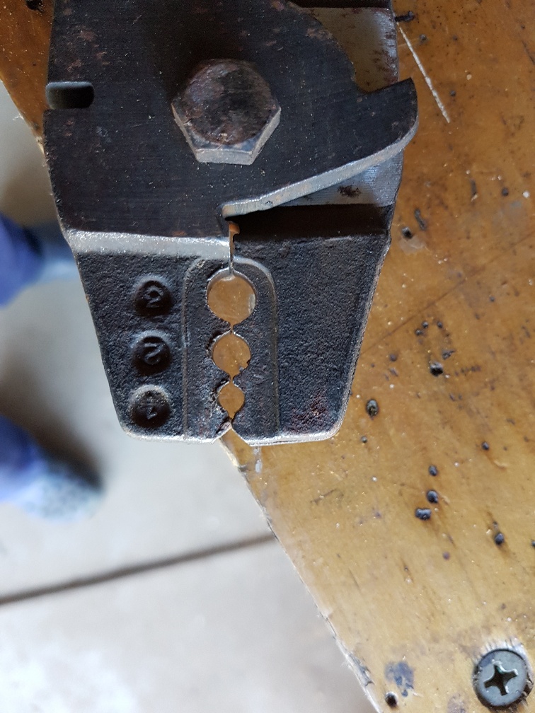

    Swager DIY Tool-20170727_114848_resized.jpgSwager DIY Tool-20170727_114824_resized.jpg
    Hi larryaguir. I have attached pics of my swaging tool which might help. The holes are numbered 1,2 & 3 and are nominally 4,6 & 8 mm diameter respectively. I hope this is of use to you.

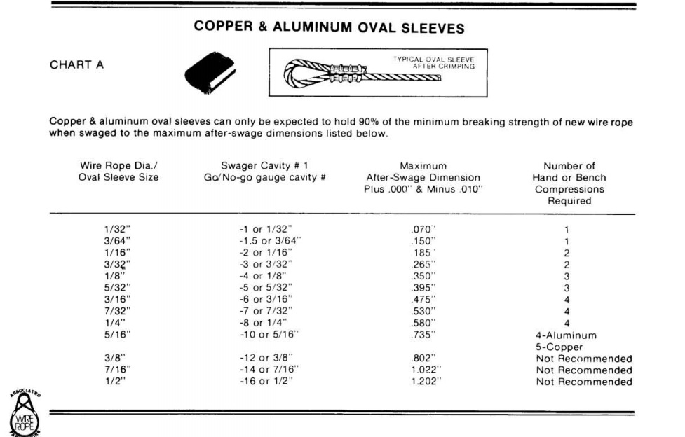

    Thanks for the pictures, Glueman2. I think with your information I can make the tool I need, after looking at the pictures you sent. Frank S also sent me some finished dimensions for the swaged ferrules so I can check my work and see if I made the tool to the right specifications.

    Frank S, thanks for the chart with the finished dimensions for the swaged ends using copper and aluminum ferrules. Glueman2 sent me pics of the tool, and with your chart I can check finished ferrule dimensions and fine tune if needed.
