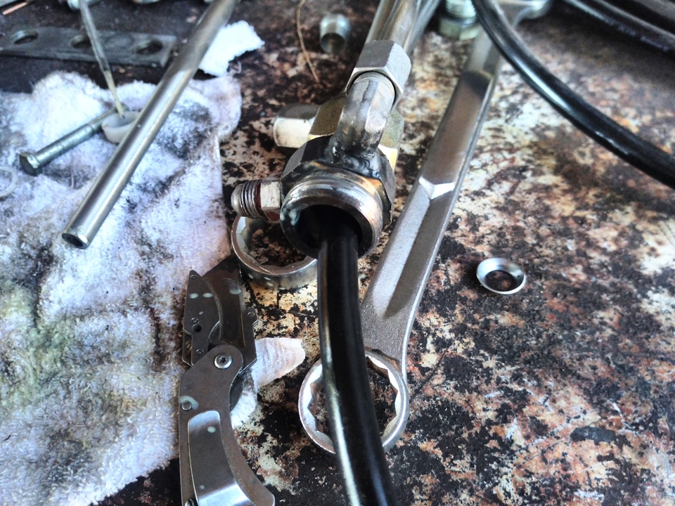

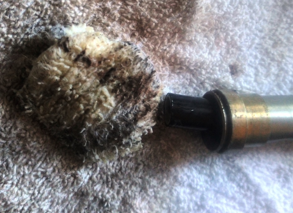

    When it comes to cleaning out a long piece of hydraulic tubing, I find that using a length of smaller diameter air brake tubing by pushing an oiled cotton swab works better than most things as it can be pushed through bends as well as the straight sections and about the only way to insure there are no metal particles left in the line

    I had a contaminated system where some internals had worn leaving very fine particles throughout every line and poppet valve. disassembling washing blowing wiping and, swabbing the bores of all hoses and lines seemed the only way to insure all of the fine particles were removed since there hadn't been a filtration unit on the system
