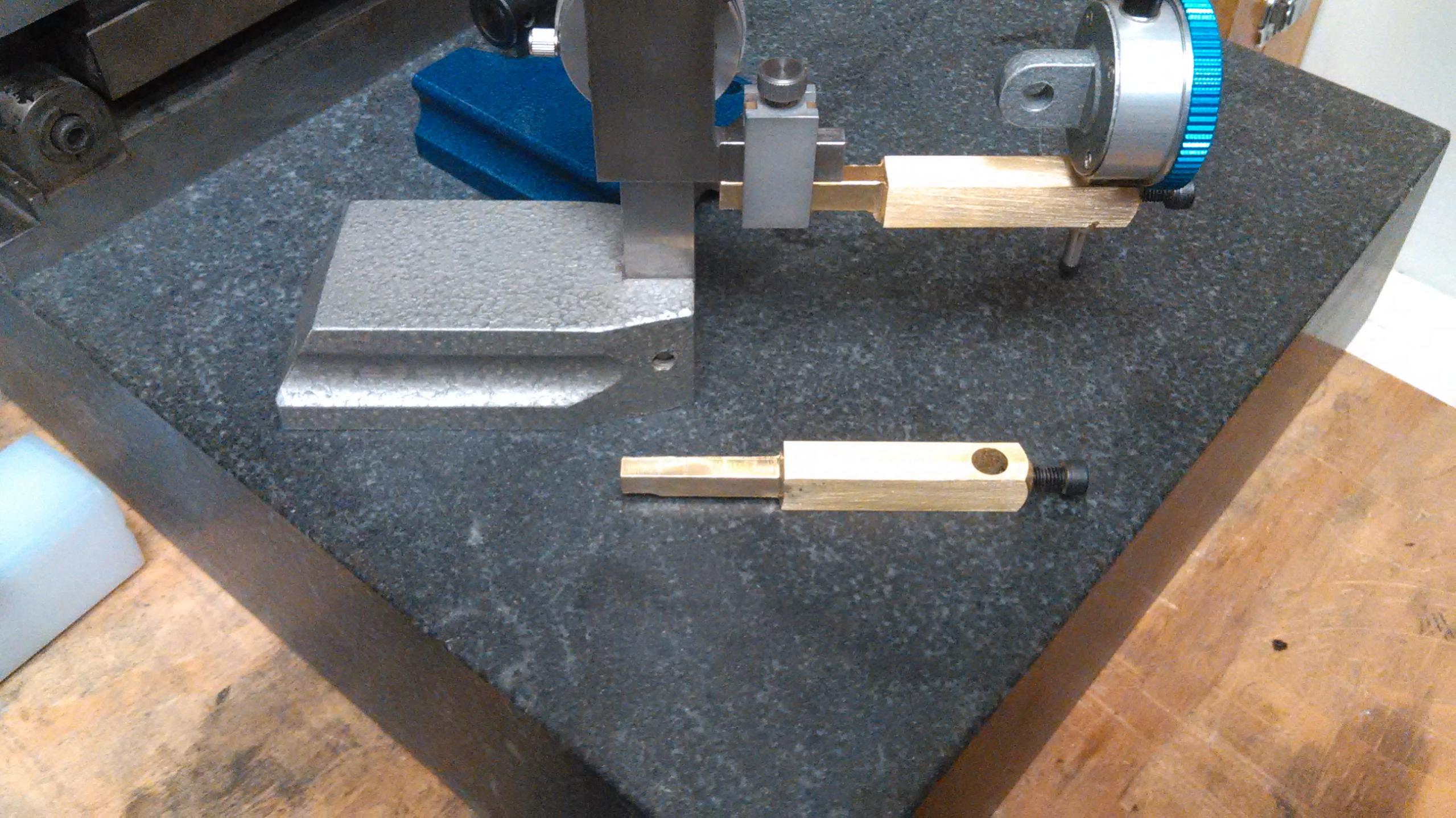

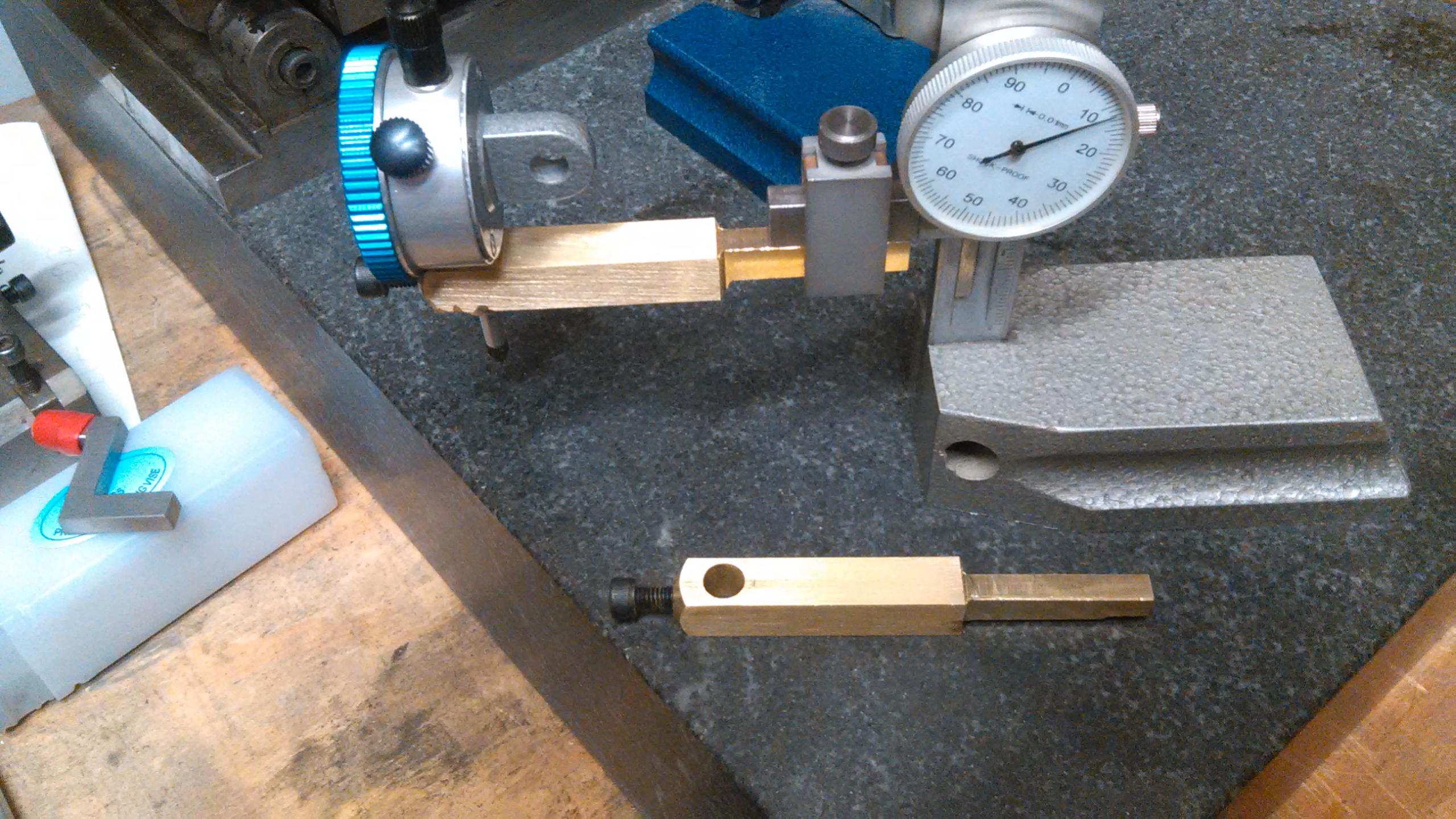

    To make the height gauge hold a dial indicator, I used some 7/16" square brass stock I had. I made one for 3/8" stems, and another for 8mm stem.
    The screw on the end is 10-32. So to finish this, I need to make some brass thumb screws. These fit in place of the carbide tipped scribe.
    I didn't see this posted by anyone, which I was hoping to see for a better design.

    To make the height gauge hold a dial indicator, ........
    I make no claims that mine is better but it is different to yours and I think somewhat quicker to make. It has a bit more flexibility in that you can turn the gauge such that the plunger is horizontal. There are times when that can be useful.
    Surface plate height gauge adapter for dial indicator holding-gauge-height-01.jpg
    Here is the holding piece, some rectangular bar with a single hole and rounded end.
    Surface plate height gauge adapter for dial indicator holding-gauge-height-02.jpg Surface plate height gauge adapter for dial indicator holding-gauge-height-03.jpg
    The assembly.

    Tony:
    Thanks, that exactly what I was hoping for was different ideas on modifications to a surface plate height gage. I didn't think of the lug mount. I've been machining for 40+ years, but only recently have gotten into surface plate usage and measurements. My metrology tools are still limited. I don't have a cylindrical square, or precision compound angle plate yet. I'm thinking at $180 for a 3x6 inch cylindrical, I would attempt to make one on the lathe, and tool post grind the final surface cut. So far the measurement needs were for a tapered sleeve, so a sine plate, Jo blocks, and bench center were the first surface plate "furniture" I purchased.
