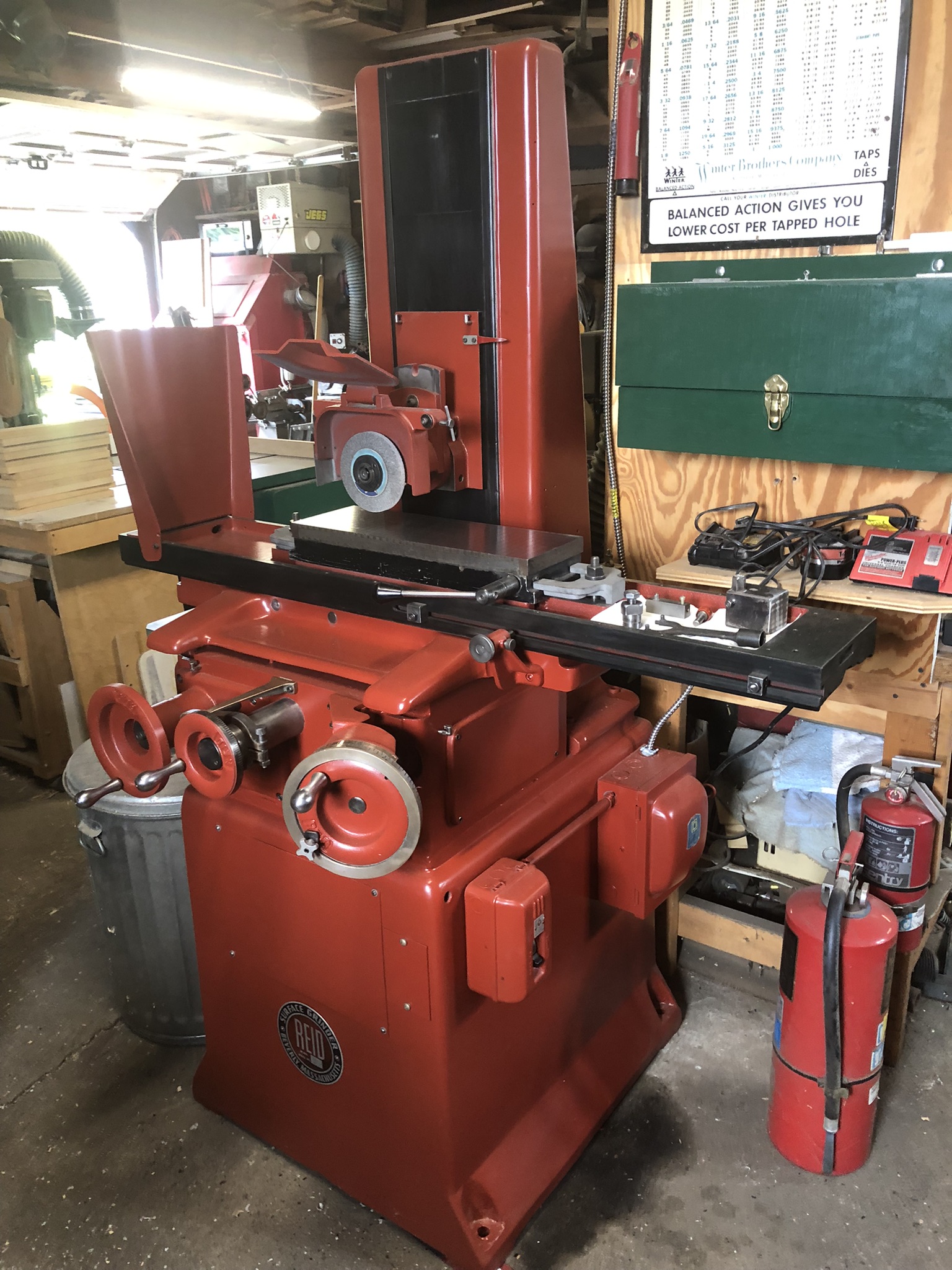

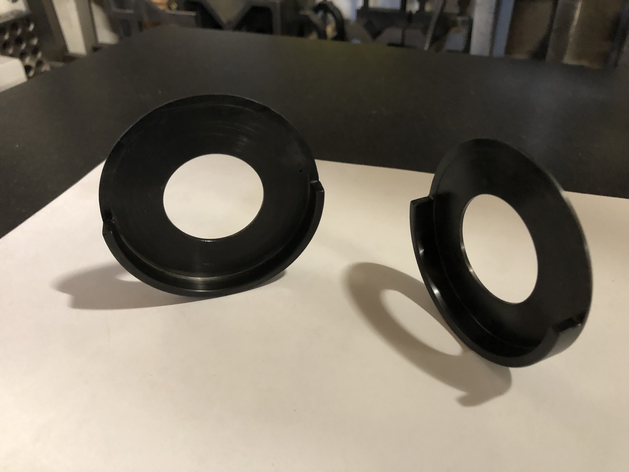

    I recently restored a early fifties vintage Ried grinder and am pleased at it’s performance. I purchased two wheel adapters and wheels. The well used wheels that came with it were fine but the new 7 inch diameter wheels caused some vibration. Not wanting to spend $300+ on balance adapters I found making these counterbalances worked very well.Surface grinder wheel counterbalance t-ab4ec984-73fe-4a66-8771-3ec94311fe03.jpeg
    Surface grinder wheel counterbalance t-3a253aaa-4e48-40c0-8027-265acbd6c509.jpeg
    Making two cups, one nesting in the other with one half of the flange removed on each.

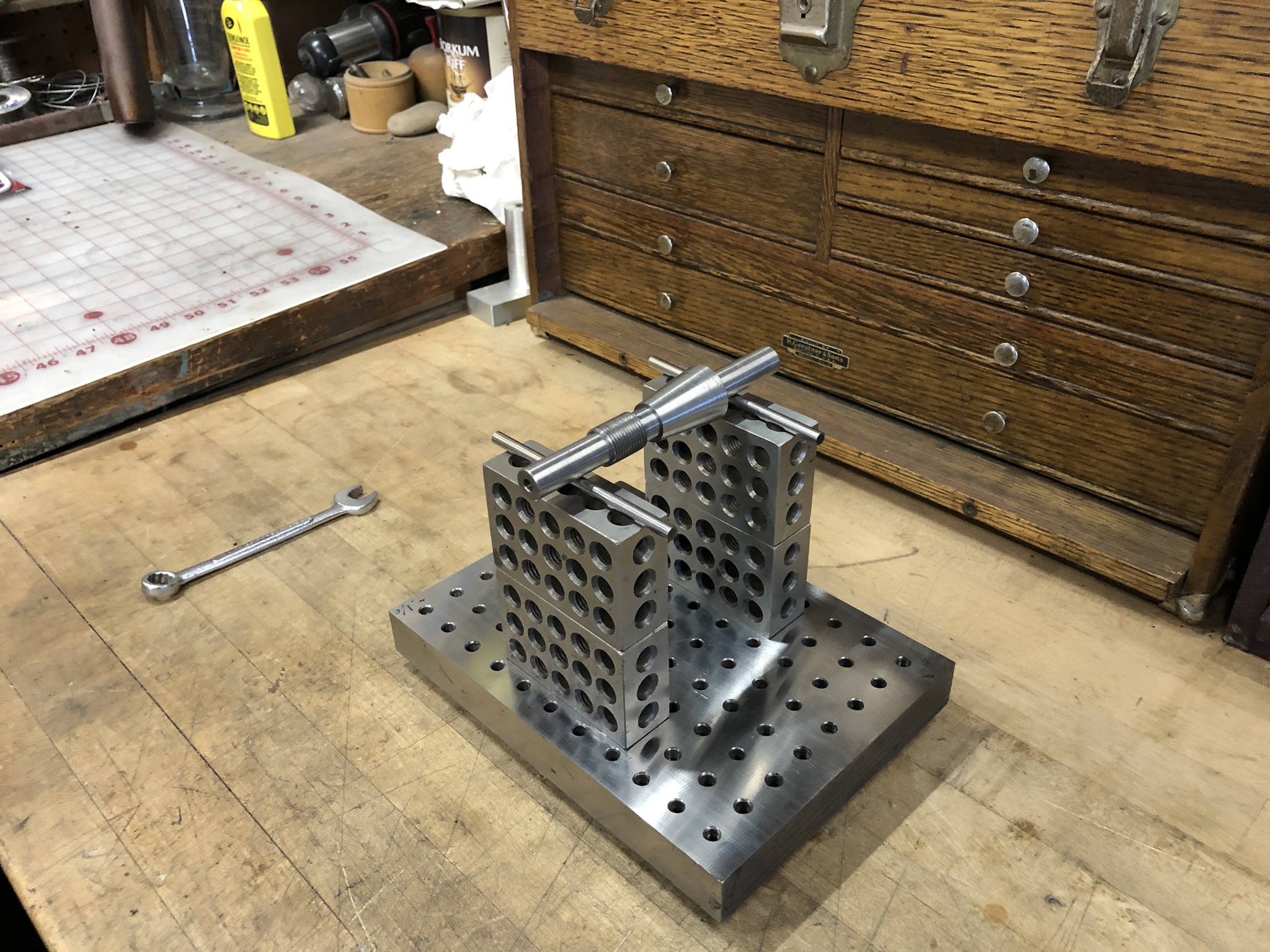

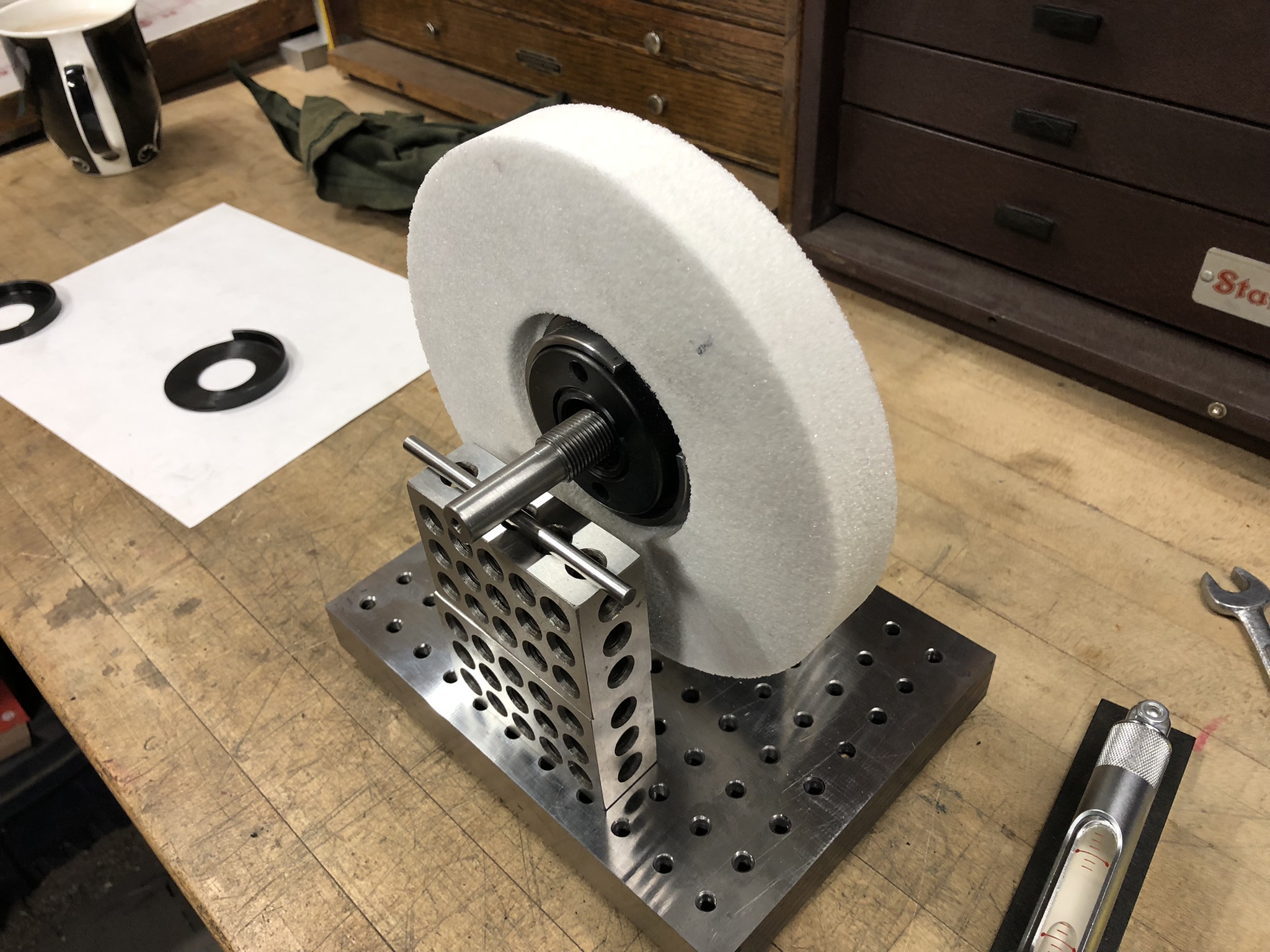

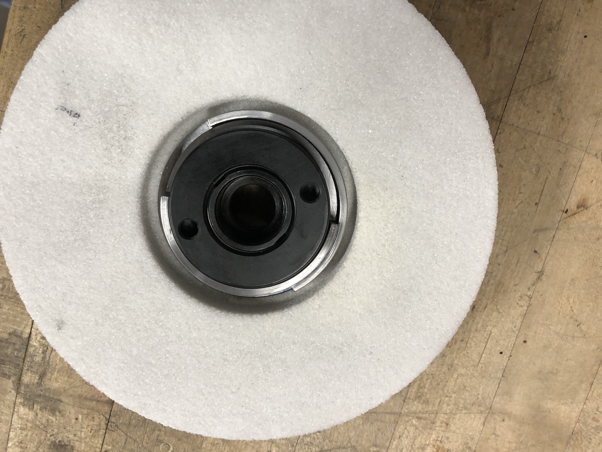

    On the balance fixtureSurface grinder wheel counterbalance t-d4f795da-4406-4cad-a8e5-8decb428c8fd.jpegSurface grinder wheel counterbalance t-5b0c5aa2-ada4-4740-8889-d202f1df3863.jpeg

    Hi, I use small diameter drill rod on the blocks to further reduce rolling friction. I believe this method has less friction because it eliminates(almost) bearing friction. It is very sensitive so getting it perfect takes patience.

    I'm trying to understand how you fabricated these washers with the weight lobe. From the photo I quoted, it appears the radius of the masses are different. How do you keep this in static balance if their centers are exactly 180 degrees apart. Would not the smaller radius require extra thickness of material to stay balanced?
    Clearly it's working for you, but I'm missing something in the implementation.
    I do like that you used round bar for the rails, that seems to be so easy to chop off a piece from drill rod, which I stock in smaller sizes.

    I carefully calculated the difference in masses and sized the flanges accordingly. I made a 3D model in Fusion 360 and found that the cg was almost perfectly on center radially. It was off .002-.003. Off coarse machining tolerance weighs in but I just balanced a 7x1 recessed wheel that was way out of balance and it runs fine.
    I found that if I put the wheel on the balance fixture without the weights and mark the heavy point then add the weights perpendicular to that cl it is easier to rotate the weight mass away from the heavy side.
