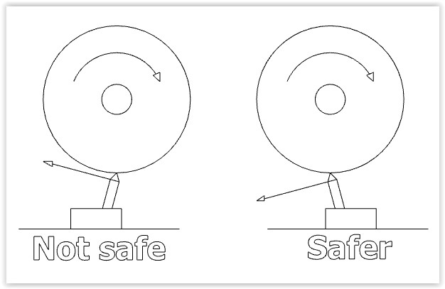

    Your instructional videos are very useful and not only for novices. Your latest one on surface grinding prompted me to make one observation on wheel dressing, I have seen many posts showing the diamond presented to the wheel in that orientation which to me is not desirable. I have always taught new employees that the diamond should trail the wheel and not point into the direction of rotation for safety reasons.
    Any misjudgment on power down feed can result in a dig in and a burst wheel as the diamond lifts into the wheel, I have seen this happen.
    Hoping you view this as constructive comment, let me know what you think.
    Regards
    Olderdan.

    I am glad that you enjoyed the video
    Thank you for taking the time to comment
    By taking the time you are helping me and my students
    I am going to try to edit the video to include this
    If I can I will re-post the video

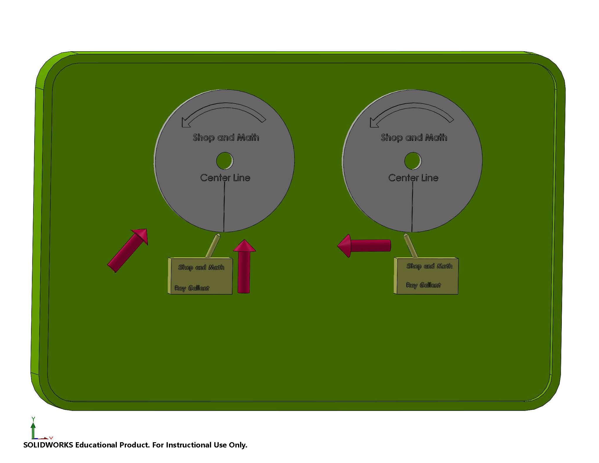

    going to try to edit this into the video

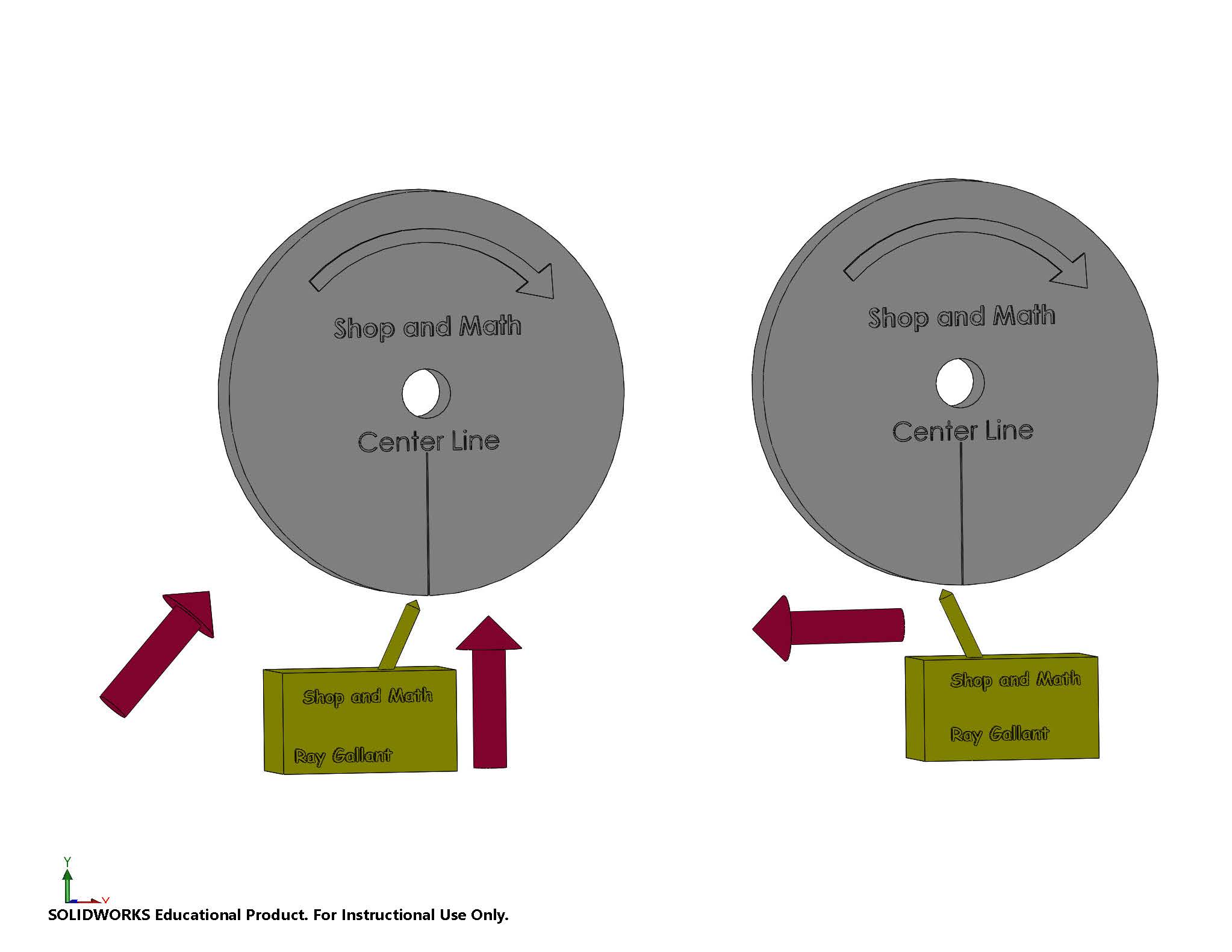

    Correction the grinding wheel direction was wrong
    A student was nice enough to point that out to me
