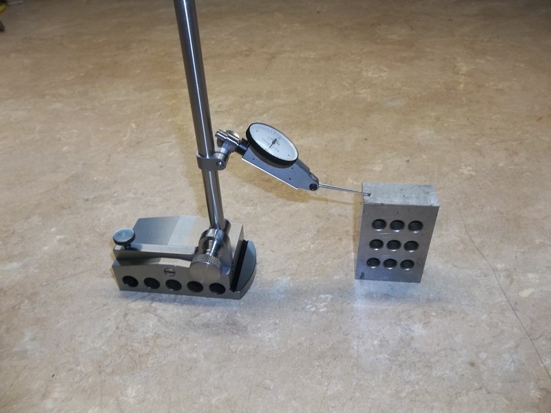

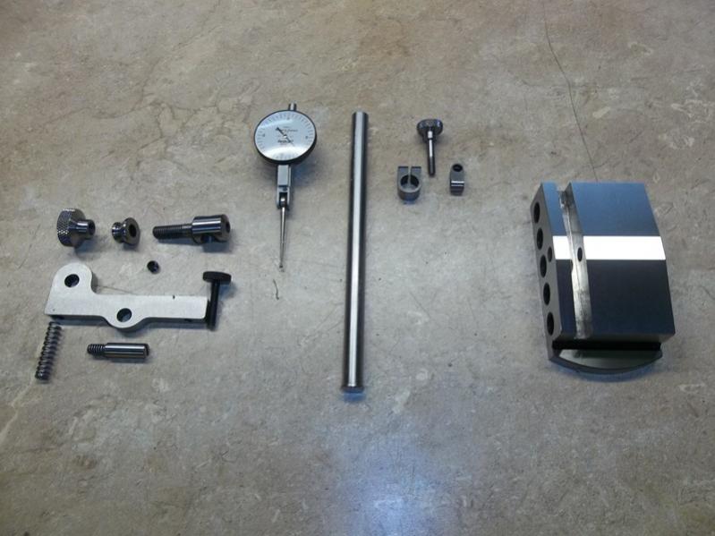

    I built this gage to use as a primary height and square gage, not as a surface gage, I have dedicated surface gages but I wanted to have a dedicated gage just for checking square and height.
    There is a radius machined on the front of the base just for checking square, some people machine a slot in an old surface gage, Install a piece of steel in that slot then hand grind a radius on the piece. I chose to incorporate that as part of the tool.
    The spring under the pivoting arm was made from a piece of .055" music wire wound on the lathe at 12 coils per inch. The only thing I didn't make was a 1/4-20 set screw which secures the 7" stem to the pivoting arm.
    The entire gage was made from O-1 tool steel, except for the 7" long stem which was made from 316 stainless steel. All parts that were flat was hardened and ground, all parts that were round was hardened and polished.
    Below are some photos
    Thanks for looking and happy machining
    Doug
    Photo before assembly
    Using it for checking square
    Another view of checking square
    Using it as a height comparator
    Another view of height comparator

    Very nicely made and with great photos. This type of surface gage has been on my "to do" list for sometime now but didn't want to tackle grinding a thin slot. Now I see your alternative and I like the design. Thank you.

    Yes, congratulation Ross for your tool of the week selection, as Paul above, your gage is really nicely made, and I like the solution of the post than can tilt with micro-adjustment.

    can you take a regular surface gage and put it on a rotary table and put a radius on on it, and what radius did you use?

    I don't see why you can't, the radius I used was 1/2 the width of the surface gage
