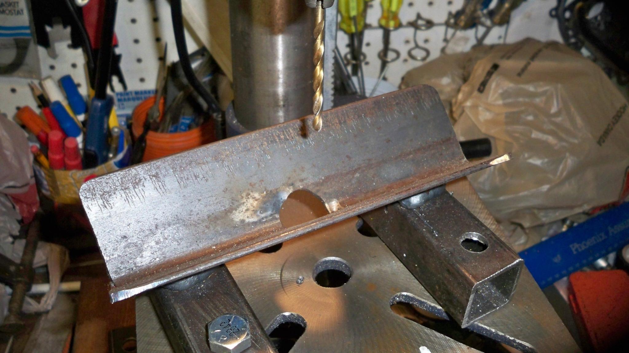

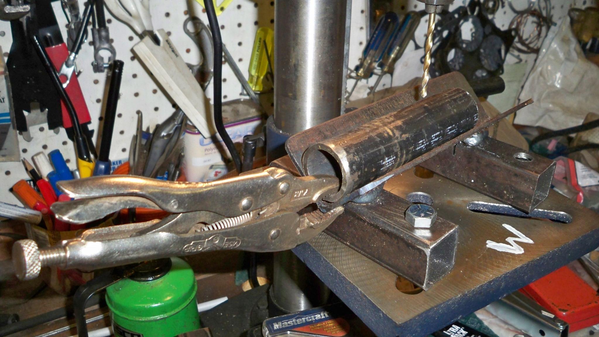

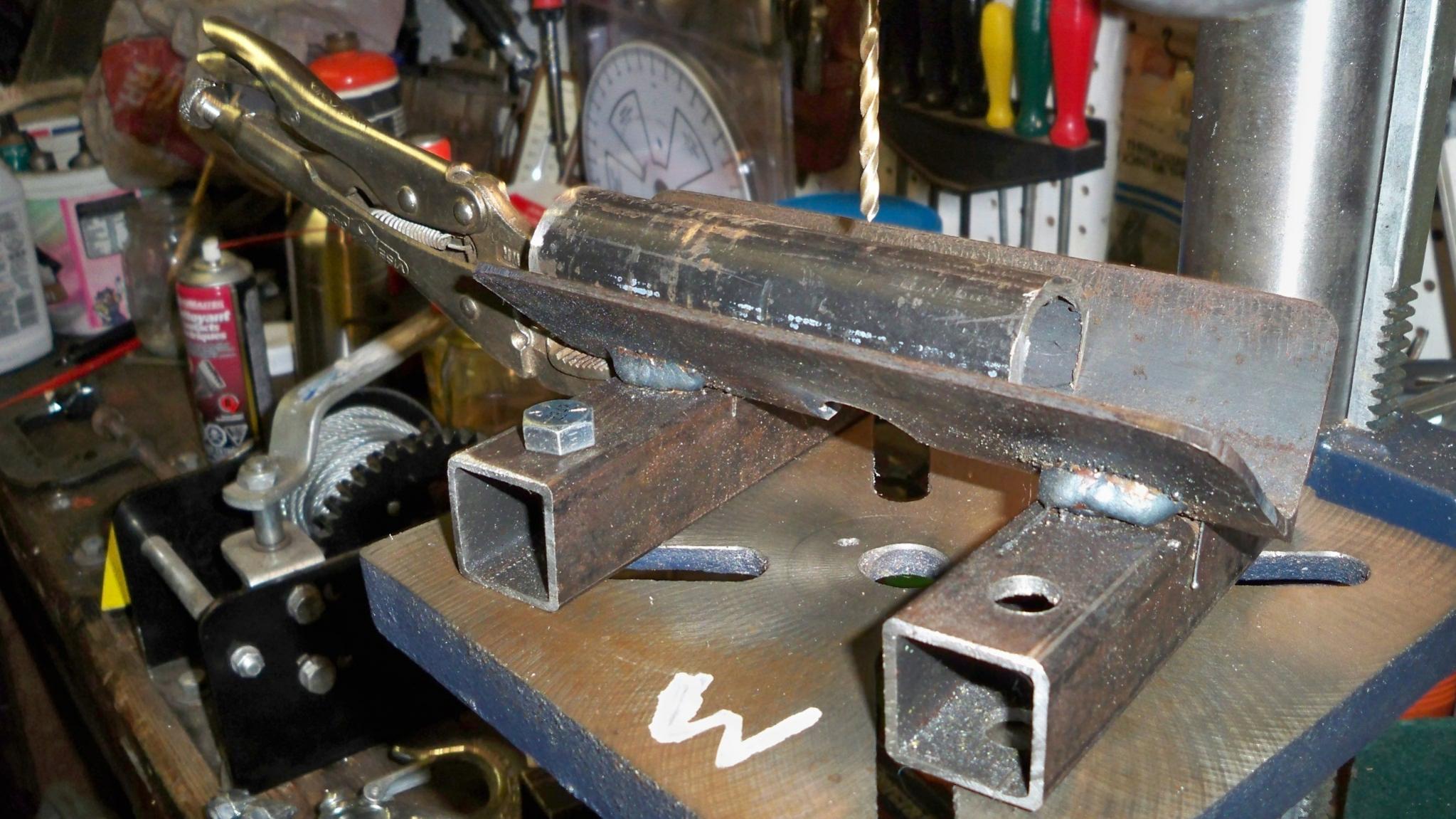

    Support for drilling round stock and pipe
    Support for drilling round stock and pipe-100_3923.jpgSupport for drilling round stock and pipe-100_3921.jpgSupport for drilling round stock and pipe-100_3922.jpg

    Simple, no frills, and effective!
