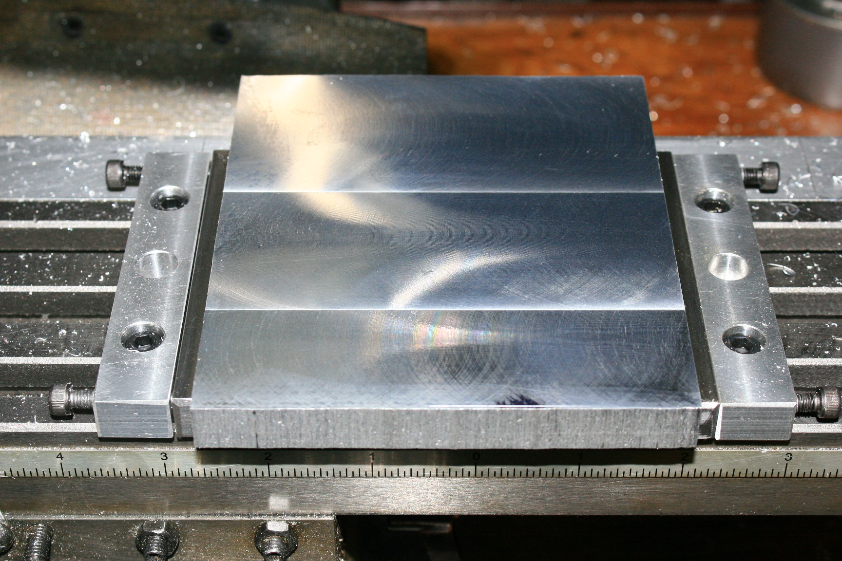

    When plates won't fit in the vise I like to use this simple 3 part "milling vise".
    There are about a million types that have been shown but I think this one is quick and easy to make.
    To prevent drilling or milling into the mill table just place the part to be milled on some 1/8" thick aluminum spacers.
    I did not need that for this operation since I was just surfacing the plates.
    Cheers, JR

    Thanks Jon, Seems like for almost every project I need to make something new for cutting, holding, or aligning.
    That is what makes machining so much fun. I think I like to make the tools the best!

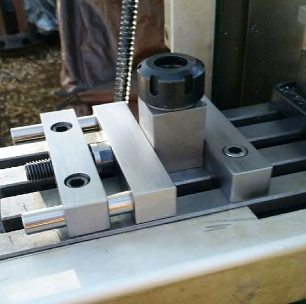

    Congrats on the win. Those can be really handy for holding some odd things and a lot quicker than than using a clamping kit. I made one too some time ago but it wasn't even added to my builder page so no recognition.

    An added benefit...
    Mount one half of the vise near one end of the table and tram it perpendicular to the table x motion. Leave it in place and you have a handy reference surface for locating workpieces - either those clamped in your vise or those clamped with a clamping kit.
    I undercut the bottom edge on mine so errant chips wouldn't disturb the orthogonality. Also added a threaded hole in the middle of the bar so that a clamp screw could be placed there to use in holding workpieces tight to the reference bar.

    Thanks Crusty, your design is nice and heavy for holding larger pieces. What I like best with these simple table vises is the gain in
    Z-axis travel over a machinist or kurt style vise.

    Thanks Marv, tramming in is a good time saver and I like the idea of the under cut. Adding another clamp screw is good too. In my version I would need to
    add 2 more clamp screws to each side since I already have a vertical hole that can be used for clamping the "jaw" to the T-slots in the table.

    It holds smaller stuff too - I just don't tighten it as much. Something I still intend to do to it is mill a couple of small ledges into the jaws so that I can hold plate material without resorting to parallels for support. I have the same lack of headroom on my mill and the added 1½" is appreciated because my fixturing and clamping sometimes gets out there on the edge of possible.
