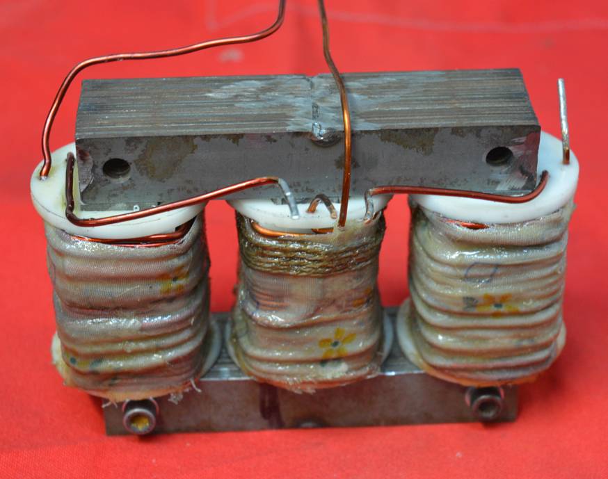

    Stuff about VFDs and motors
    There has been interest in this topic recently, see http://www.homemadetools.net/forum/v...versions-73864
    The content of this current post is contained in a PDF located at VFD stuff

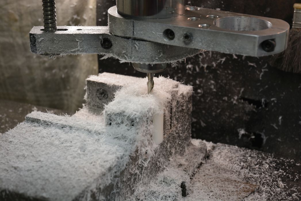

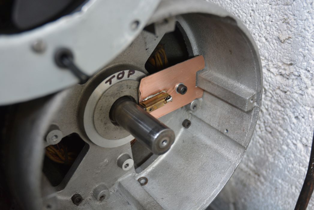

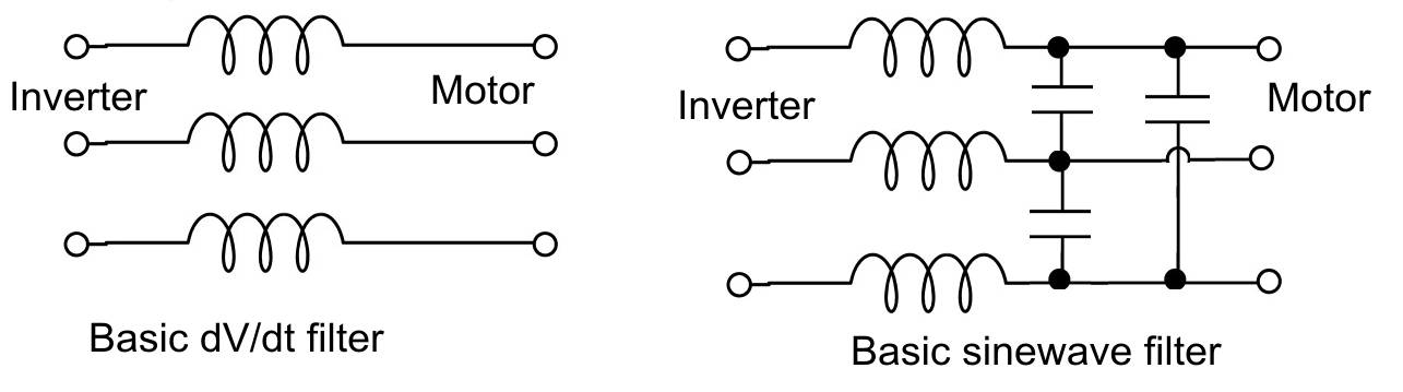

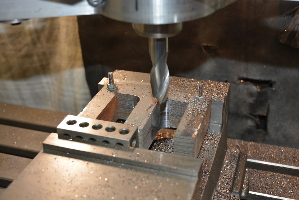

    Here are some pix as a trailer.
    Stuff about VFDs and motors-dv-dt_filter130.jpg Stuff about VFDs and motors-dv-dt_filter117.jpg click image for full size
    Stuff about VFDs and motors-dv-dt_filter110.jpg Stuff about VFDs and motors-rotorearth005.jpg

    -Good grief, Tony!
    A diy-ed 3P yoke LC filter! Excellent approach.
    Nice, straight-forward write-up very much appreciated at this receiving end!
    Did you mention the cap values - I was a bit eager in reading it...
    Is the transformer whine from inter-layer movement in the core laminations?
    You could perhaps dunk the whole shebang in varnish?
    Keep up the good work, and I'll be somewhat more patient in the future!
    Tip: For designing filters, there's a bunch of RF designs that could be applicable even at these freqs:
    Search "Butterworth LC filter design" or peek at this random find:
    https://rf-tools.com/lc-filter/
    ATB
    Johan

    Quote Originally Posted by DIYSwede View Post
    -Good grief, Tony!
    You need to read a bit slower to get your answer.
    Johan.
    I did dunk the core in varnish and that had no noticeable effect so it is probably mostly magnetostriction and there is not a lot that I can do about that. It really is not a problem, once it was mounted in a box on the wall I could not hear it.
