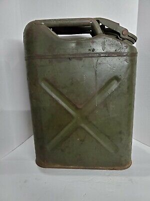

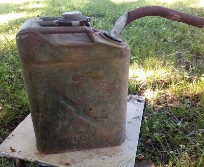

    The US had 2 versions. The blitz can for fuels which as he reported had the 2" pipe thread fill opening and a pour spout that had an expandable rubber seal.

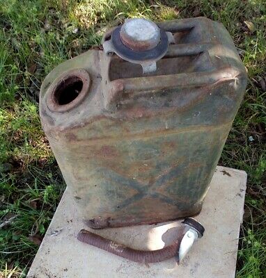

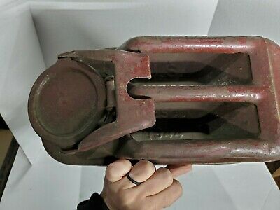

    The second can was for potable water only with a flip top lid
    There were several reasons why the differences in design, not the least of which was to prevent any confusion of either can's intended use.
    The much larger opening on the water can allowed for faster refilling from the water buffalo which usually had a 2" gravity pour pipe outlet. Other reasons was the rapid emptying of the can no internal vent tube was required on either can, on the Blitz can there was a simple 1/8" dia. hole drilled through the flange, sealed off by the rubbed gasket in the screw in lid the hole was left exposed when the flexible spout was inserted
