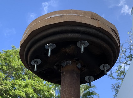

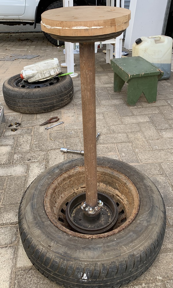

    So off came one of the rear stub axles. A 5 mm plate to suit was fabricated and a piece of heavy gauge pipe was cut to length. The stub axle was reassembled keeping all its seals and bearings in place and bolted to the rim in the normal fashion. I made the stool a little taller than the original as the natural tendency is to rest your feet in the tyre. The backing plate of the drum brake made the perfect backing support for the sitting part and 2 pieces of MDF cut very roughly to side was secured with a few 5mm screws. Once everything as assembled a quick dressing of the flap wheel made it perfect for sitting on.
    Stool from stub axle-stool-1.jpg Stool from stub axle-stool-2.jpg Showing the use of the drum backing plate.

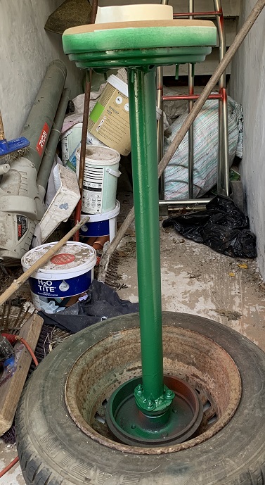

    And then with a lick of green paint as that is all I have standing doing nothing.
    The nice thing about it being able to rotate is that my machine shop is only about 1.5 meters wide, with the lathe.milling machine on the one side and all the drills and measuring goodies behind me. Now it is a simple "twist" and I can reach everything.
