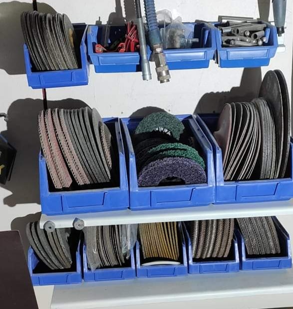

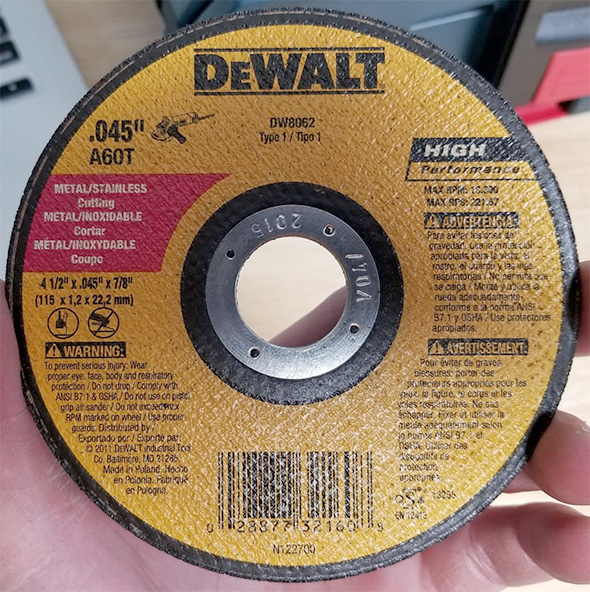

    Moisture ruins grinding wheels sometimes really fast.
    Its somewhat usual that one doesn't know, that angle grinder wheels have expiration date.
    Its stamped to that steel ring on the center of the wheel.
    That's why i store my wheels sideways.
    I take from the right, and but new ones to the left.
    That way oldest ones are used first, before " best before " expires.
